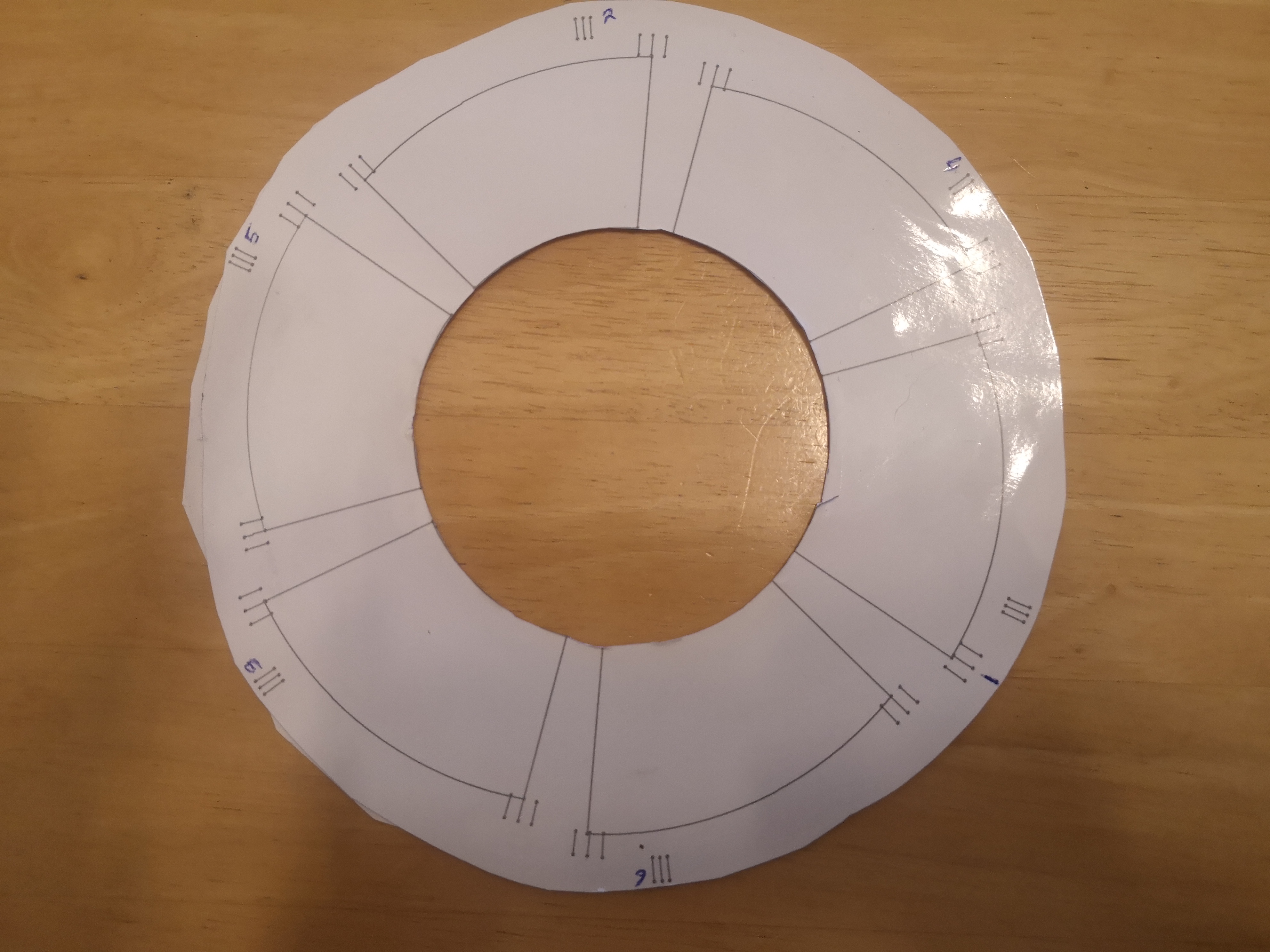

Reinstalling the points I aligned the dissie by again using the meter to detect the points opening when the drive pulley was at the advance timing mark.

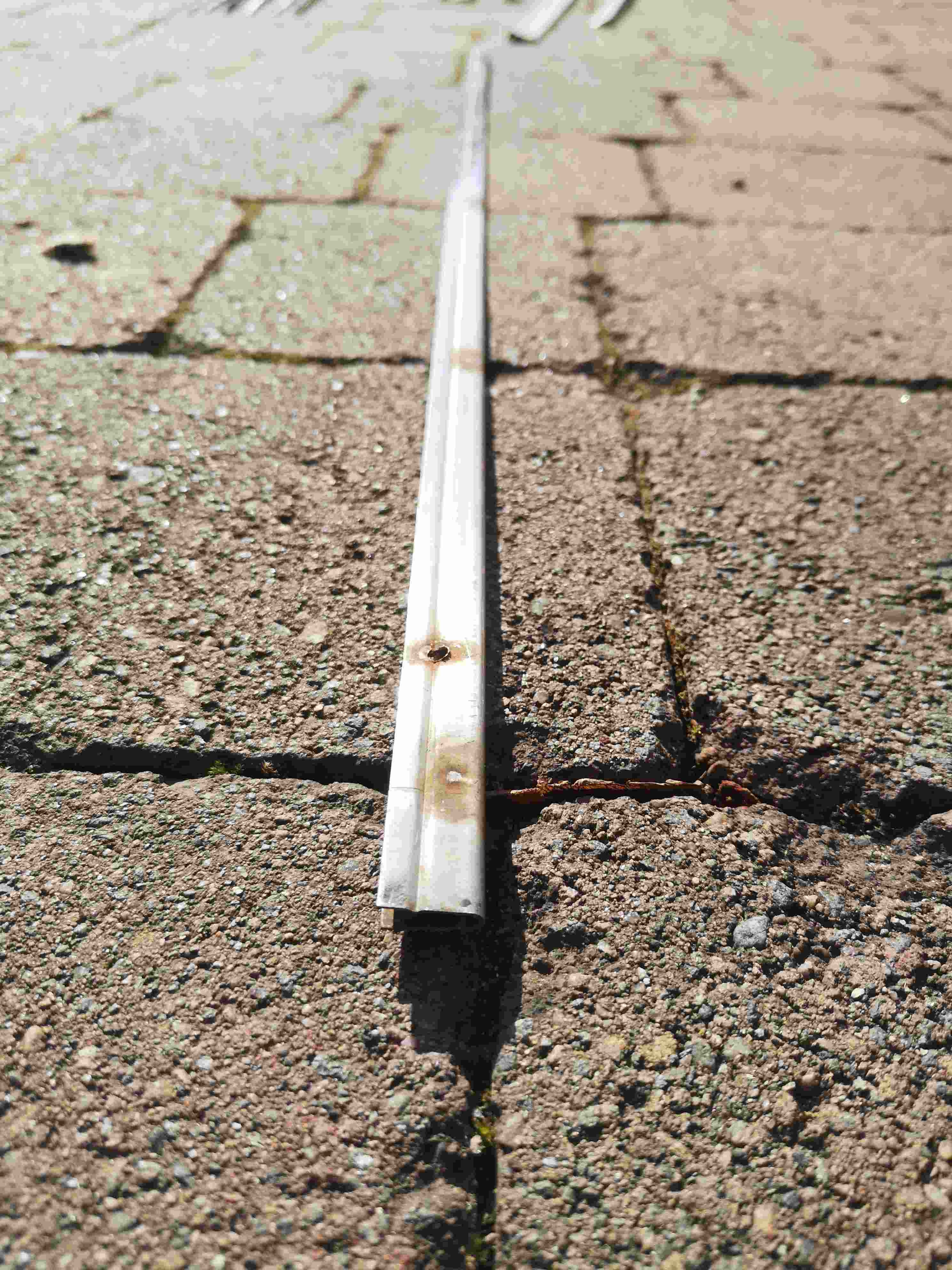

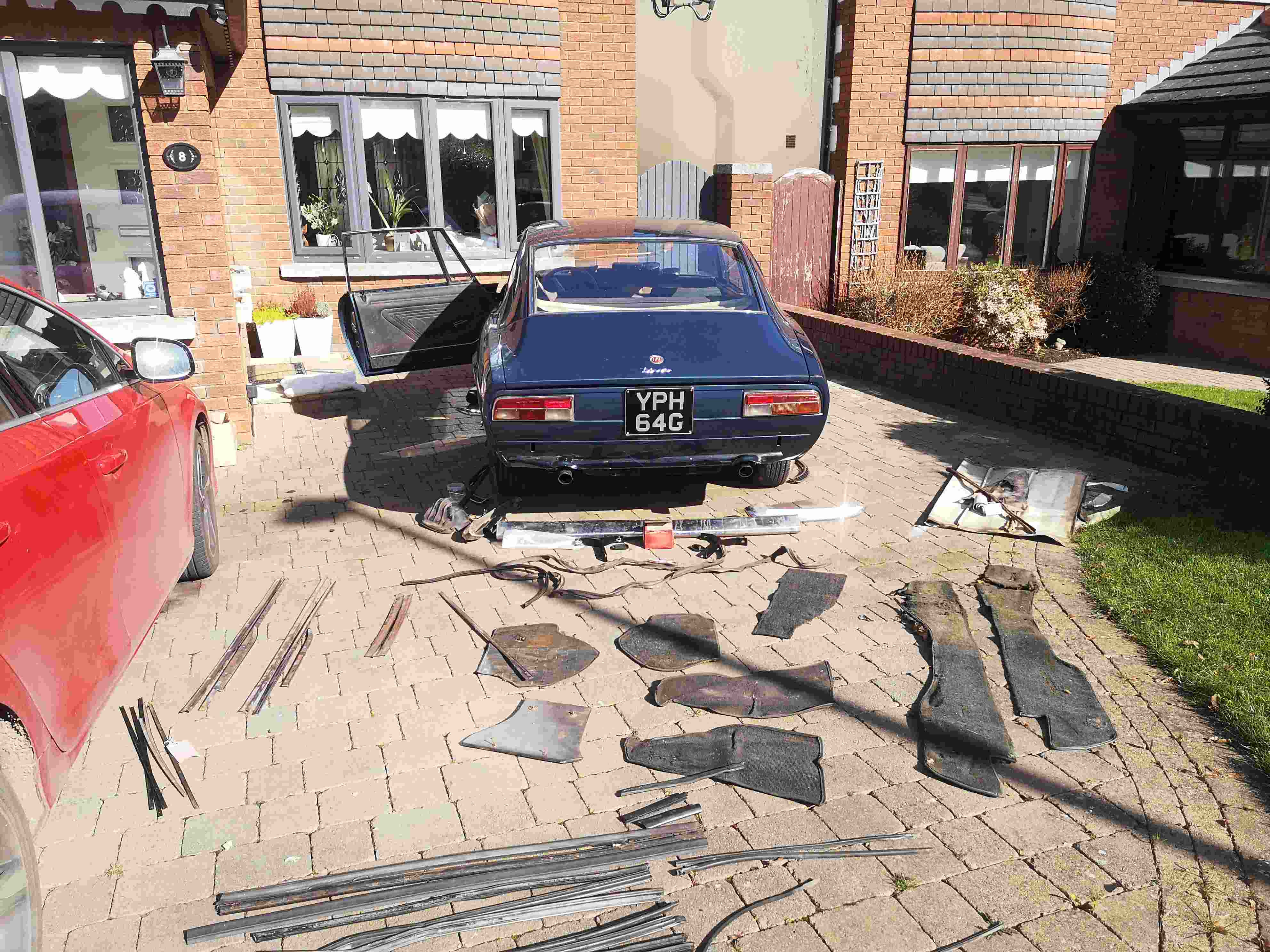

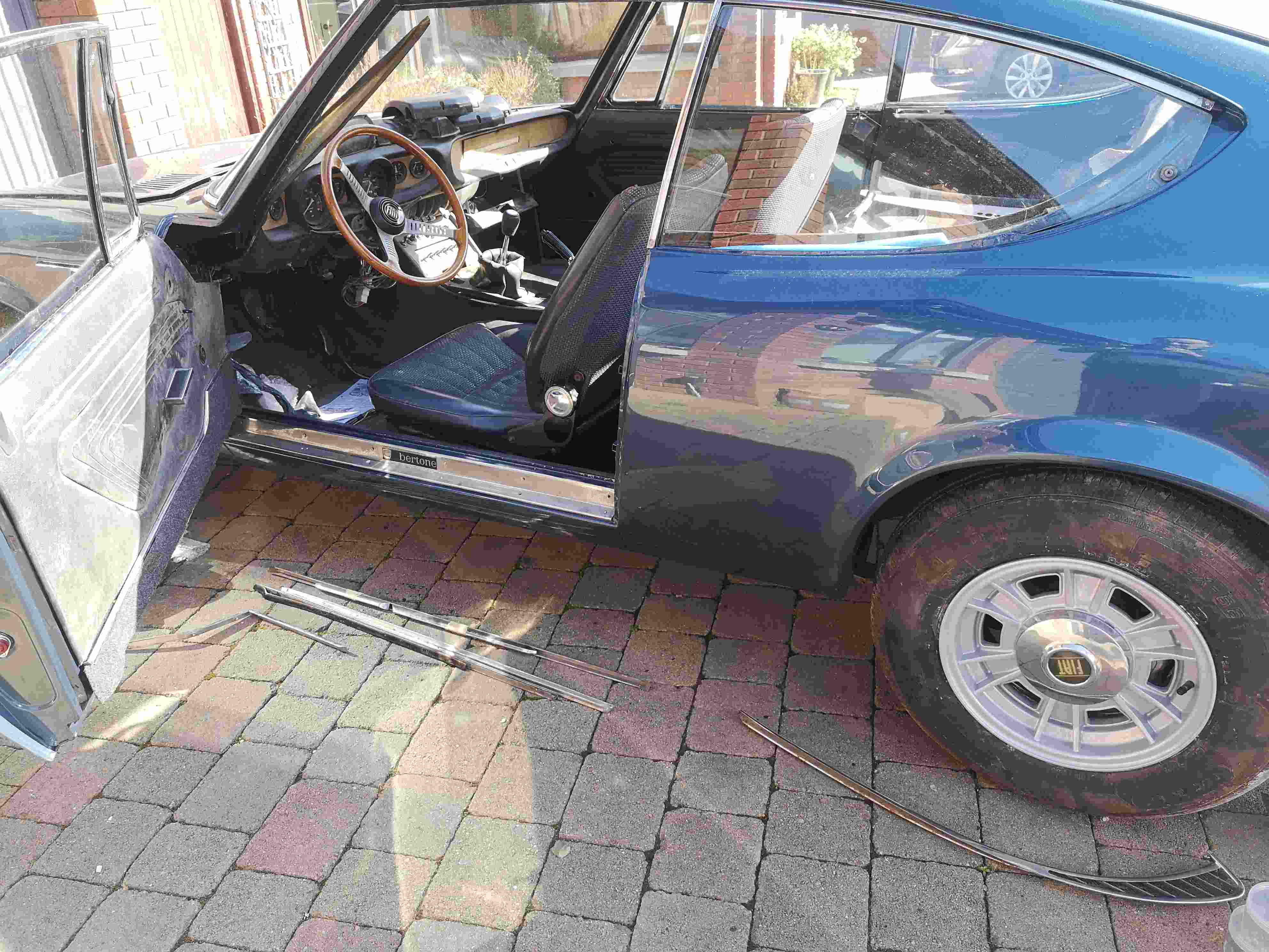

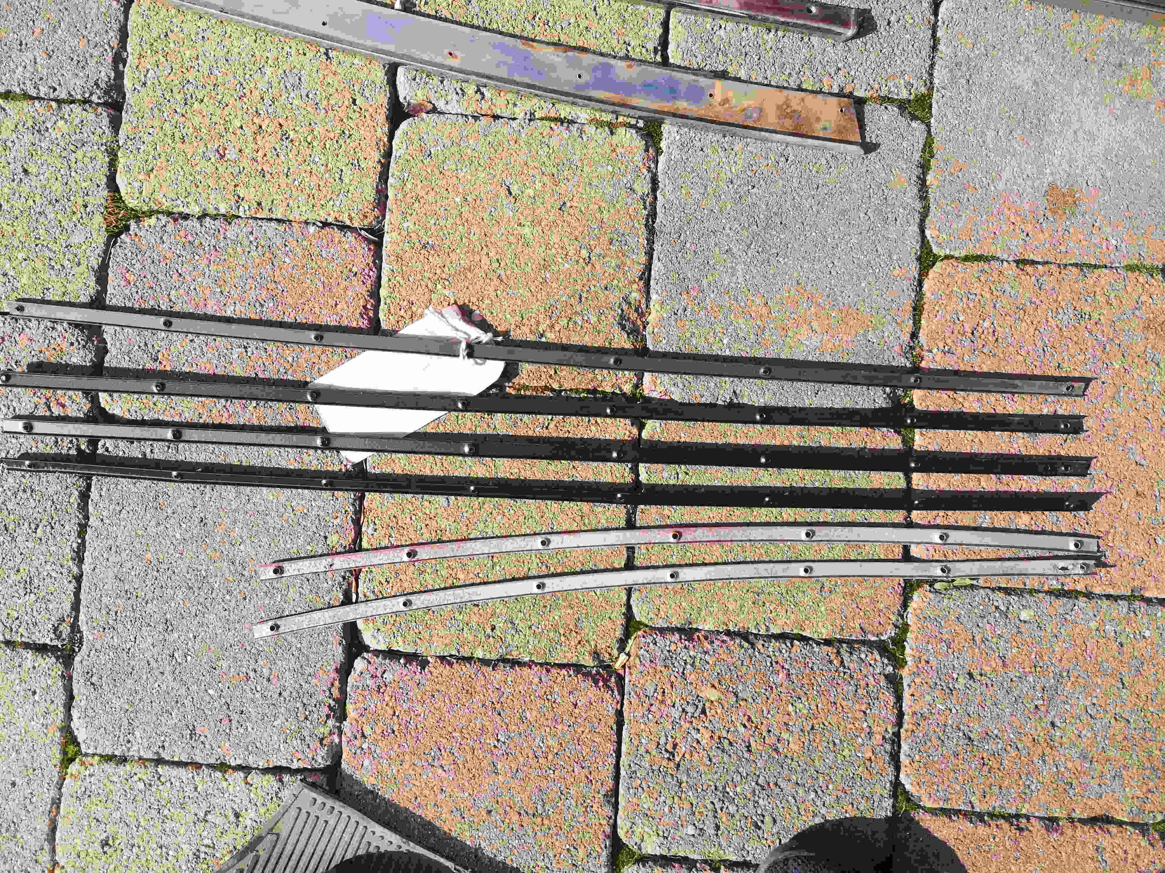

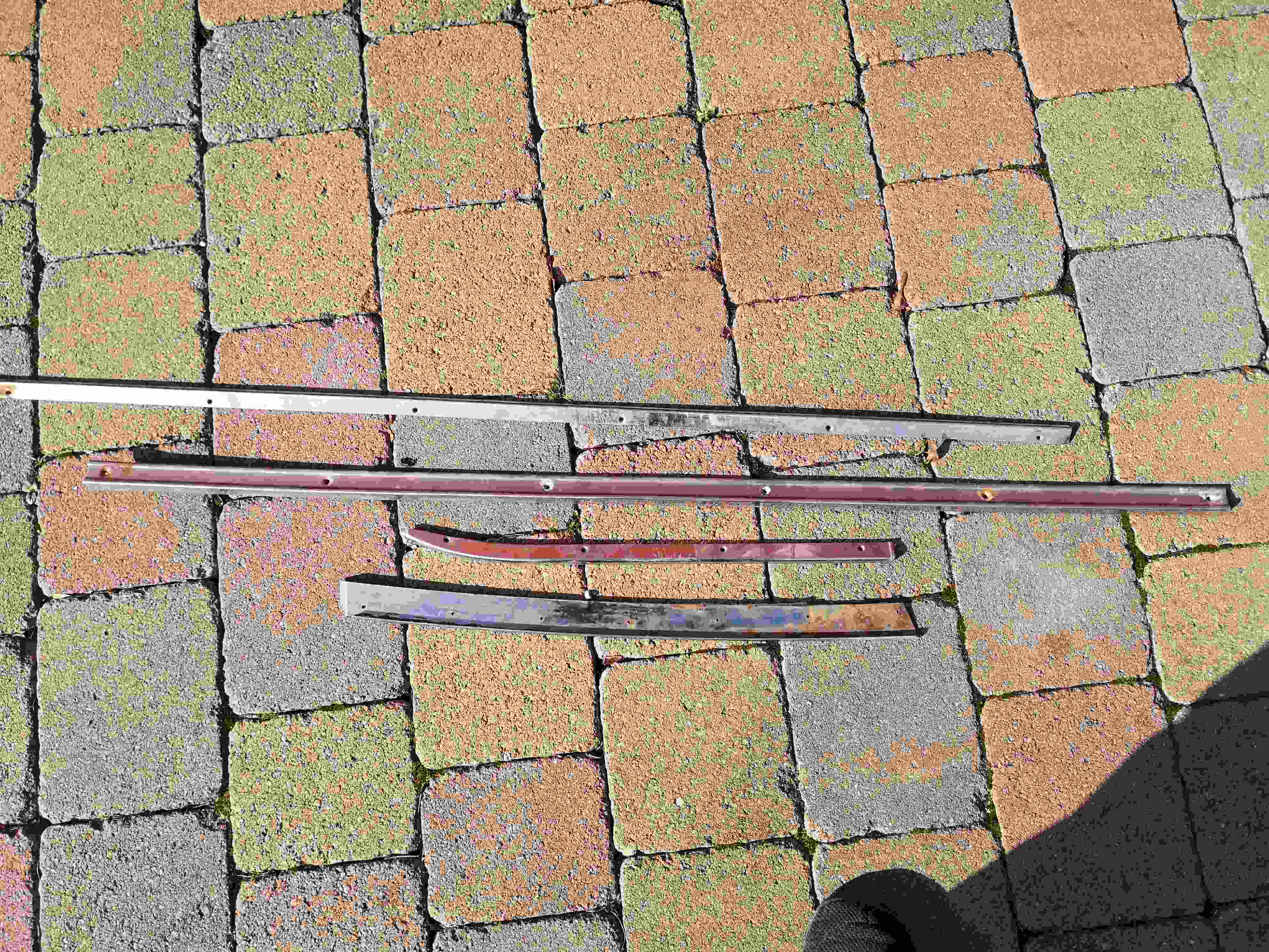

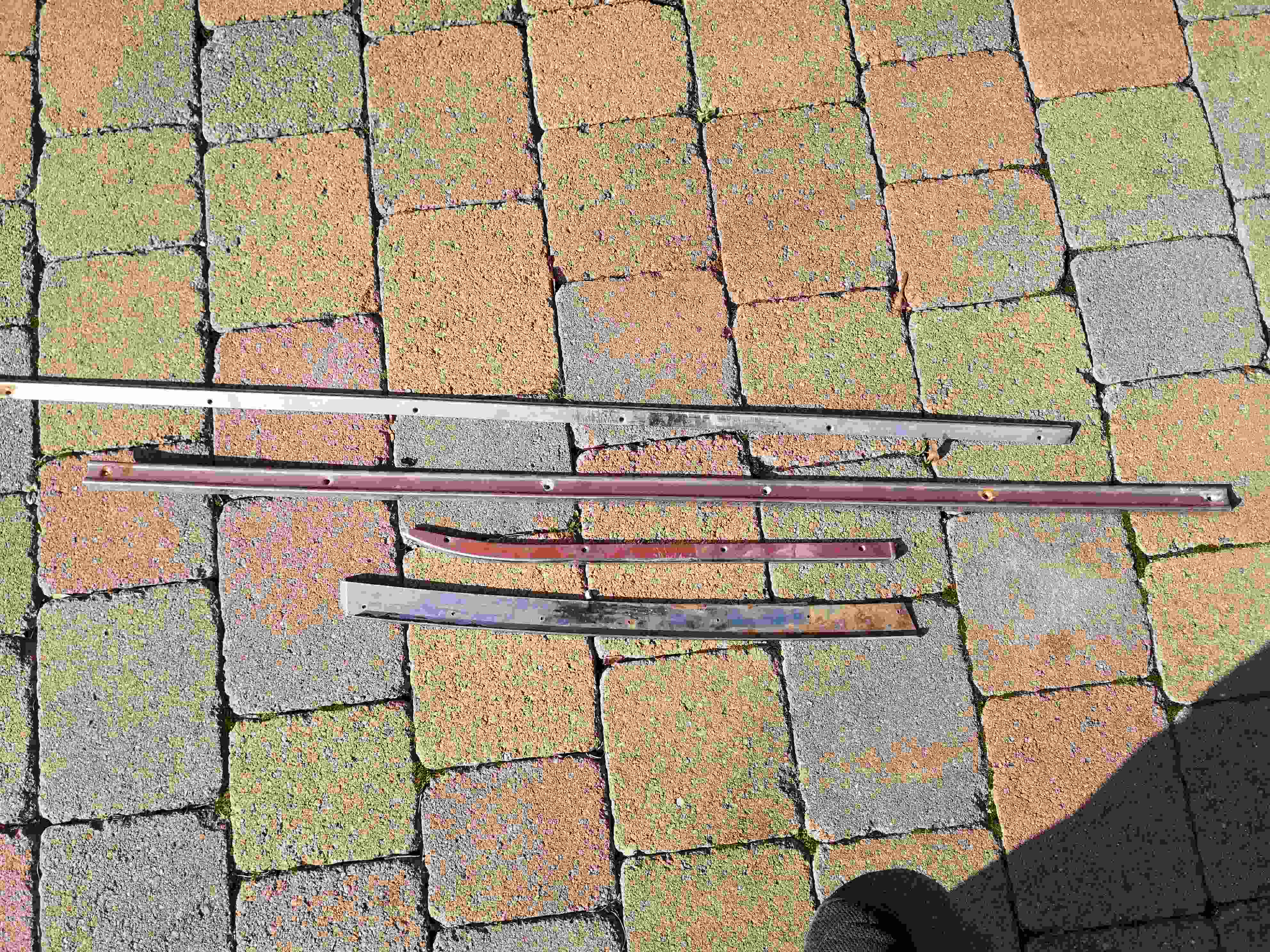

I know that I'm asking all the questions still but hopefully as I get to grips with my Dino I'll be able to reduce my guilt and start answering questions. So while my coupe is apart I am inviting anyone to ask me questions that can be better answered on a shell and not a completely assembled car. Finally got to get the boxes that Mark included unpacked as first nice day this year.
The rubbers I've no idea but I bought door aperture rubbers from Cincognani as Mark said they were only thing needed so I should be able to work out rubbers
I can't understand which is the ss trim around the door card apart from the bent one at the front of the doors. Can somebody point out which goes at bottom of door card and back edge of door card please?
Also I assume the single stainless edge piece is not side related as there is only one but not sure what this is either?
And finally I have 6 strips that resemble the strips on my old 105 for attaching the door rubbers but no idea where these go? Is 3 each side correct?

It looks like I have all the stainless steel but the stainless steel edge trim I have no idea on.
