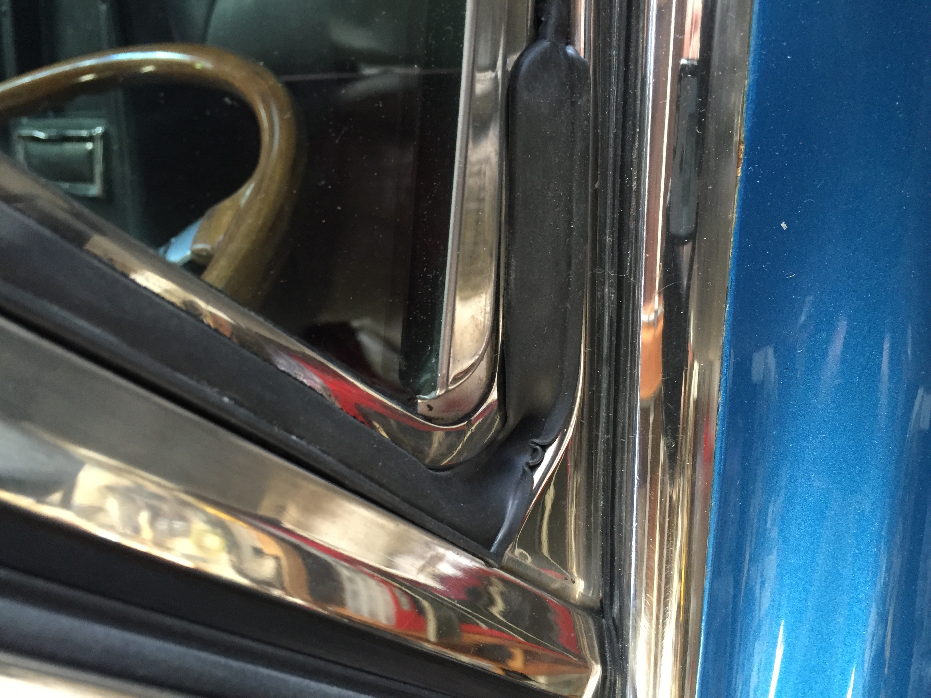

Postby doublegarage » Thu Jun 16, 2016 5:48 am
I said I would follow up on what I received, but unfortunately for now, the news is not too good.
First the vent window rubber ("deflettore").
This piece was too long in the horizontal dimensions, which caused the rubber to be distorted when forcing it into the channel. The vent-glass itself therefore does not fit very well, and leaves an air-gap at the leading edge due to inadequate overlap with the window.
Then the trunk/boot seal - the version supplied had a base (the section that grips the metal seam around the trunk) that was too tall, resulting in the trunk/boot being very hard to close and placing the boot-latch under excessive force.
Therefore, I have been communicating with Cicognani, the maker of these rubber parts near Bologna, and have shipped back to them my original left-side vent window seal and a small section of the original boot seal in the hope that they can adjust their tooling etc. for more accurate parts. The old parts arrived there today and I hope to hear from them in the next few weeks about whether anything can be done.
I have bought parts for many cars from Cicognani over the years and can confirm that when they get things right they are extremely right. Worth waiting for.
