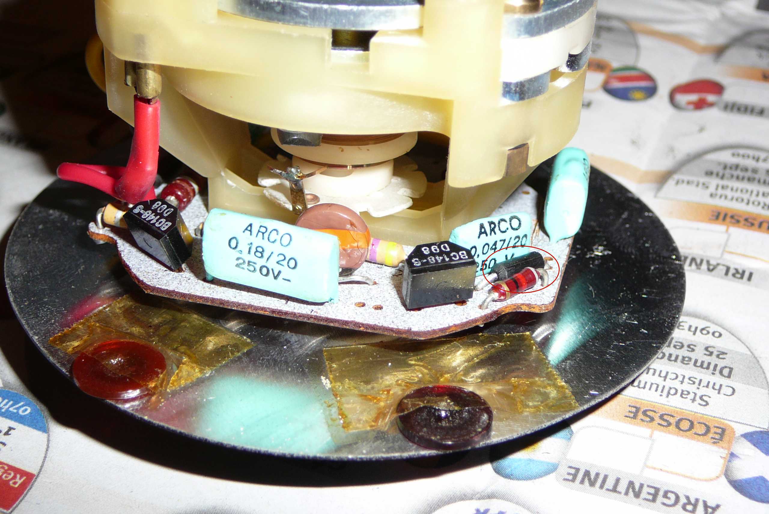

Concerning the tacho, you should double check the dinoplex and make sure you have the right ignition coil. The tacho is electronic, so no damper, just transistors, resistors, and capacitors. If you have access to an oscilloscope, you can check the signal going into the tacho.
fwiw, here is a picture of the insides.

The tacho is driven by 12V and a pulsed signal from the dinoplex. You can reproduce it with a function generator, or even a mechanical switch driven by your drill (eg the points distributor if you don't mind taking it off). Remember that getting to the tacho is only the start: then you need to carefully remove the metal bezel and get tot he electronics. If it was working before, chances is that it is not likely the origin of your problems (yet, but can become once you start fixing it!).
