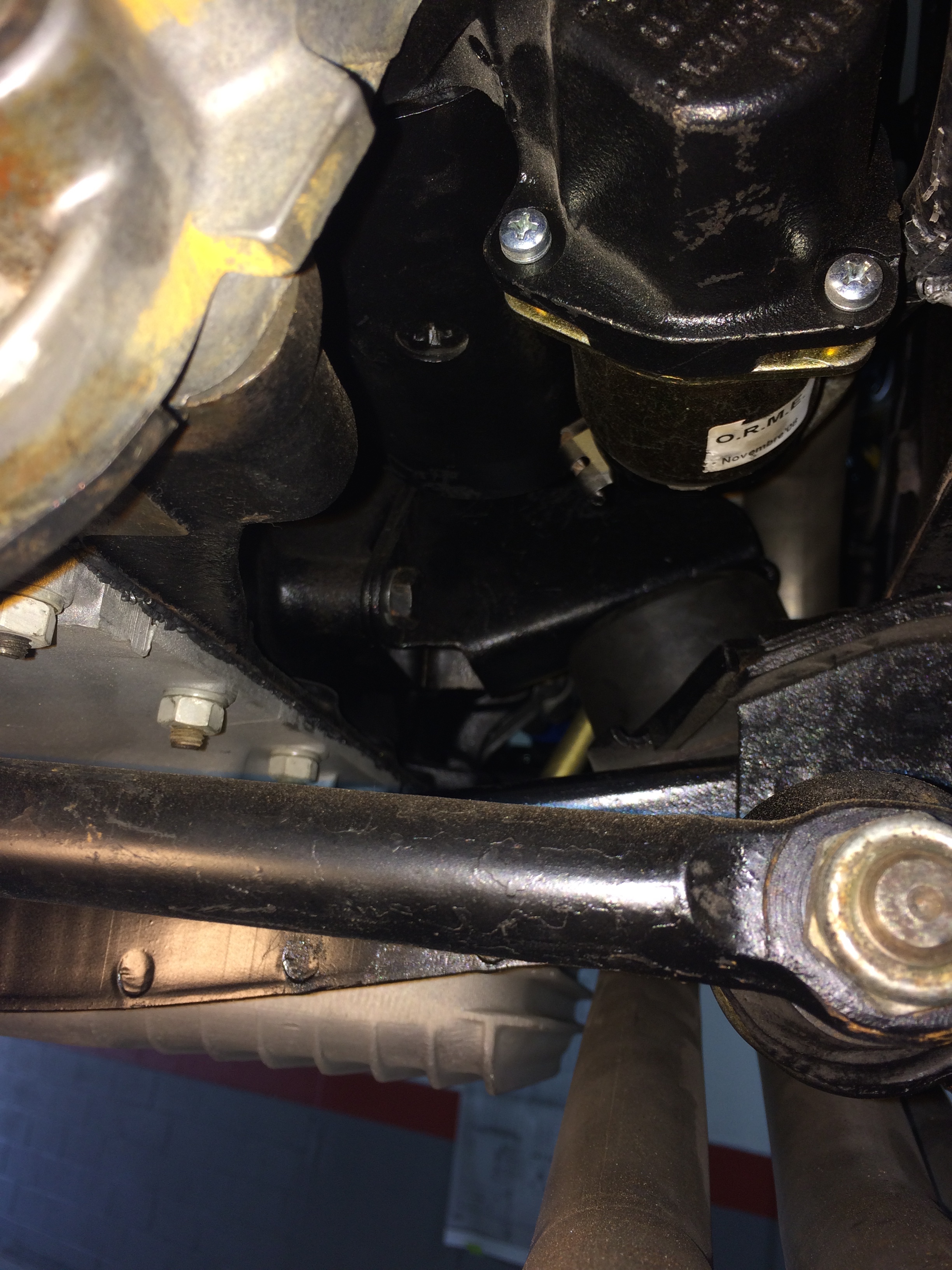

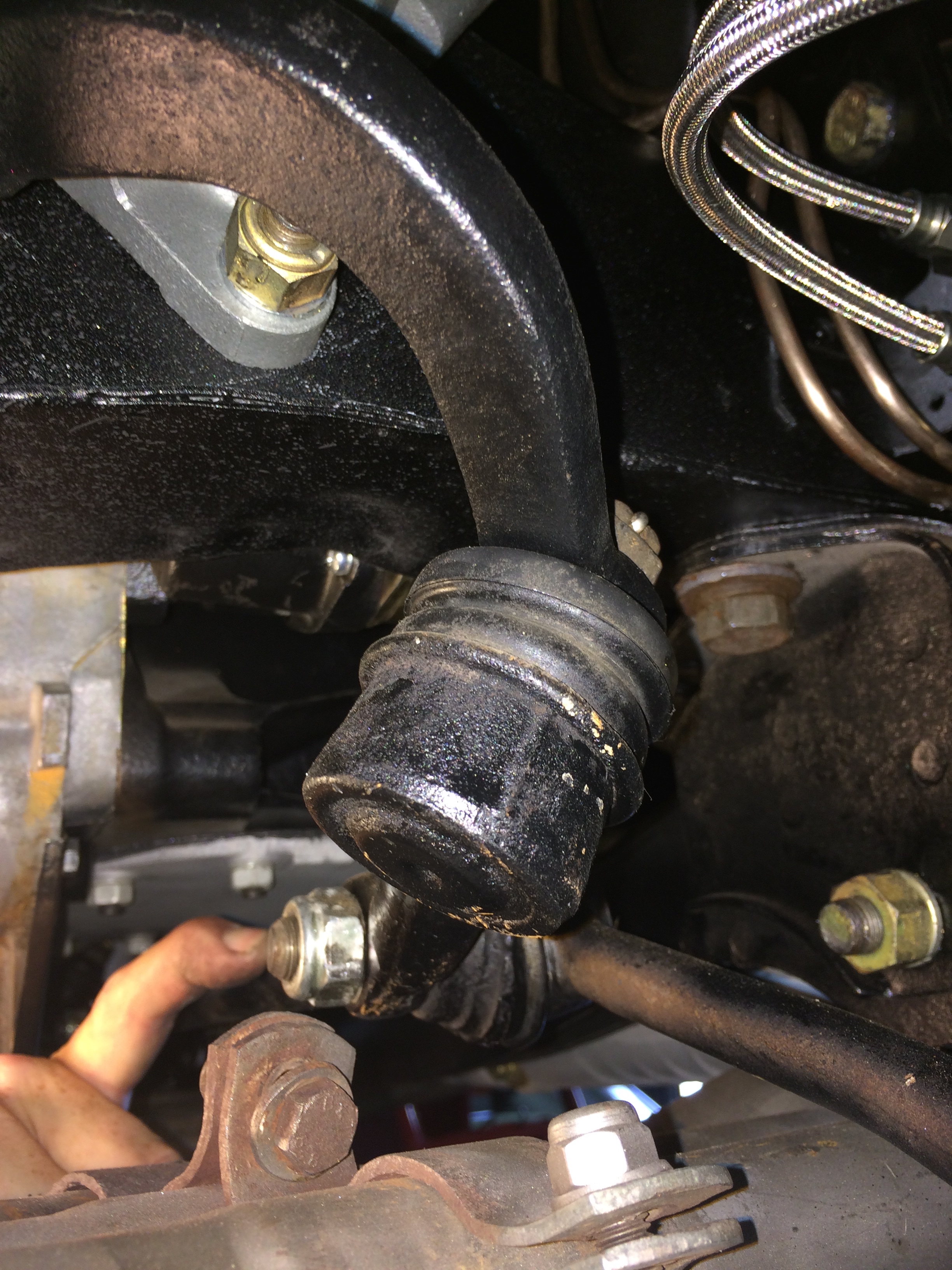

Re: 1967 Dino Spider - removing starter
Hey there
I had my dino in the air today.
The best way to remove the starter will be to remove the motor mount.
Jack the engine
Disconnect the steering rod.
Jack the engine
