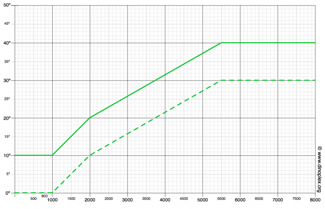

could you post the advance curve for a 2400?
Regards..

Sure, here you are... the dotted line is measured without advance, the full line with 10º advance.Barnfind wrote:I will have a closer look when I'm back.
Regards..
Both values are shown at the crankshaft.

Thanks a lot!
More work to do on the car..
