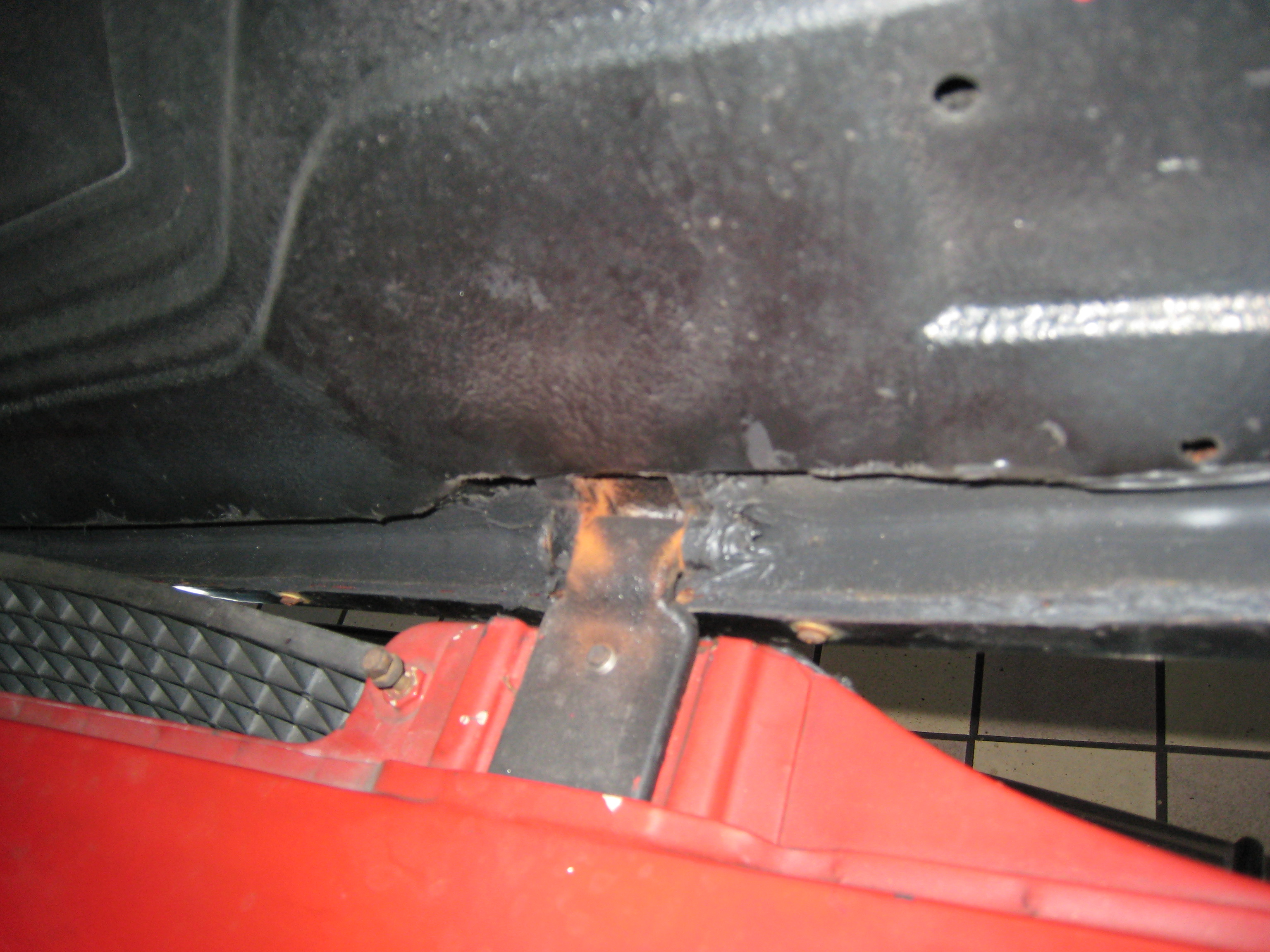

Hi Darren,
Unfortunately, I'm not at home at the moment and can check the Dino for more Infos, but I've found this picture. Maybe it helps a bit.
Regards,
Regards,
Re: Bonnet/Hood Fixing
Thanks Tobi
Thats a start, it must be bolted from the bottom as the hole doesn't appear to be threaded.
Darren
Darren

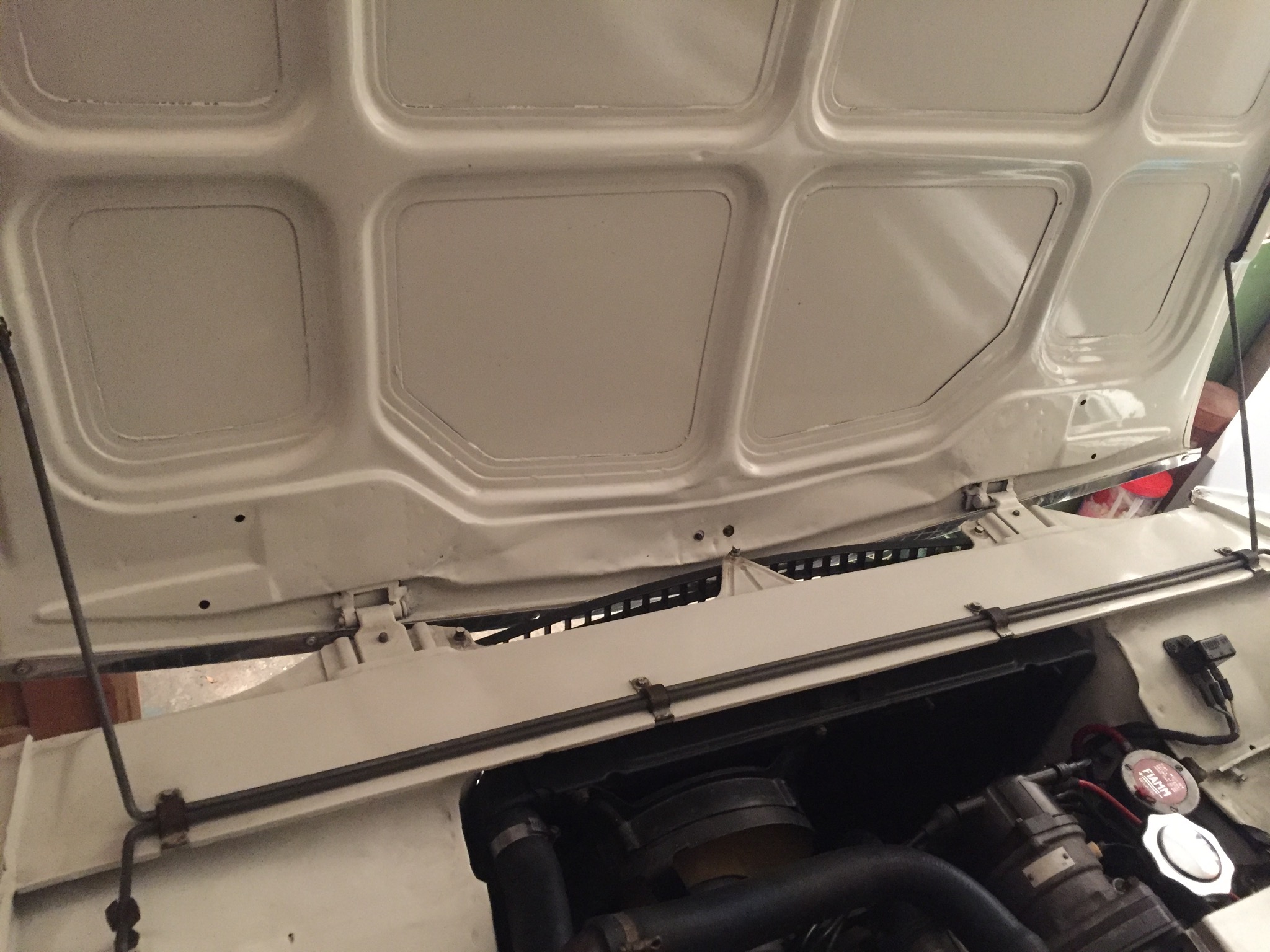

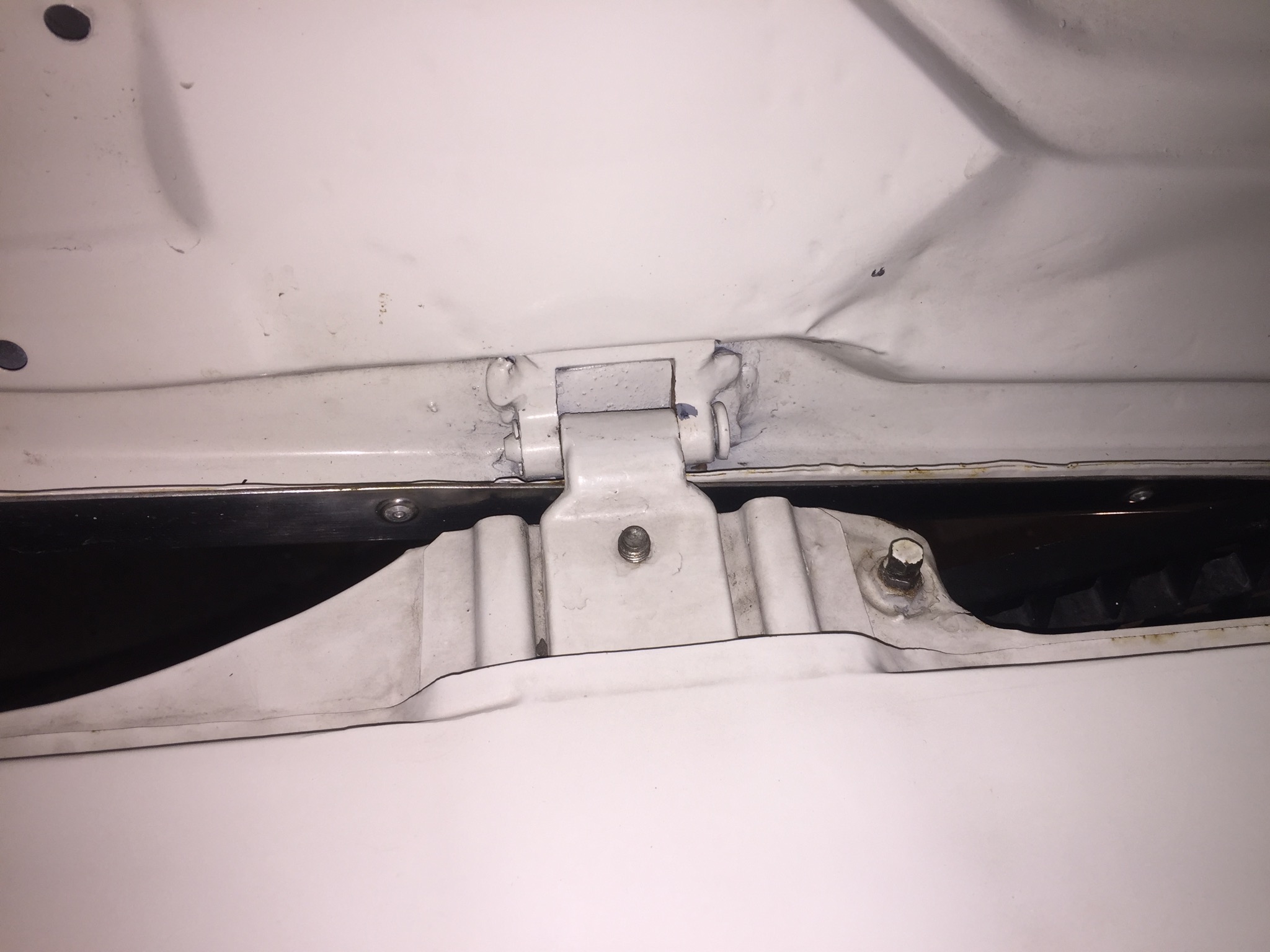

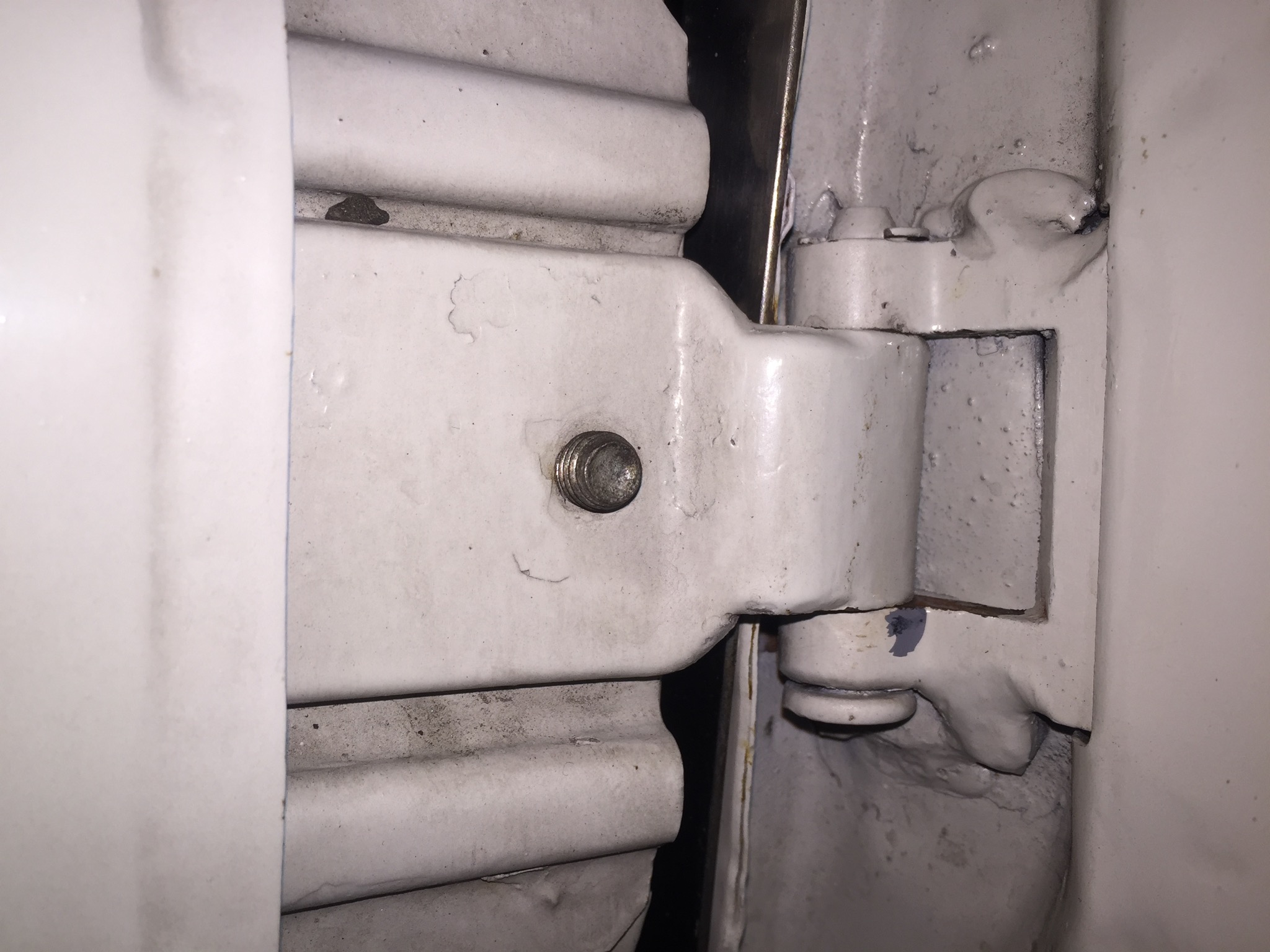

Thanks Hans
That makes sense now, its bolted from the bottom.
