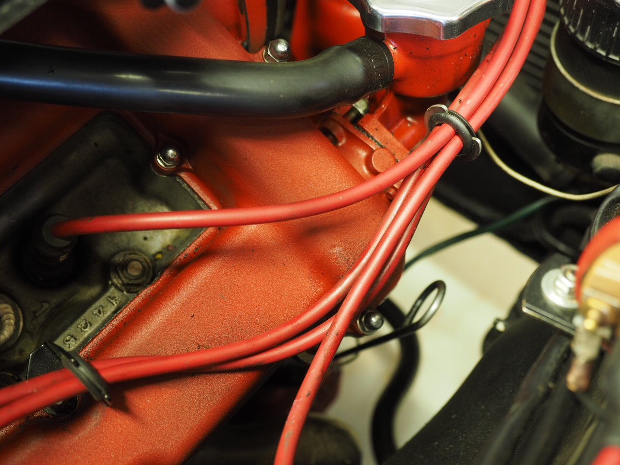

My car has never had stand-offs for the HT leads. As I was ordering from Superformance I thought I'd order some.
Could someone please describe or attach photos describing where they are attached please.

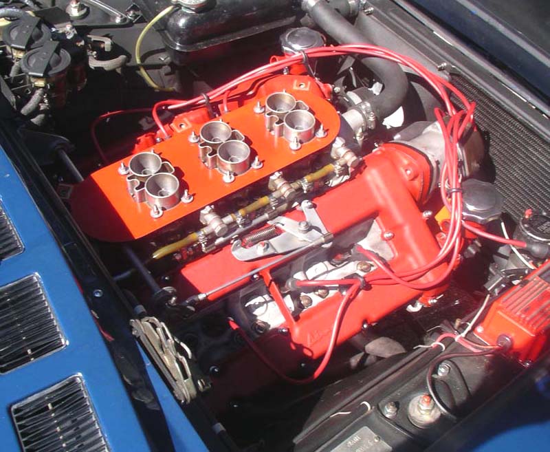

I use 2 angled and 1 flat. RH bank C1 under first acorn nut adjascent to the firing order scroll, (within the spark plug valley, exhaust side) the same applies to LH bank for the 2nd angle standoff. I positioned the flat one on the flat end cap top RH std next to oil filler. angle appropriately. Can be seen in low res attached photo - sigh, I sometimes regret having sold that one.
Gary
EDIT !!
Perhaps on the Spider I used 3, but on the coupe I use 4. Added to above I use a flat standoff on the top RH stud for the oil filler on C123 head.
