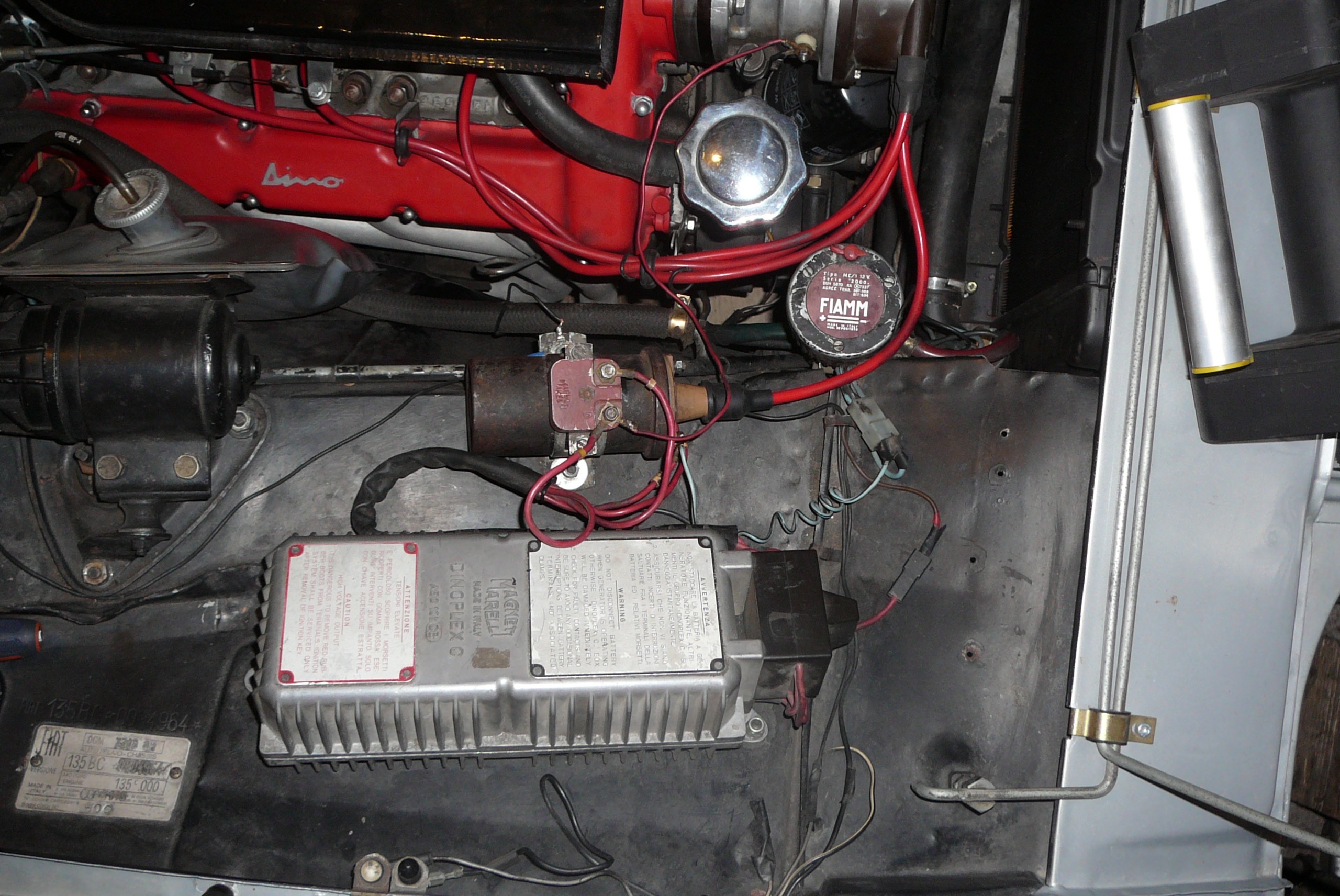

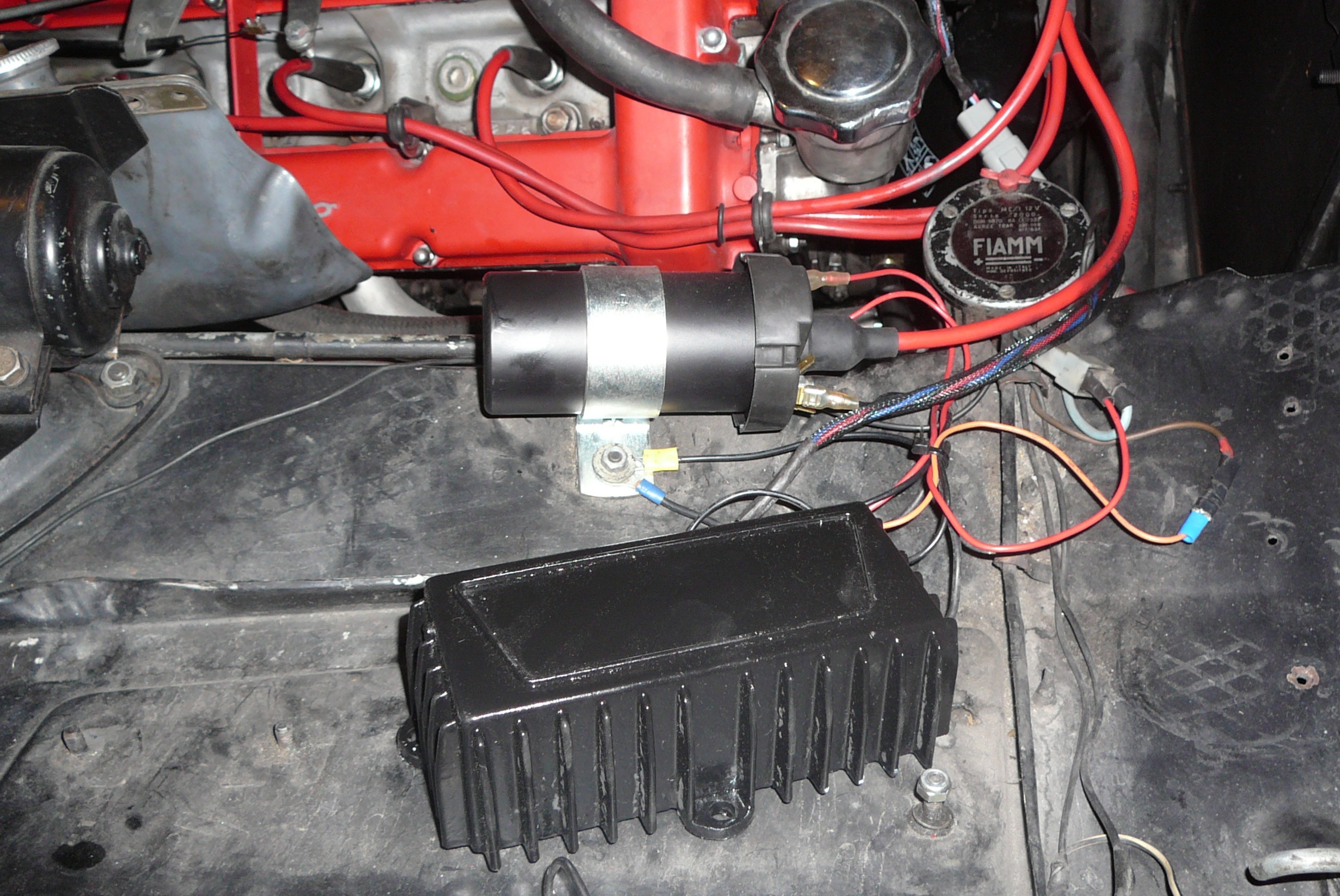

If your looking for an empty dinoplex case that is prepared to mount an ignition module inside, I have some.
this smaller model will look period correct for the 2400.

Hi Stefan,
Do you know if the AEC103 case that you show in your picture uses the same stud arrangement as the AEC101?
I have a Fiat Dino 2400 Coupe which came with a non-working AEC101 - I gutted it and replaced everything inside with the Bosch module according to Adrian's instructions. But most things I have read since suggest that my car would have come with a AEC103 - so I might be interested in swapping to one of your boxes, but only if it bolts up the same way.

Hi Richard,
The studs are matching for both. Both boxes are fastened with two studs to the front and one stud to the rear. The two to the front are always the same. If your car came with an AEC103 and you install a large AEC101, the rear stud will be under the AEC101 and might need to be shortened. The rear one should also be there and fixes a coil bracket in AEC103 setup.
The studs in your car should show you the original setup. If it came with an AEC101, it might happen that the rear stud for the AEC103 is missing.
Cheers,

Thanks Tobi,
The studs perfectly match the AEC101 case, with no evidence of them ever having been modified. So I think my car (ser.no. 04211) must have come with AEC101 originally. I'll keep the AEC101 (now containing just a little Bosch module).
Thanks again,
Thanks again,

Of course, keep it. Both versions are correct. Bosch inside is still better than any other solution different from a Dinoplex.
By the way, I have an AEC101 in my car and it seems that it came originally with an AEC103 since there is a stud for the smaller one under the large one now. I didn't want to shorten it. Now it doesn't sit flat on the fender.
