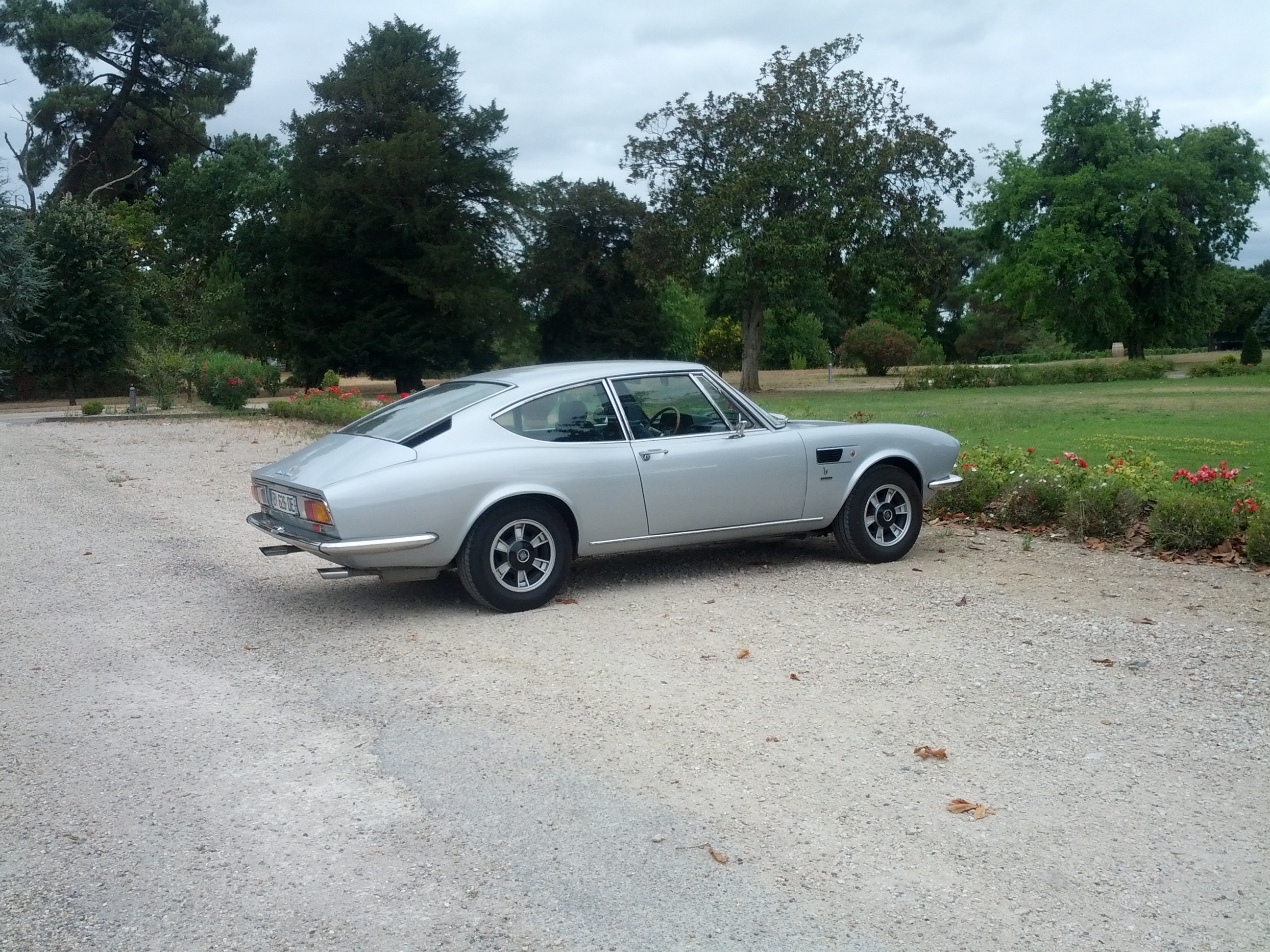

Postby Dario » Sun Jun 25, 2017 9:50 pm
Sorry I didn't see this sooner, I had mine done in grigio argento (a beautiful color) and had it made by a company in Milan. They sourced the correct code from the factory and I should have the composition somewhere, if you need it.
Good choice, post pictures!

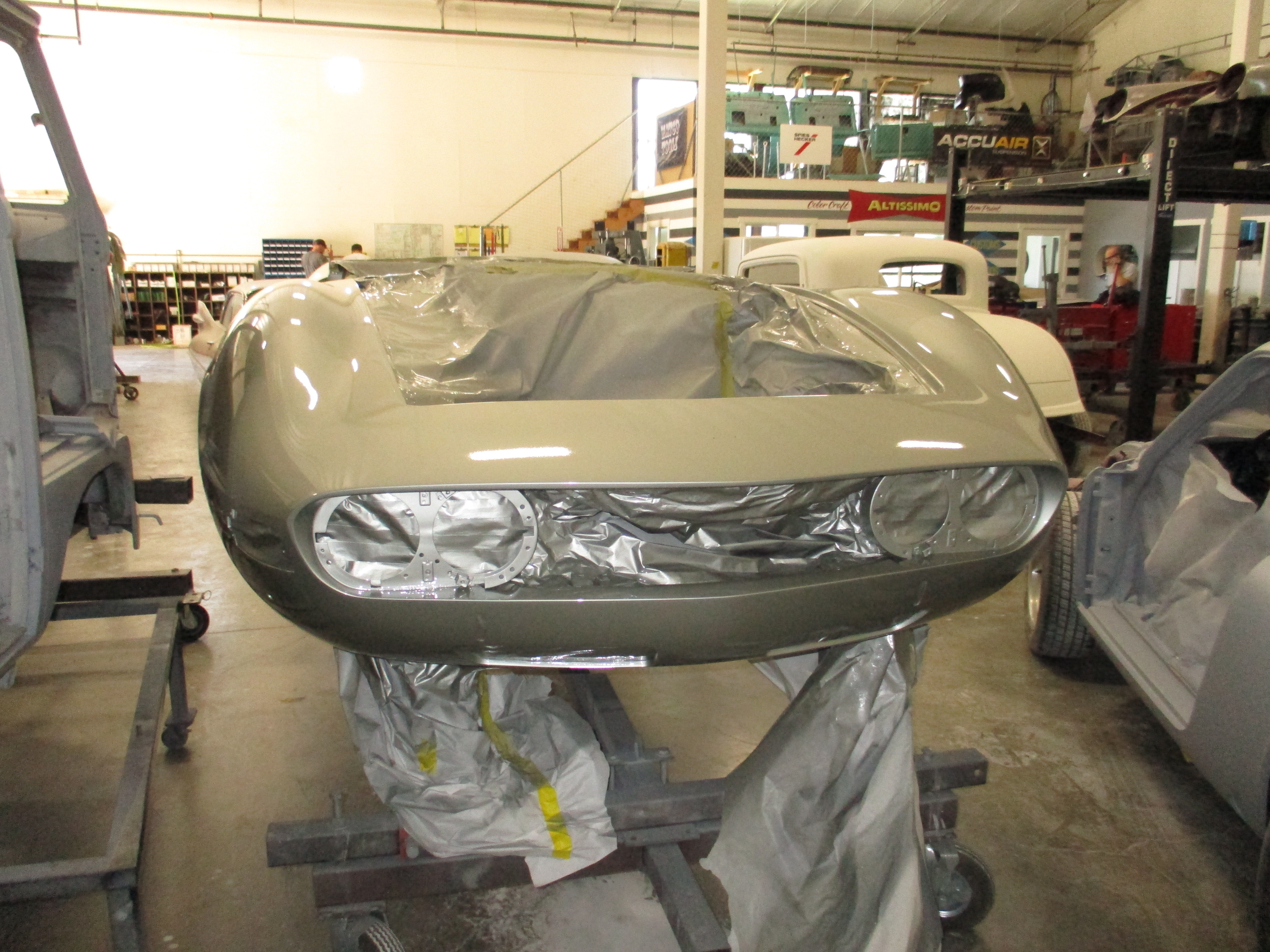

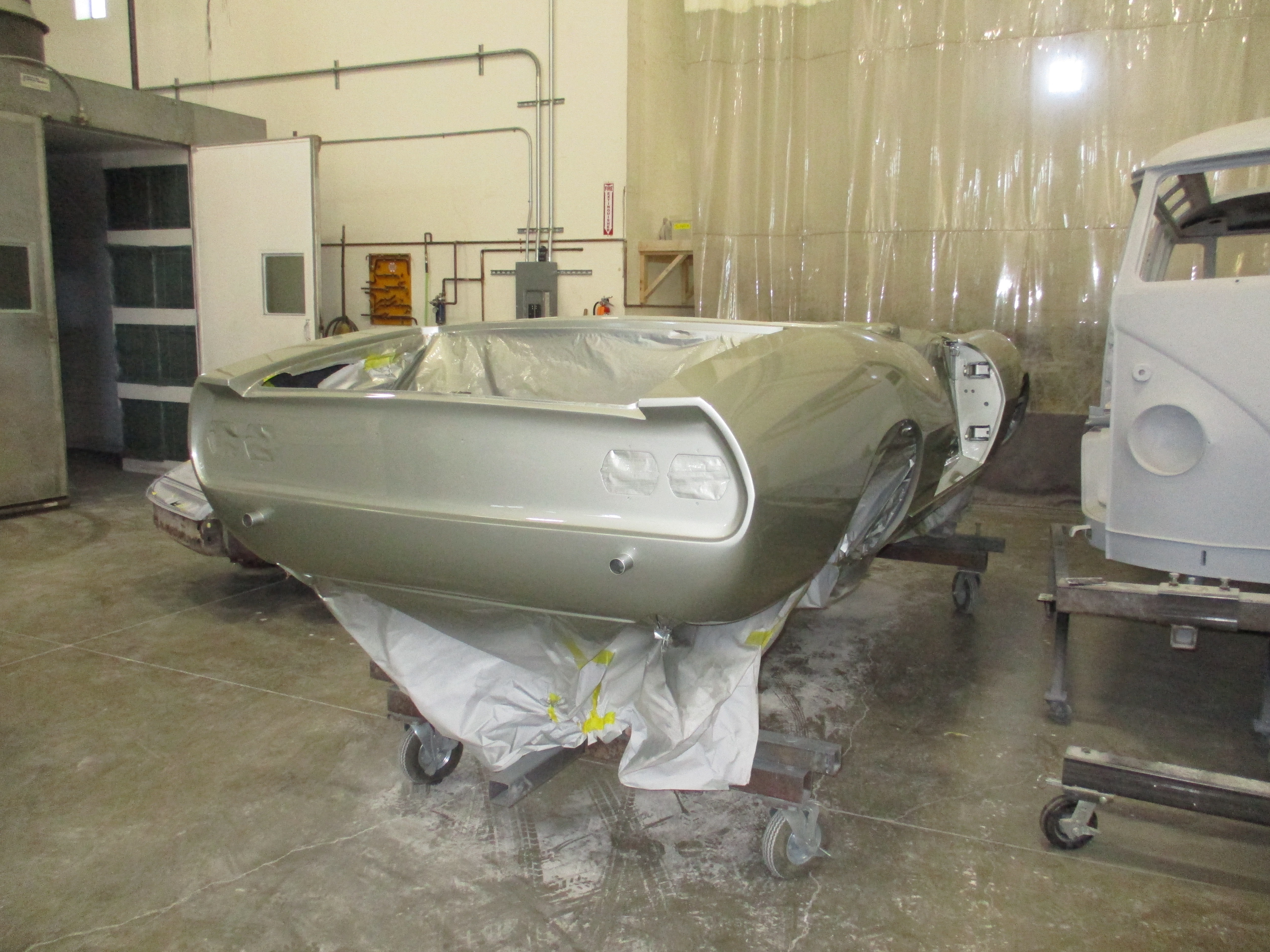

Postby dinoverde » Fri Jul 21, 2017 4:38 am
Here is the 1969 spider 2400 painted with the correct 605 code.
