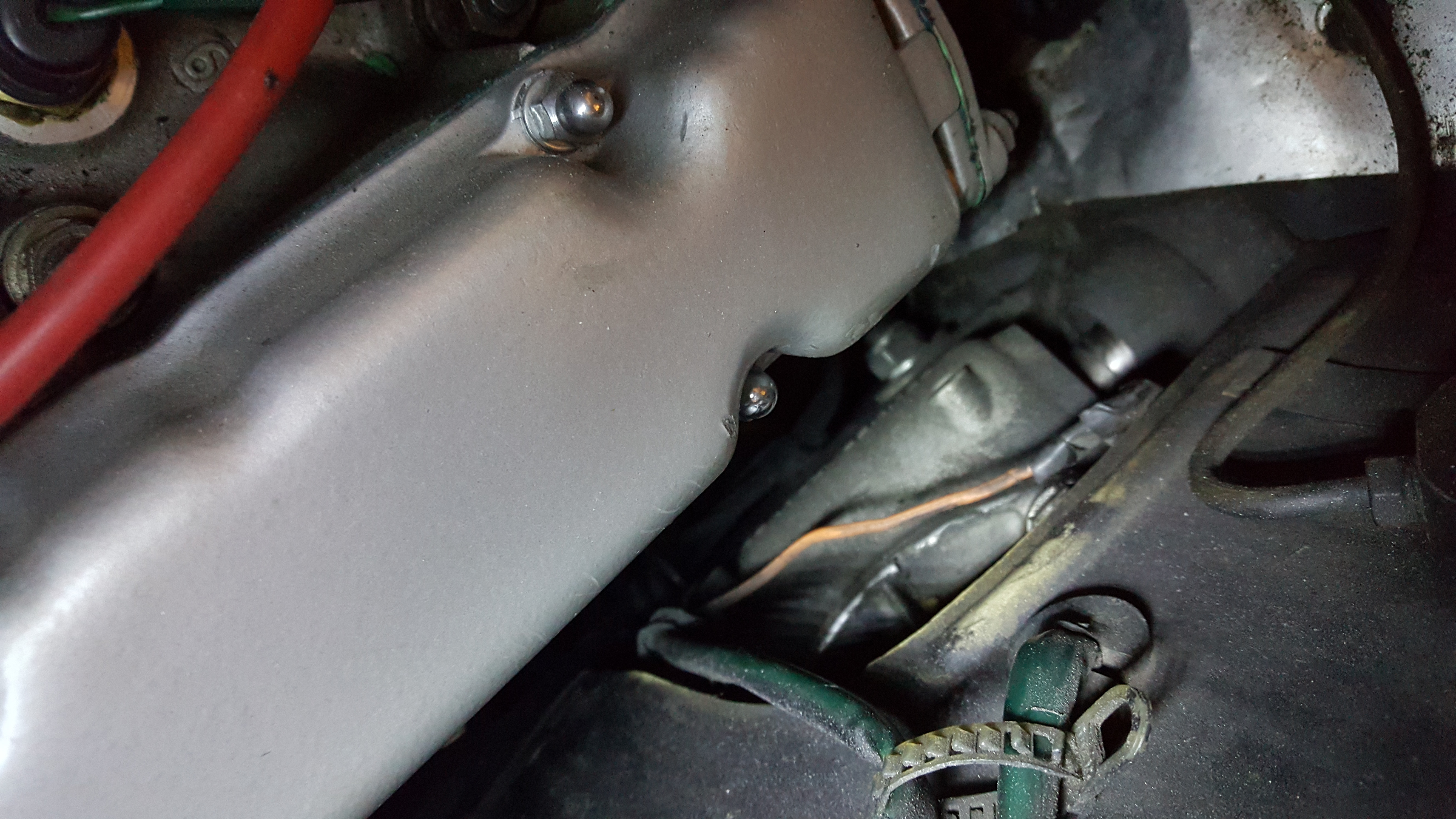

Postby ThomasK » Sun Jul 23, 2017 9:22 pm
Here a picture of my not connected cable on driver side (the orange one) due to brake pads without indicator (EBC).
Posts: 92
