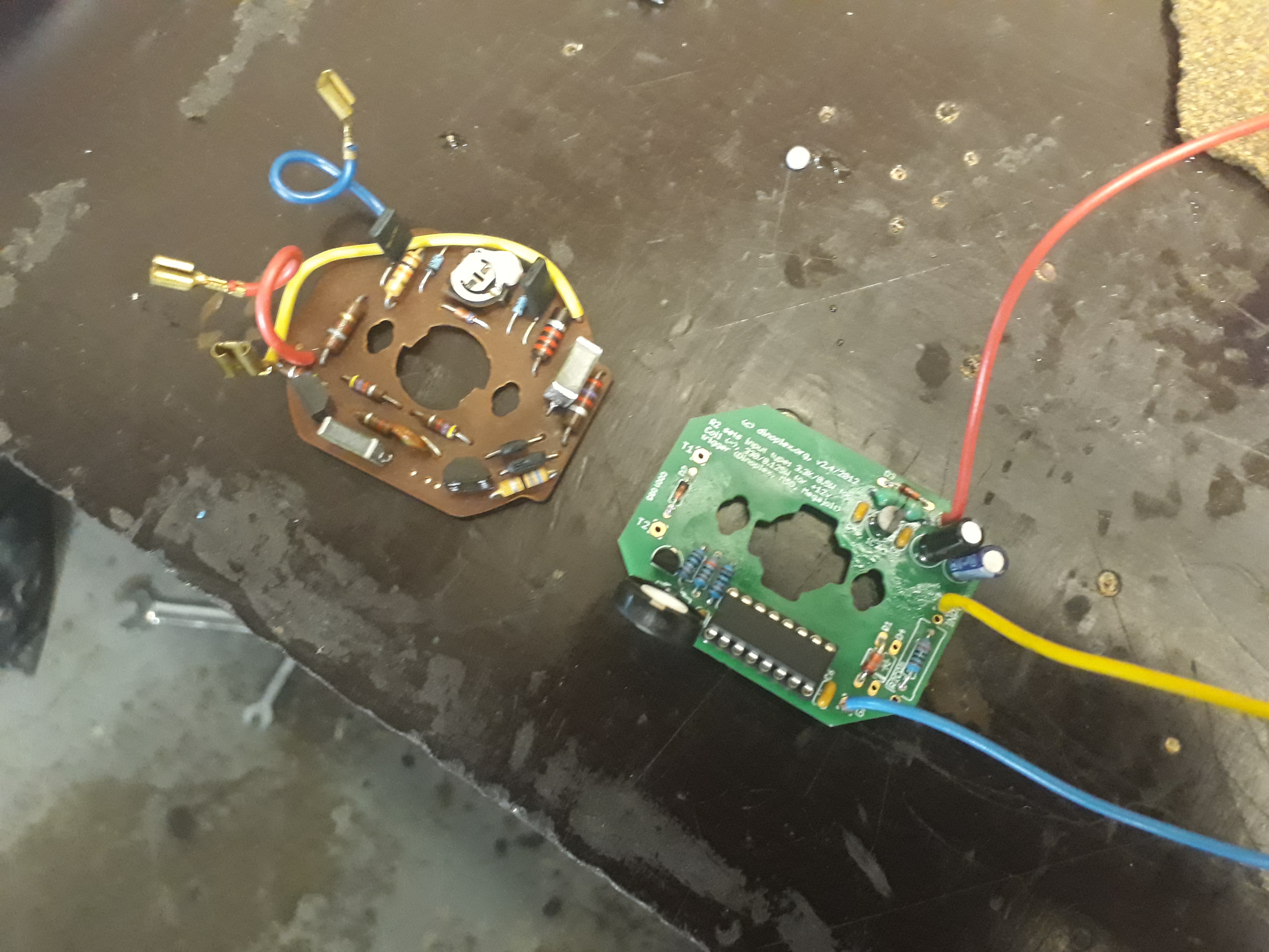

First of all did you connect your tacho to the coil - terminal or to the grey tacho signal wire from the MSD?
Most likely (but this is based on what i have heard and read but not investigated myself) is that the original tacho requires a 12V square wave signal generated by the Dinoplex ignition. Many times the Dinoplex has been replaced with an inductive ignition system somewhere in the life of the car. People will than take the tacho signal from the coil - terminal which can or will damage the tacho because the voltage spike on the coil - is much higher than 12V.
It should work perfectly with the MSD signal. Someone i know also had an issue with his tacho and i solved the problem by making a new tacho circuit board for it, you can find it here: http://dinoplex.org/tachoconversion/index.html
All the info and files to make the circuit is in there,it has been designed by Adrian which is the moderator over here if i'm correct.
If that would be a good option for you to get the tacho working but you do not have the knowlegde or skills to make it, i had 10 sets of tacho circuits boards made and i have all the resistors and parts as well so i can help you out if needed.
