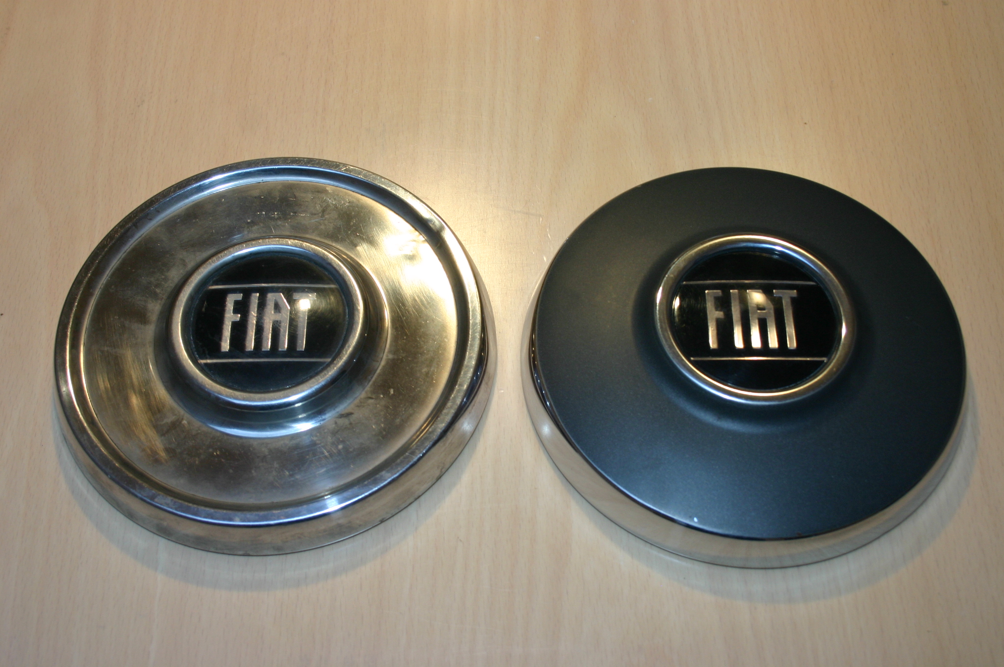

Hi Luis and Scalino,
Fiat Dino 2000 Coupé, Fiat Dino 2400 Coupé and Fiat Dino Spider came with three different types of hub caps.
Fiat Dino 2000 Coupé came with complete stainless steel caps. Correct FIAT spare parts number 4150253. This cap is being offered by both Dino Parts and Superformance. I assume that these are reproductions.
Fiat Dino 2400 Coupé came with stainless steel caps with black painting. Correct FIAT spare parts number4216665. It’s the cap on the right on the photo below.
Both Fiat Dino Spider 2000 (with bolt on rims / wheels) and Spider 2400 came with all stainless steel caps. It’s the cap on the left on the photo below. The correct FIAT Spare parts number is 4218680. Superformance offers this cap, I assume it’s a reproductions.
All these caps will fit the FIAT Dino Cromodora 6.5x14 rims and are interchangeable. Hope this helps.

Thank you Georg. Do you think the 2400 coupe hubcap you show in your photo is the same size (it looks to be!) as the 2000 shown on Superformance's site, except the correct 2400 is black (as shown in your photo) and the 2000 hub cap is not painted, polished steel? Superformance say they do not fit the 2400. Do you know how exactly they are different (besides black paint) than the 2400? Thanks, Luis

Over the past 35 years I have owned several examples of each of the 4 variants of fiat Dino. Of the 3 series that regularly use bolt on hubs, I have never found that the various types of hub cap will not fit. I would be very surprised if the parts offered by superformance did not fit 2000 coupe, 2400 coupe, 2400 spider. I am aware of the few 2000 spiders that were produced with bolt on wheels, and I'd feel these hub caps would fit all bolt on wheels.
Hope this helps. My understanding is that if a part purchased from superformance was not suitable, then if returned in good order would be refunded. As previous correspondents have referred they occasionally come up on auction sites, and other Dino specialists offer them too. In summary, I'm certain they'll fit your car.
