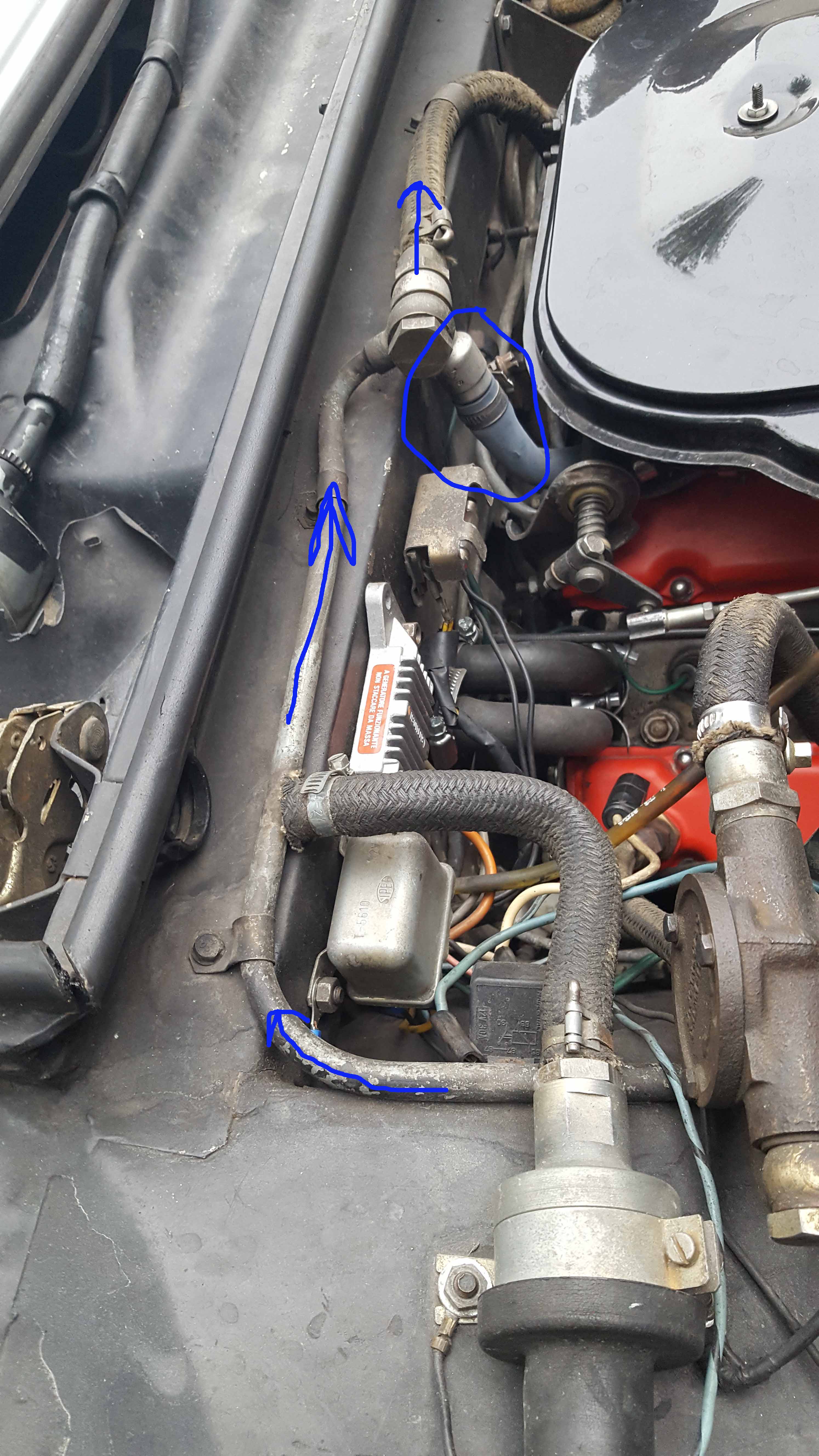

Hi, I've had a request for pictures of the vacuum system, so I shot some this morning when I took the car out to go to work :)
Here is a front pic of the system. I drew yellow circles on the oil lines (the small one is the oil delivery, the large one is the oil return line). A blue circle on the vacuum line to the system, a blue "X" on the line to the pump vacuum switch
On the next pic, you can see where the vacuum pump connects to a metal pipe through a T junction. The front connection goes to a large canister in the front bumper. The back connection goes to the brakes and vacuum switch
On another pic, I drew a circle around the relay and disconnected the wire from the vacuum switch for you to see. It's not the original relay (obviously) but I think it's the correct location judging from the length of the wires.
Lastly, you can see where the metal pipe goes along the back of the engine bay and separates into a vacuum take-off from the engine and a rubber hose to the park booster.
Sorry for not imbedding the photos, it's not working too well for me and they move all over the place... :roll:
Hope this helps,

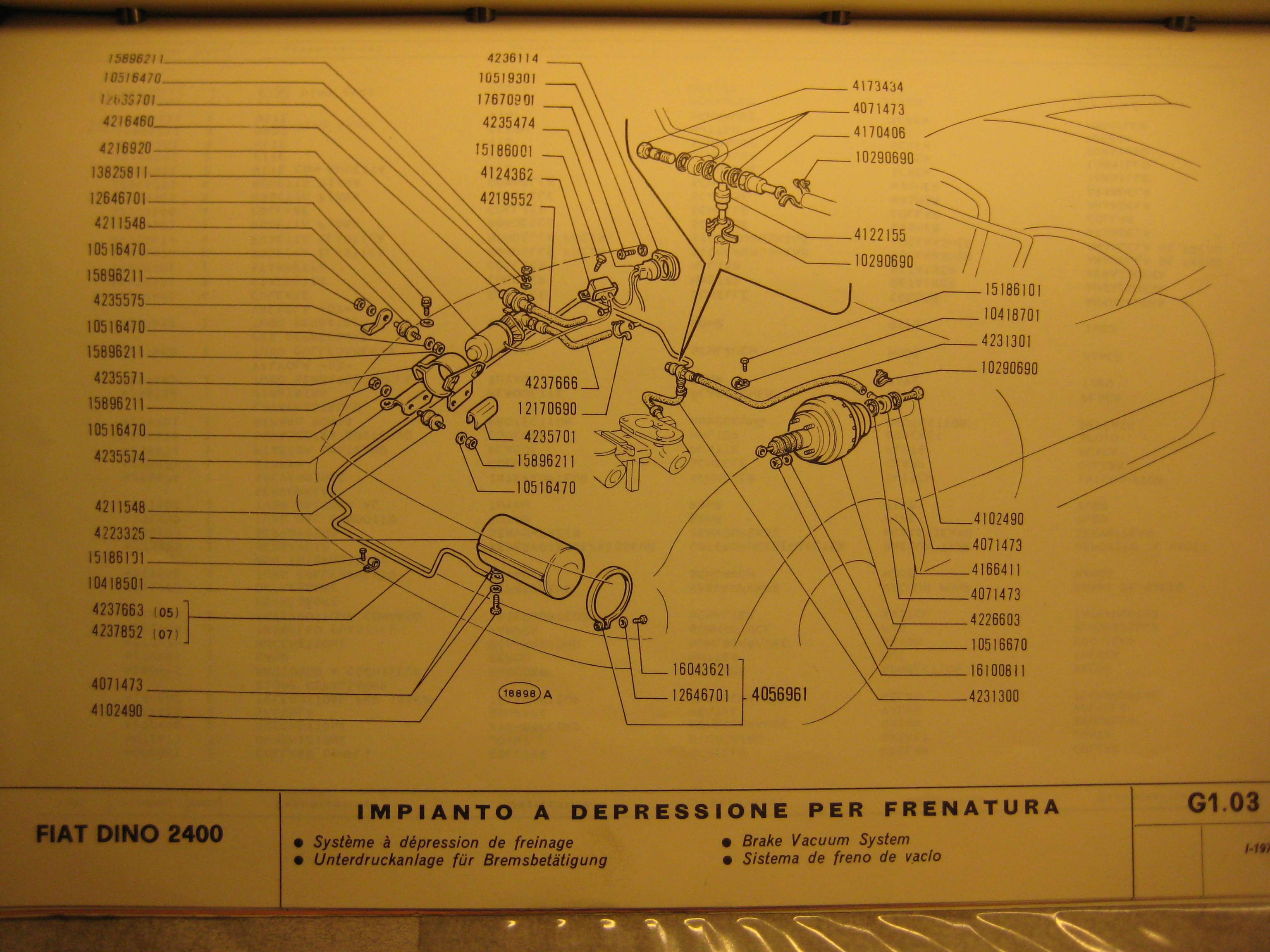

Here are some Fiat original workshop manual pages that might help you solving your servo pump issues. Note that the 2.4 litre
electric diagram really shows the pump, pressure switch and safety switch wiring.
As far as I can understand, there is no oil feed line to the vacuum pump...?
Dinoswede

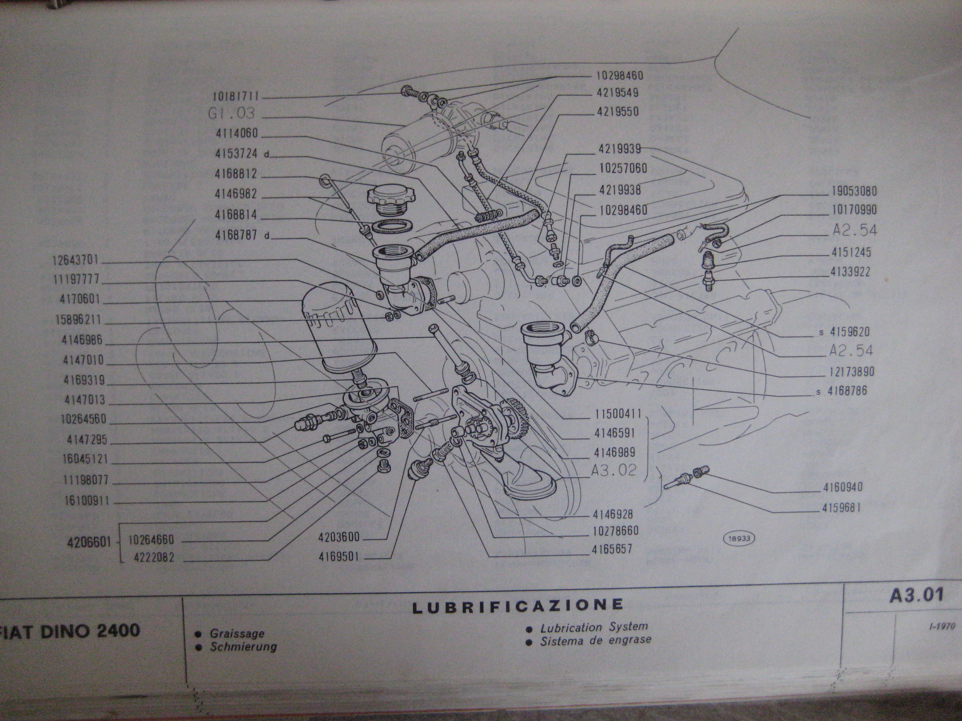

Dinoswede, There are oil pipe connections not shown on the schematic drawings. See the pictures sent by Dario and look for the 2 small pipes with the orange markings.
Regards
Leigh
Dinoswede
Posts: 109
Joined: Sat Apr 05, 2014 4:22 pm
Re: Understanding the vacuum system
Post by Dinoswede »
Maduno, you are absolutely right! When looking at page G1.03 there is no trace of any oil lines -
probably because they are shown at page A3.01 !!
