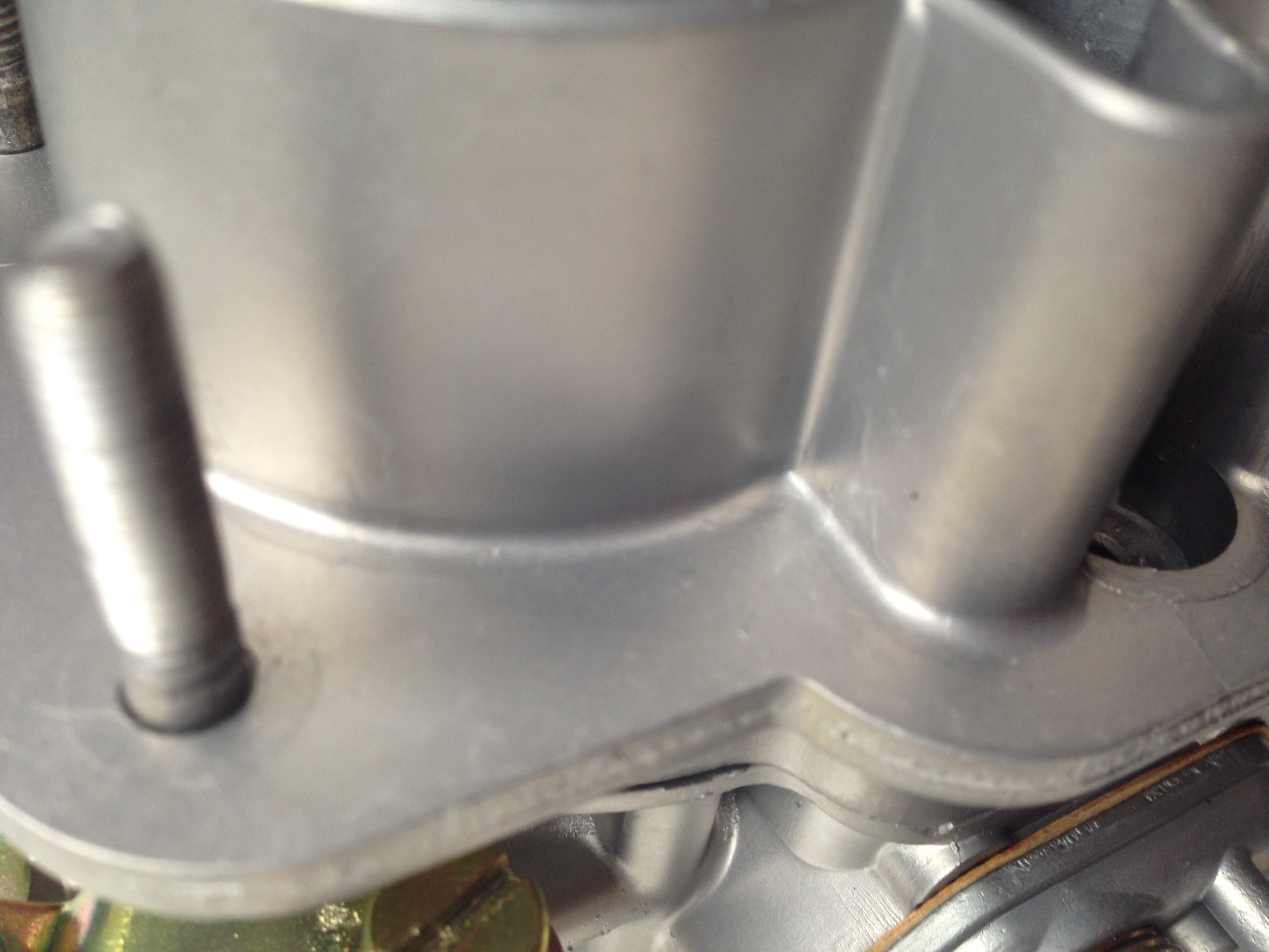

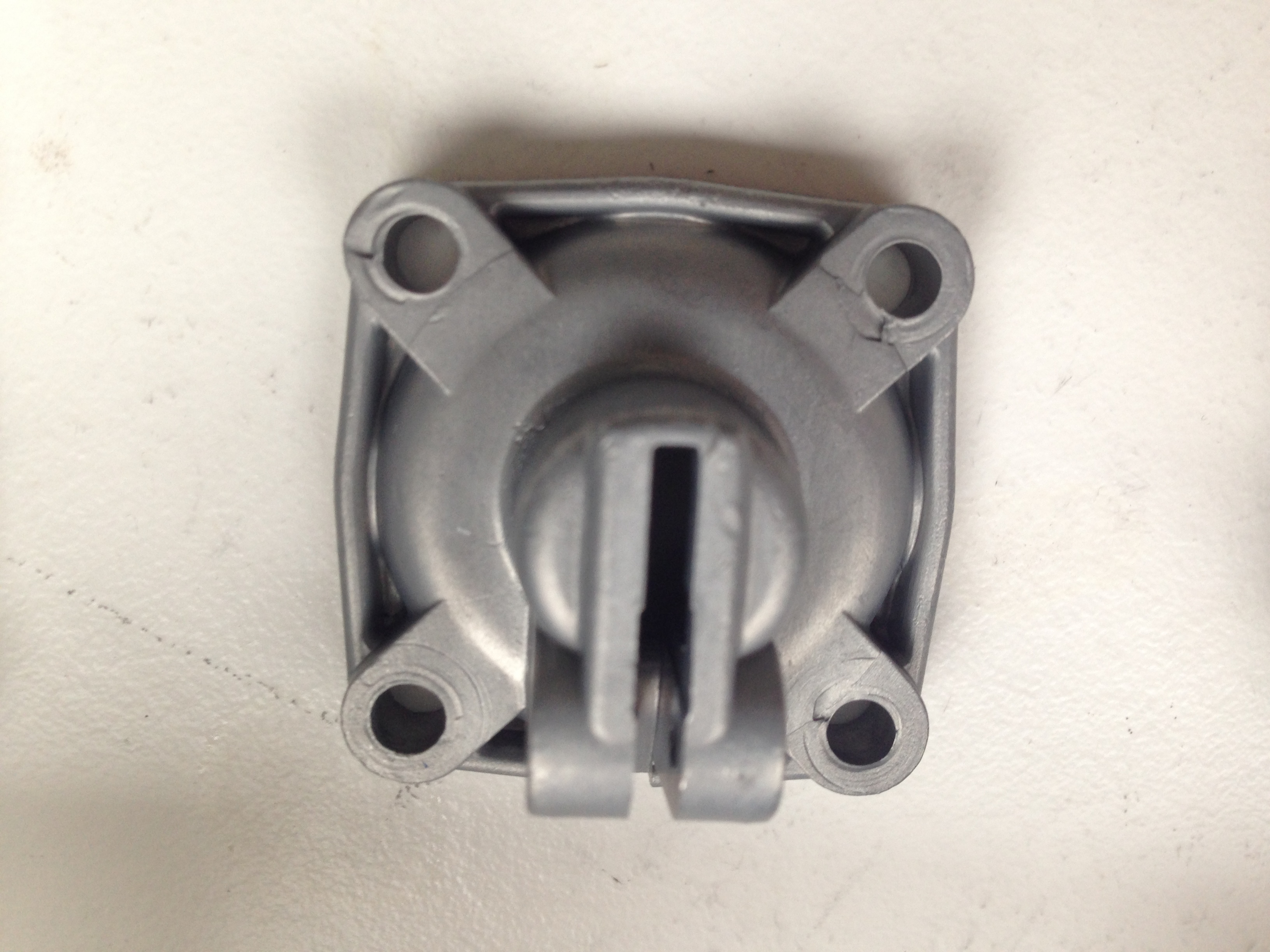

Bit of an update;
We got the carbs all rebuilt, but are now dealing with a severe fuel leak coming from the middle carb (more detail in the technical section of the forum). We did get the carbs to look great though . Also had a new throttle shaft (running along the firewall) made and installed new bushes.
They went from looking like this:
Via:
To this:
So at least it looks good while I'm frustrated with it...
Via:
To this:

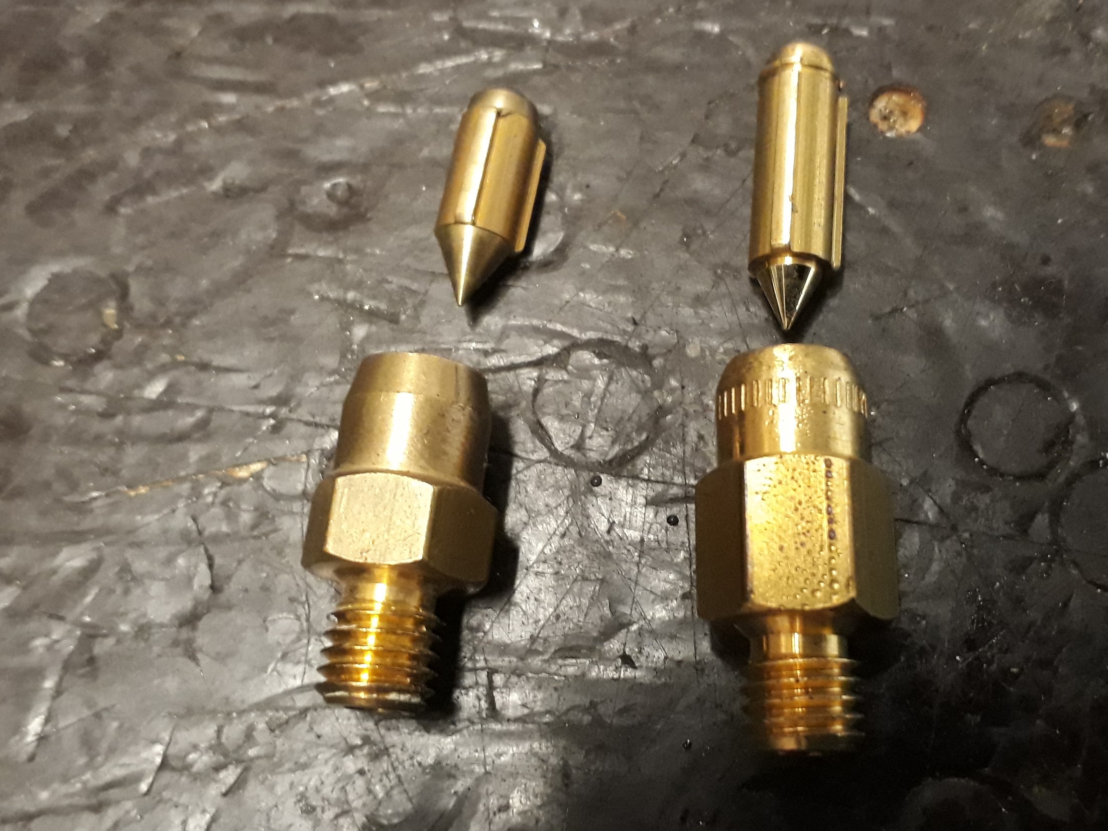

- Posts: 168
Re: New member introduction
Did you also replace the needle valves and if yes do you know for sure if they are original quality weber needle valves?
I had the same problems, rebuild my carbs completely but could not get them free of leaks no matter what. In the end it turned out that the rebuild kits included needle valves from inferior quality, replaced them with original weber valves and all sorted, no leaks ever again.
I included a picture where you can clearly see the diffence in surface finish of good and bad quality needle valves. The one on the right has a mirror smooth finish where the one on the left looks questionable.
(don't pay to much attention to the different sizes of the needle jets, they are for different carbs but it's just to show the difference in quality)
- Posts: 179
Hi Stefan, that's an excellent suggestion. Yes, we did replace the needle valves from a rebuilt kit we already have, of which I don't know the quality. I have a another rebuilt kit as well, so I'll check both and the ones that came out.
We did check the needle valve when we had the leaking offender off. When closed no air would be allowed through way above the supposed fuel pressure. Though that one is now leak free, so that adds up.
I'll check and report back this weekend!
