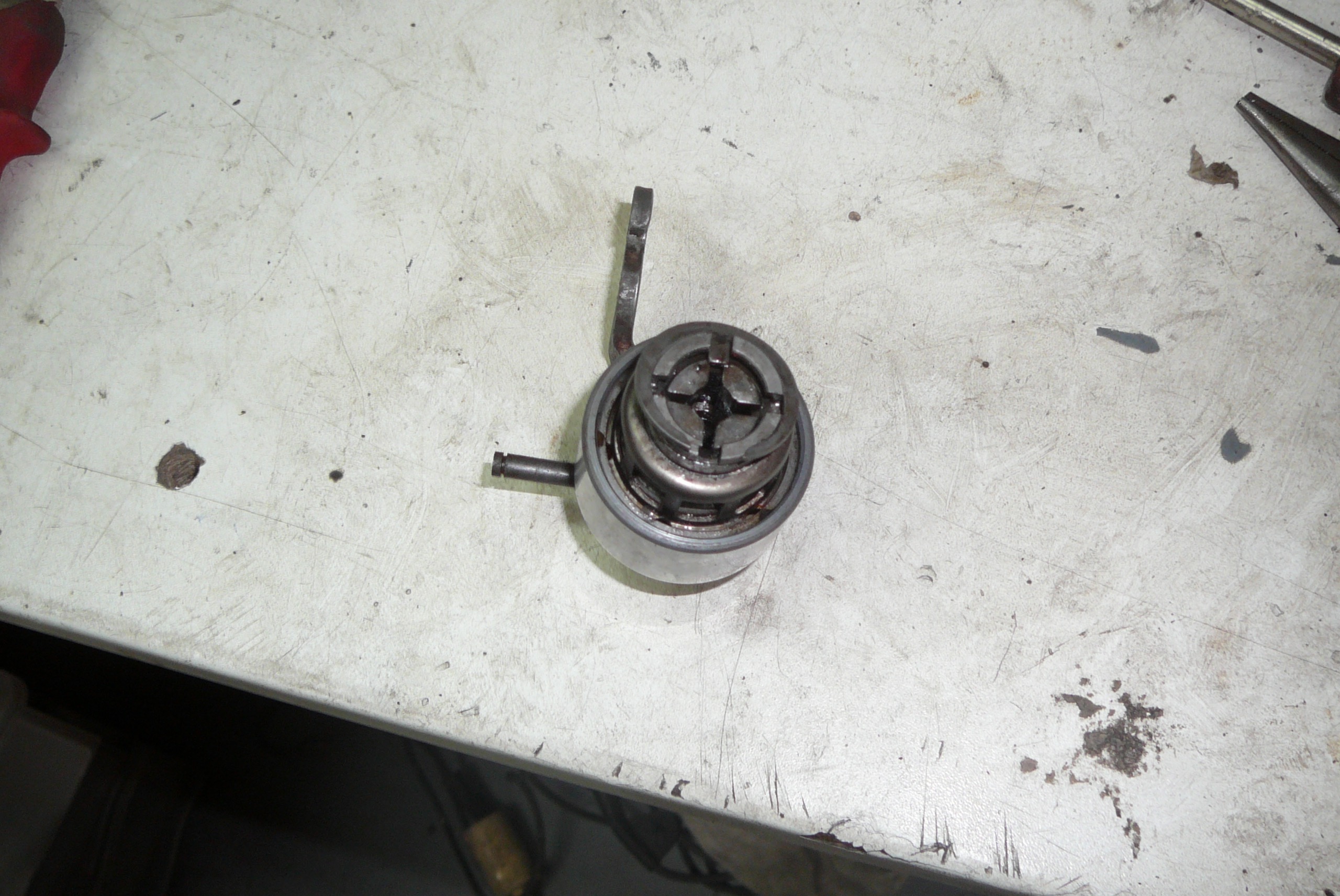

Also tried spraying with cleaner and lubricating with WD40, but it didn't work for long. Of course, you should try that first, maybe all that is holding yours up is gunk. Here are a couple of pics of the offending part. It is the rear piston that also houses the lever for the E-brake. When that is pulled, a lever pushes against the other piston, compressing the caliper. There are small o-rings on the lever shaft that prevent fluid from leaking. They had deteriorated on mine. Once the caliber is appart, you need to use a vise to compress the spring to remove the key that holds it in. Then you work your way down and remove the circlip holding the bottom piece into the piston.
Dario

Anyone know how to add more than one picture in the same message?
