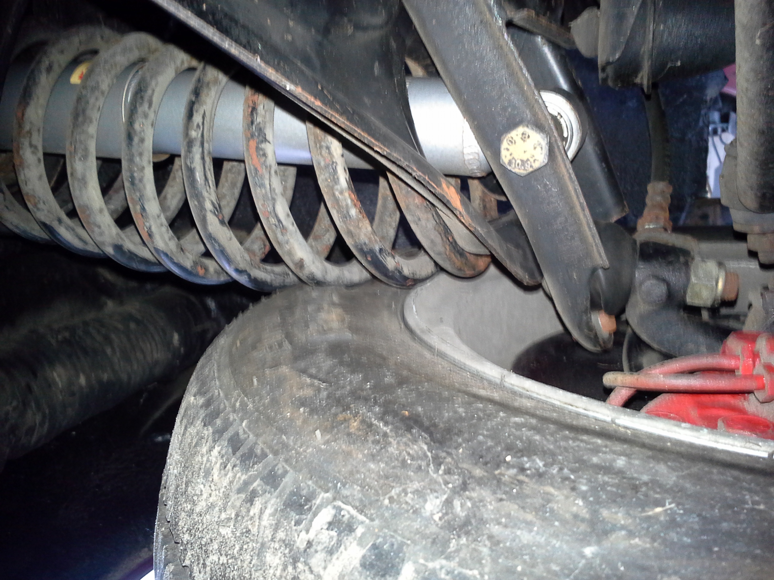

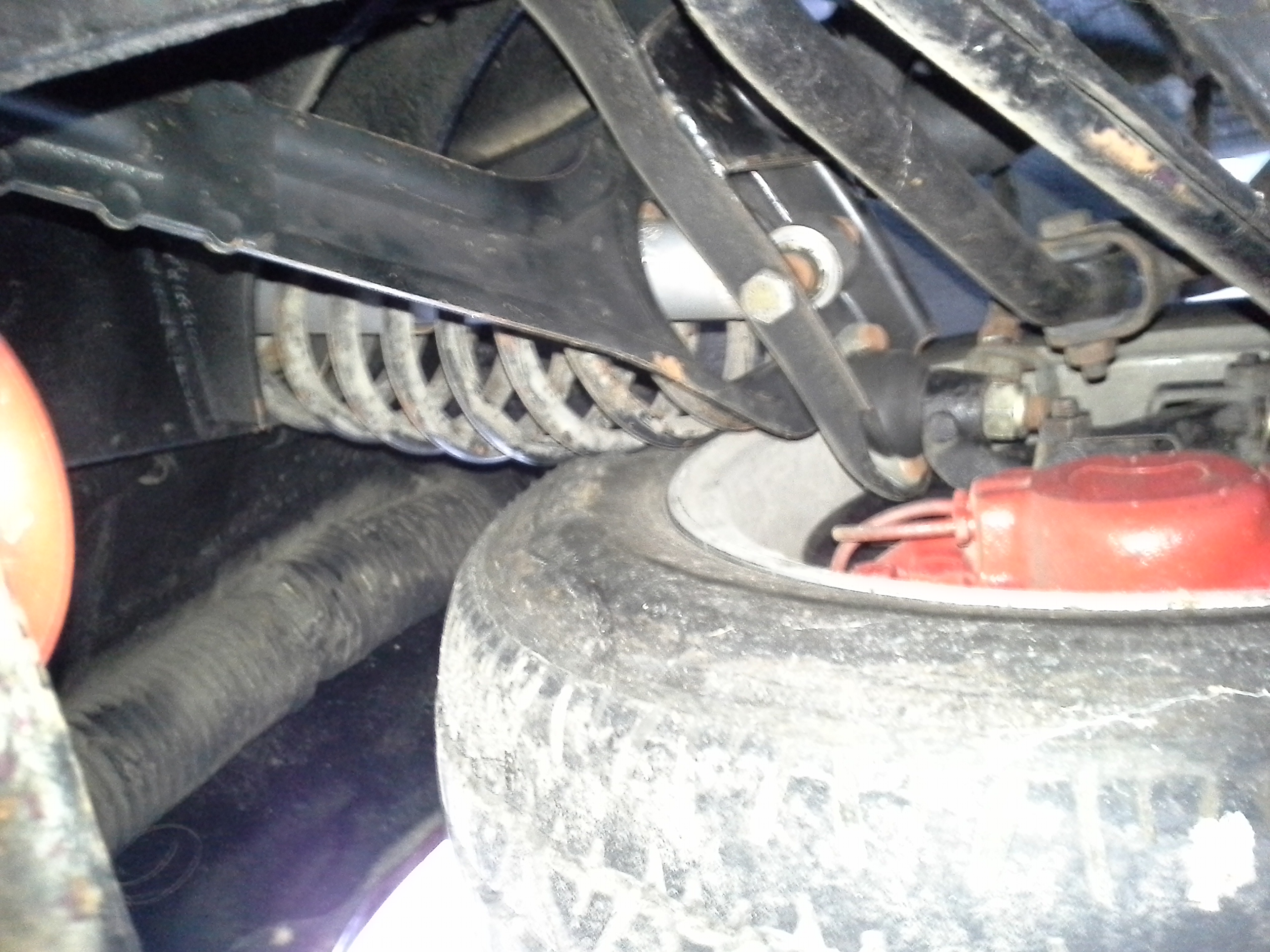

I am still getting acquainted with my recent 1967 Dino coupe purchase. I have the car on jack stands and when the front suspension is at full drop [like it would be if you were changing the tire] the coil spring is making contact with the tire side wall and I cannot rotate the tire. I checked with my Fiat 124 friends to see if they had ever encountered this problem, and they say no. Is this normal for the Dino coupe? I've never seen this before on any other vehicle I've owned. It is not an issue when the car is on the ground. What is wrong with my suspension? Photos attached.

I guess I should have mentioned the car has 195 wide tires and not the stock 185 width. If the spring hitting the tire is normal, how do you change a tire on the front if you get a flat tire? Do you just crank down the lug bolts and compress the tire against the spring? I have not actually removed a wheel from the vehicle yet. I thought my front brakes were locked up at first as the pressure from the spring prevents hand turning of the wheel.

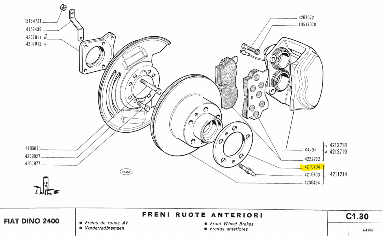

When Fiat introduced the 2,4 Dinos with 205/70VR14 tyres, a distance plate was added
at the front axle, to avoid this tyre - coil spring contact. It is often lost at surviving 2,4
Litre cars, but it can be seen at the Spare parts catalogue picture C1.30 (below)

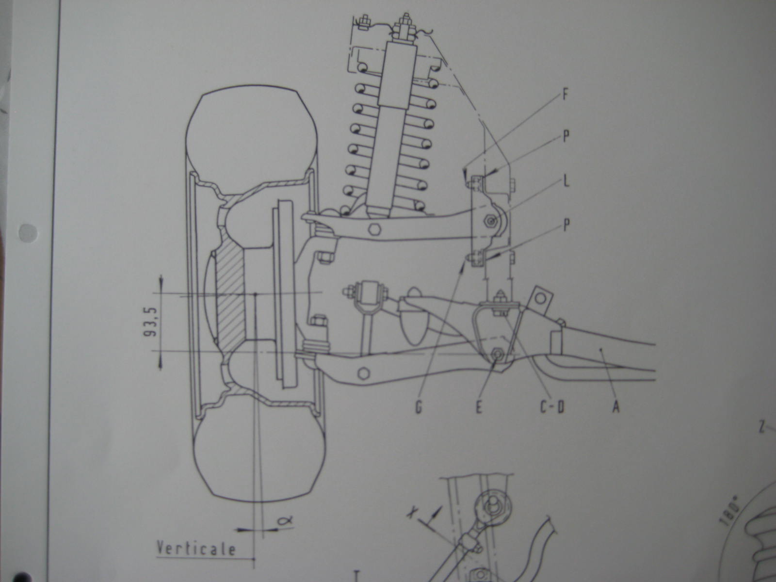

One possible explanation for this problem could be the use of shock absorbers with
"too long movement". When the car is lifted up, the upper A-arm moves down in a
bow, pressing the spring out. In the same movement, the top of the tyre moves
somewhat inwards(!) depending on the front end geometry. The movement is stopped
by the shock absorbers´ "maximal length". See picture below.
