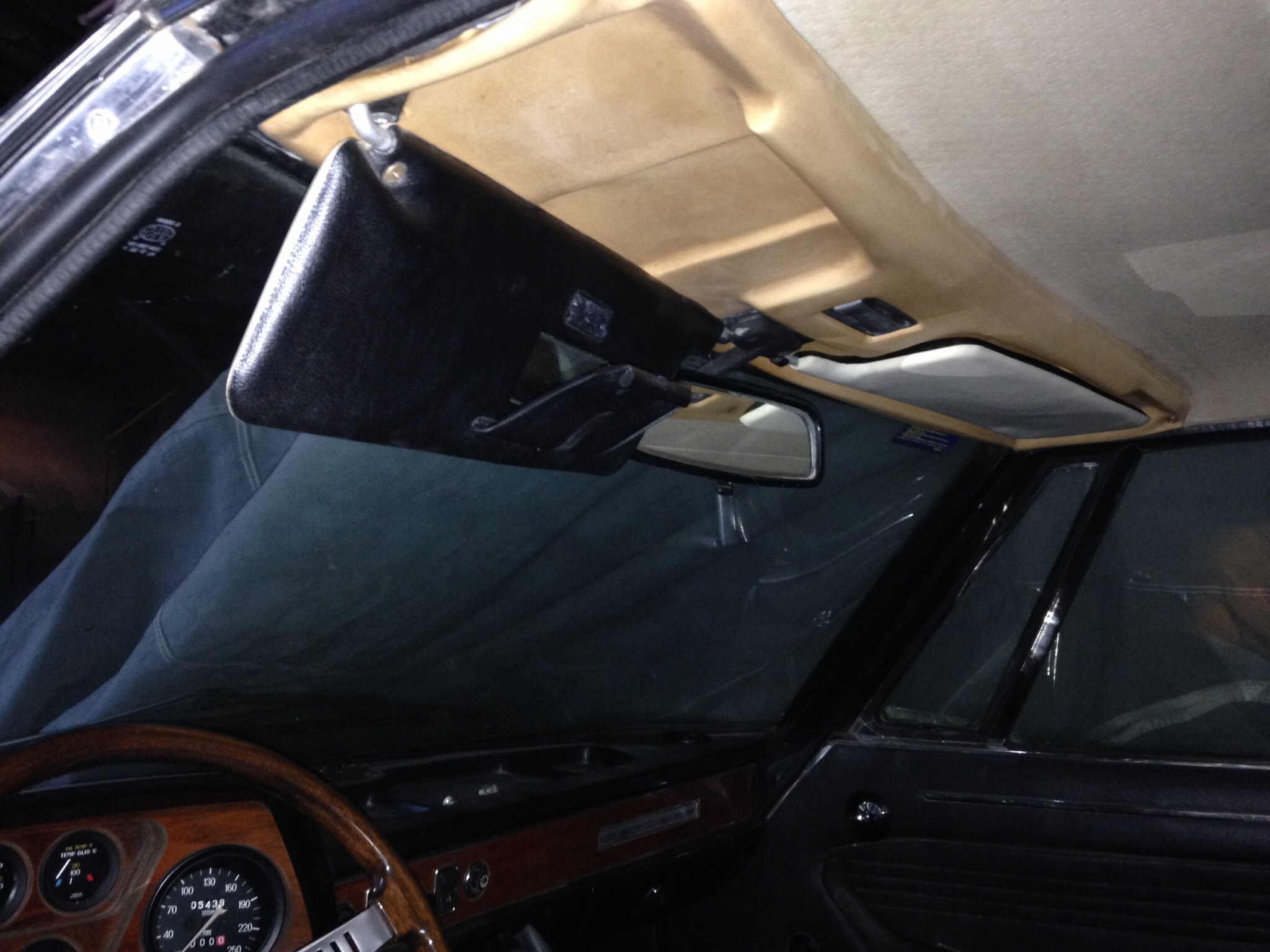

Put in my 'new' sun visors. Henrik on the dino facebook page mentioned some other guy was posting dino parts on ebay. I took a look and found the only two parts I was still missing for my project car!!

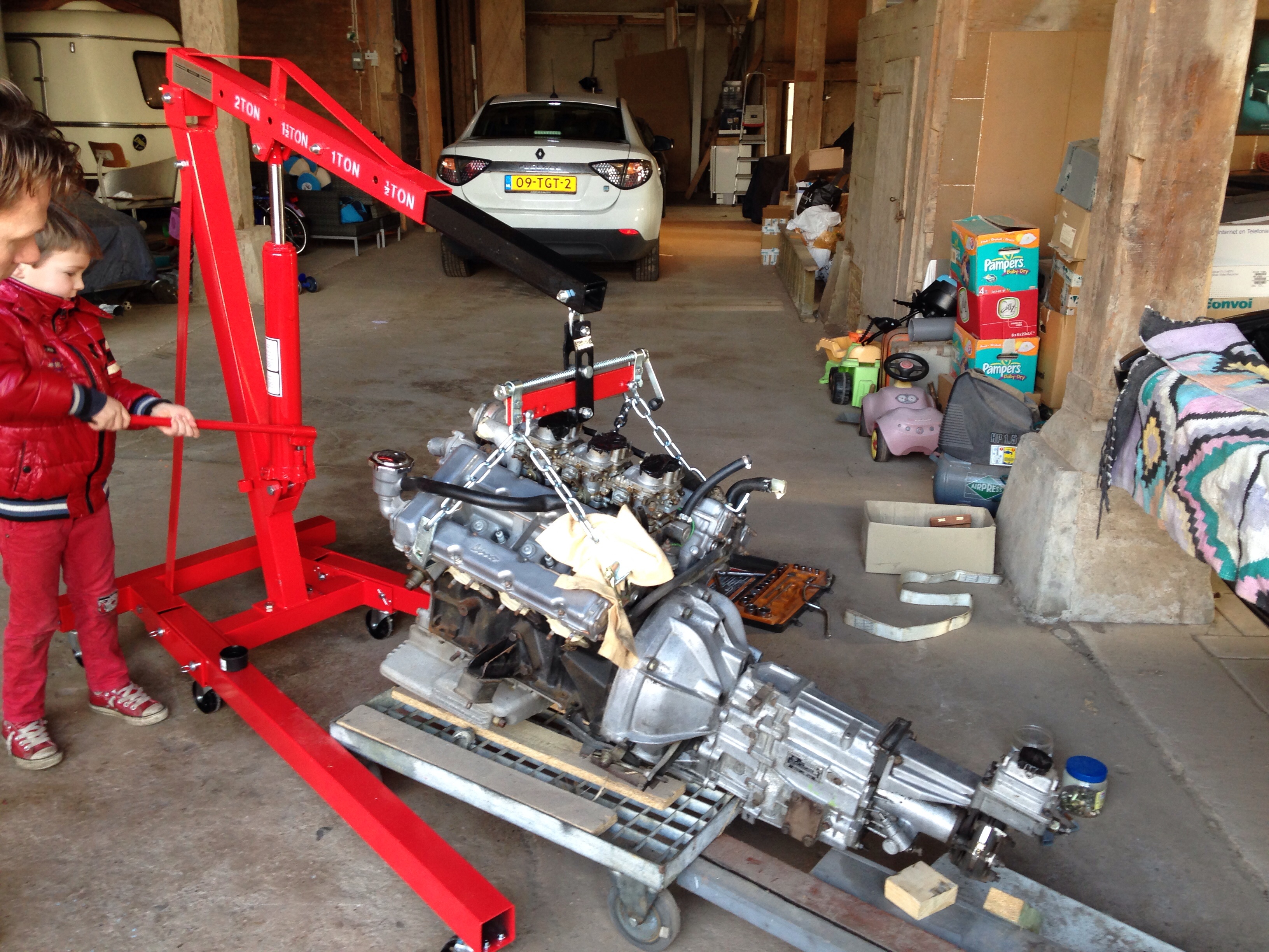

Dropped in an engine...

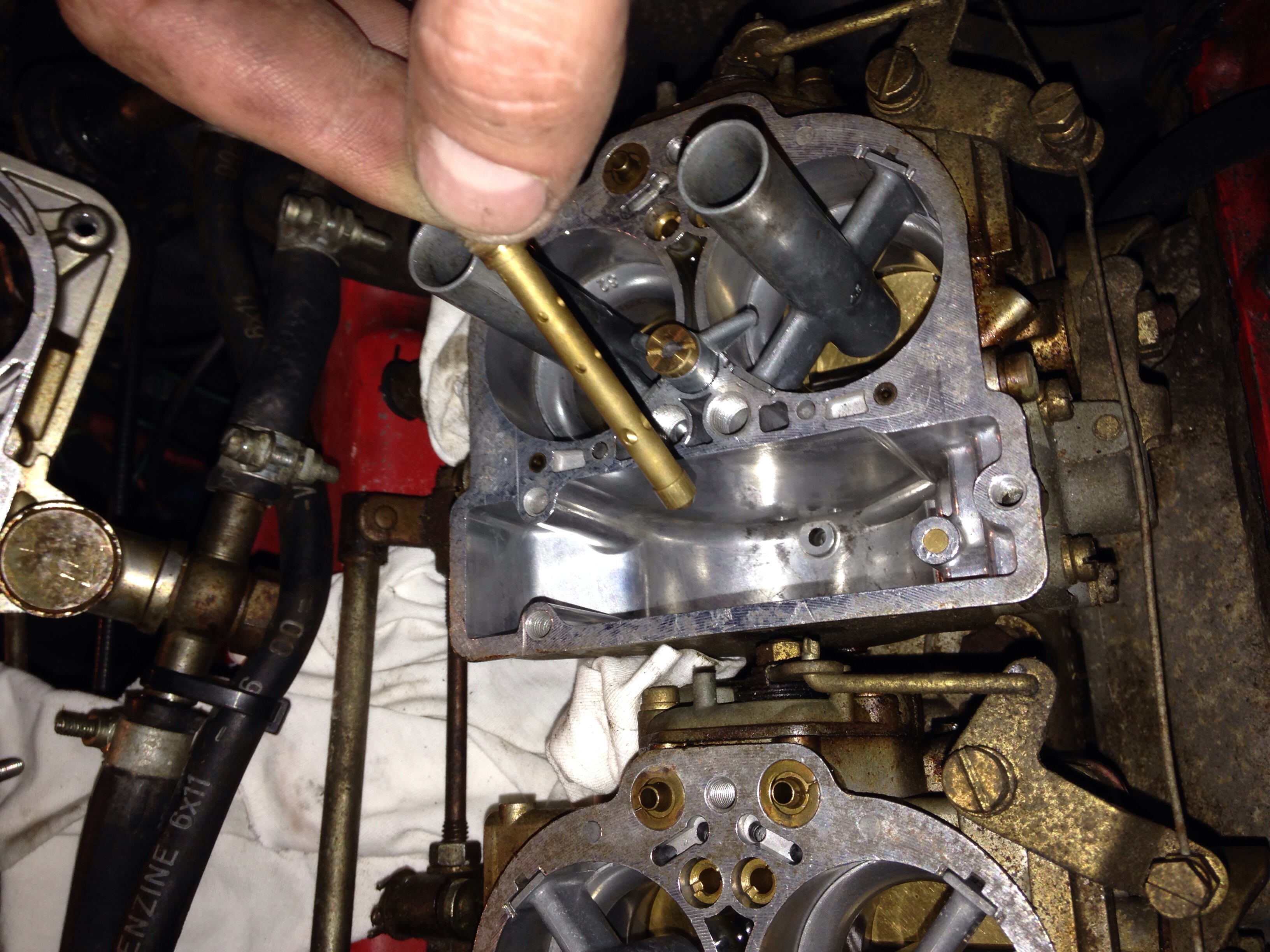

Over the past few days it has kept me busy:
-Cleaning grounds and adding ground cable to engine
-rewiring fuel pump
-checking valve clearance and camshaft lobes (good)
-checking engine compression (good)
-checking carb filters. (Bit dirty)
-opening carbs and checking: accumulated dust.
-cleaned all carbs. Started it again. It now sounds good. Time for a test drive.
