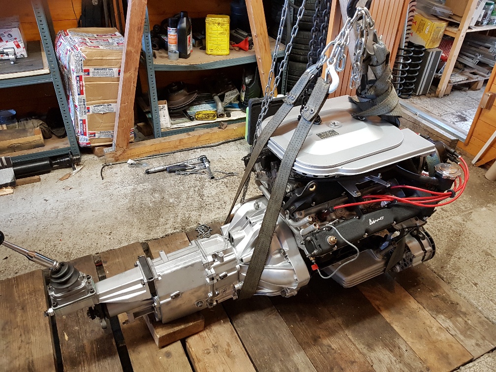

To the engine: I removed and installed already many engines. I do it always downwards, meaning lowering engine and gearbox as one part downwards. Of course I have the facilities for that and you have to remove the steering links but for me this way works very well.

For me, the best way to get the engine and gearbox out is from the bottom.
You must have a lift or a pit
It's all in one piece
Here is my experience and many videos do this like Mark Devaney classic Italian car restoration
https://youtu.be/WErUFFZ-1ug
Dominique

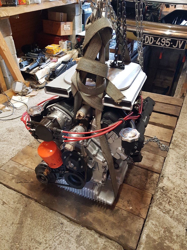

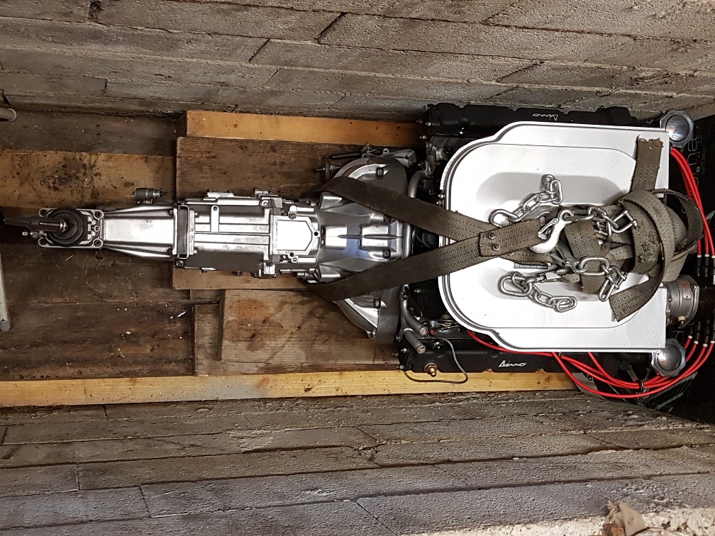

I need to get the engine out in the near future as well and assumed the from-the-bottom procedure requires a lift.
In the pictures above however, I do see the engine in the pit. I do have a similar, little wider, pit and wonder how to move the Dino back from above the engine, with the complete front suspension disassembled. Or is it just a few parts to temporarily dis-assemble and roll it back and forth on its own wheels?
Michiel
Michiel
Re: Coupe 2400 engine removal
Exactly. You mount the traverse where the engine sits on back on with four screws, the lower wishbone back on to the traverse with the two screws and stick the steering linkage back together, then you can put on the wheels and roll the chassis. You don’t need to put the anti roll bar back on to move it. Move it carefully as the propshaft rotates when moving.

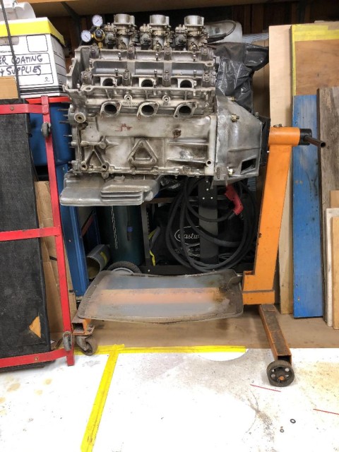

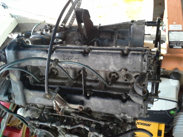

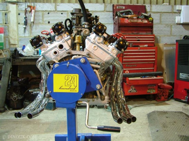

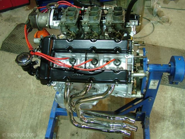

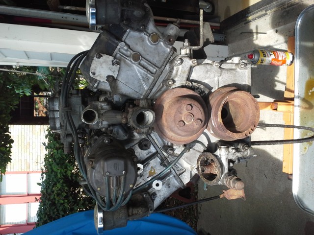

Next question is...

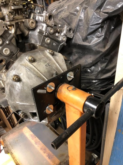

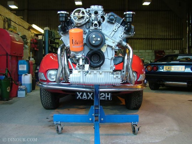

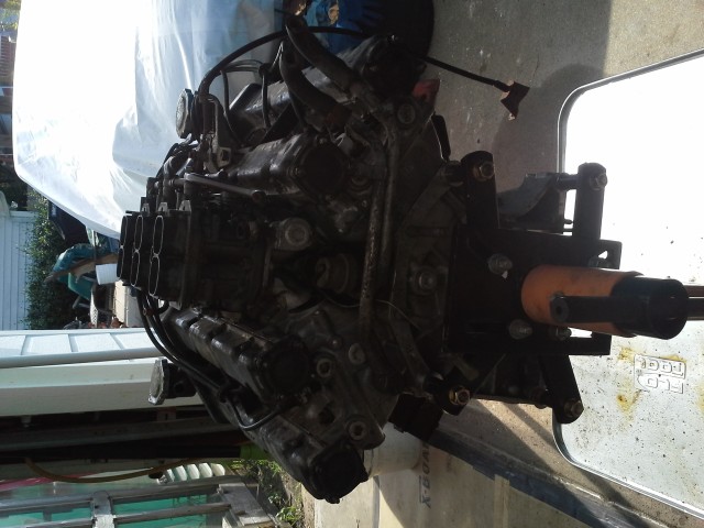

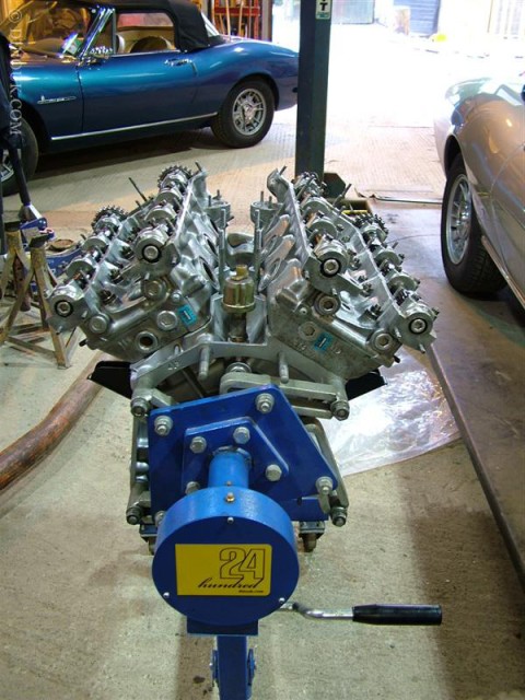

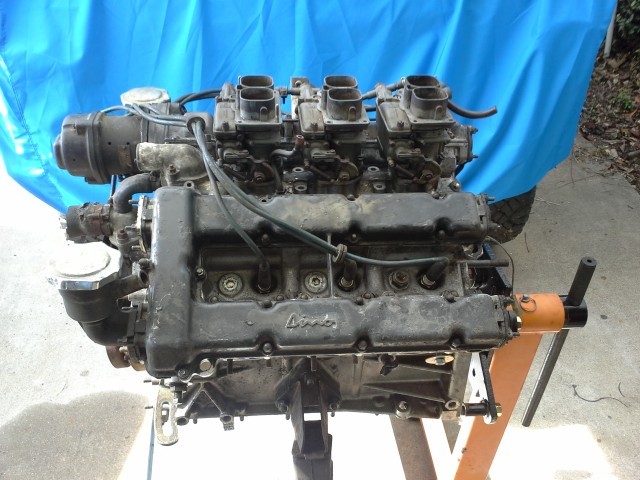

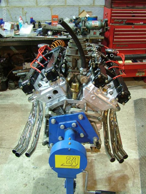

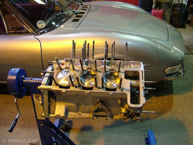

How does everyone mount the engine on a stand to work on it? Is the clutch end strong/safe enough to hold the engine in the usual way? Or is it better to support the engine from either side at the engine mounts?
if anybody's got pictures of how they mount a Dino engine on a stand, that would be very helpful.
Hi Richard,
I was looking for a picture but somehow did not find one…
Unused to mount my engine on the engine stand with four M12 bolts on the clutch side of the block. Strong enough and then you can also rotate the engine, at least on my engine stand.
KR Thomas
KR Thomas
