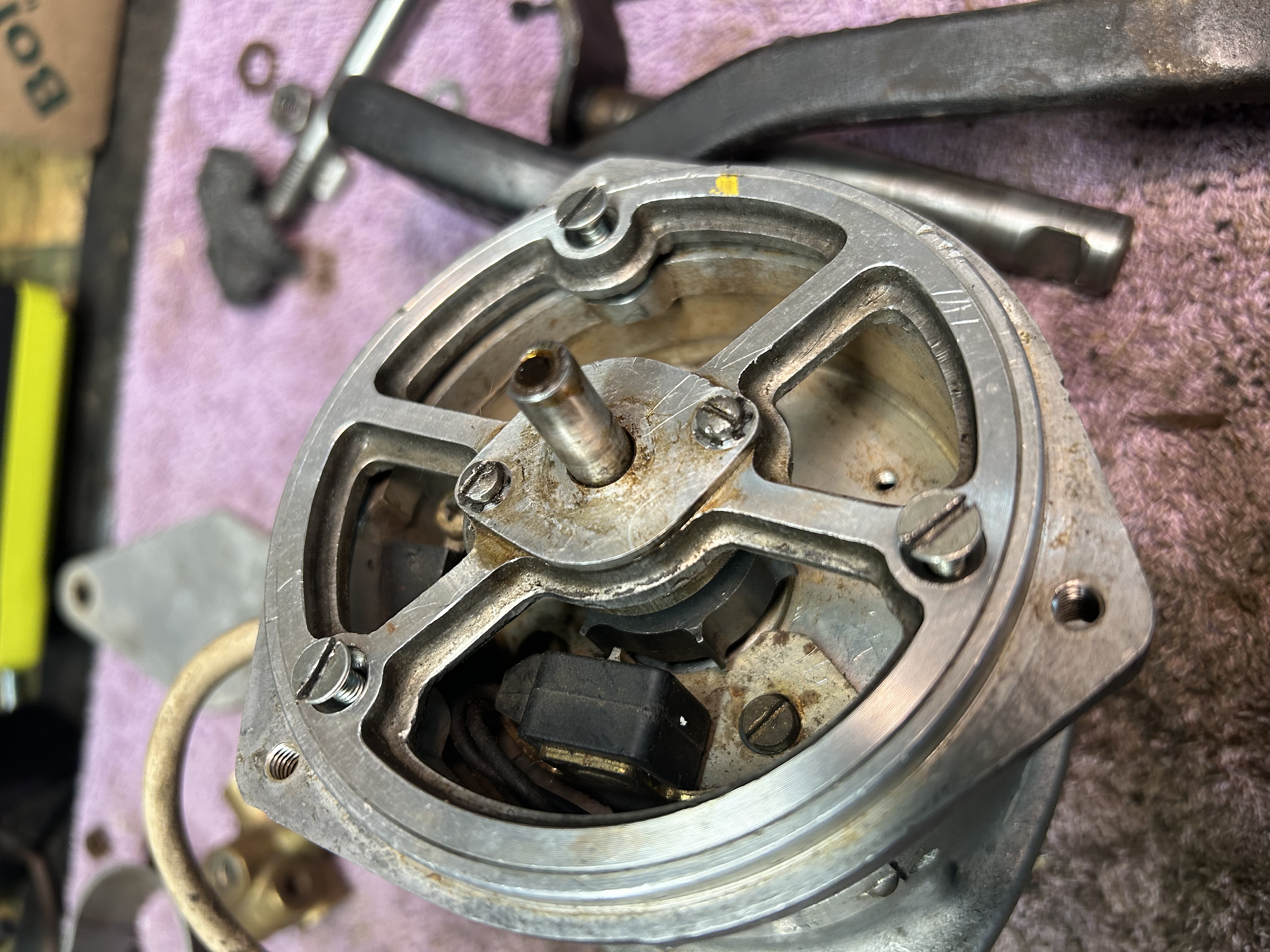

Tonight, I checked the primary and secondary of the coil (in spec), checked the ground, and hot to the MSD. Re-made the connection on the main power (heavy red) wire to the unit for good measure. Then, took a test drive.
Cooler than before. However, this trip around the neighborhood resulted in three failures in the space of 20 minutes. The problem is getting worse. Each time, all electrical power stays on in the car, but the engine dies. It re-starts immediately. I don't think it's fuel.
To the idea of testing the MSD on the bench: Who does that?
