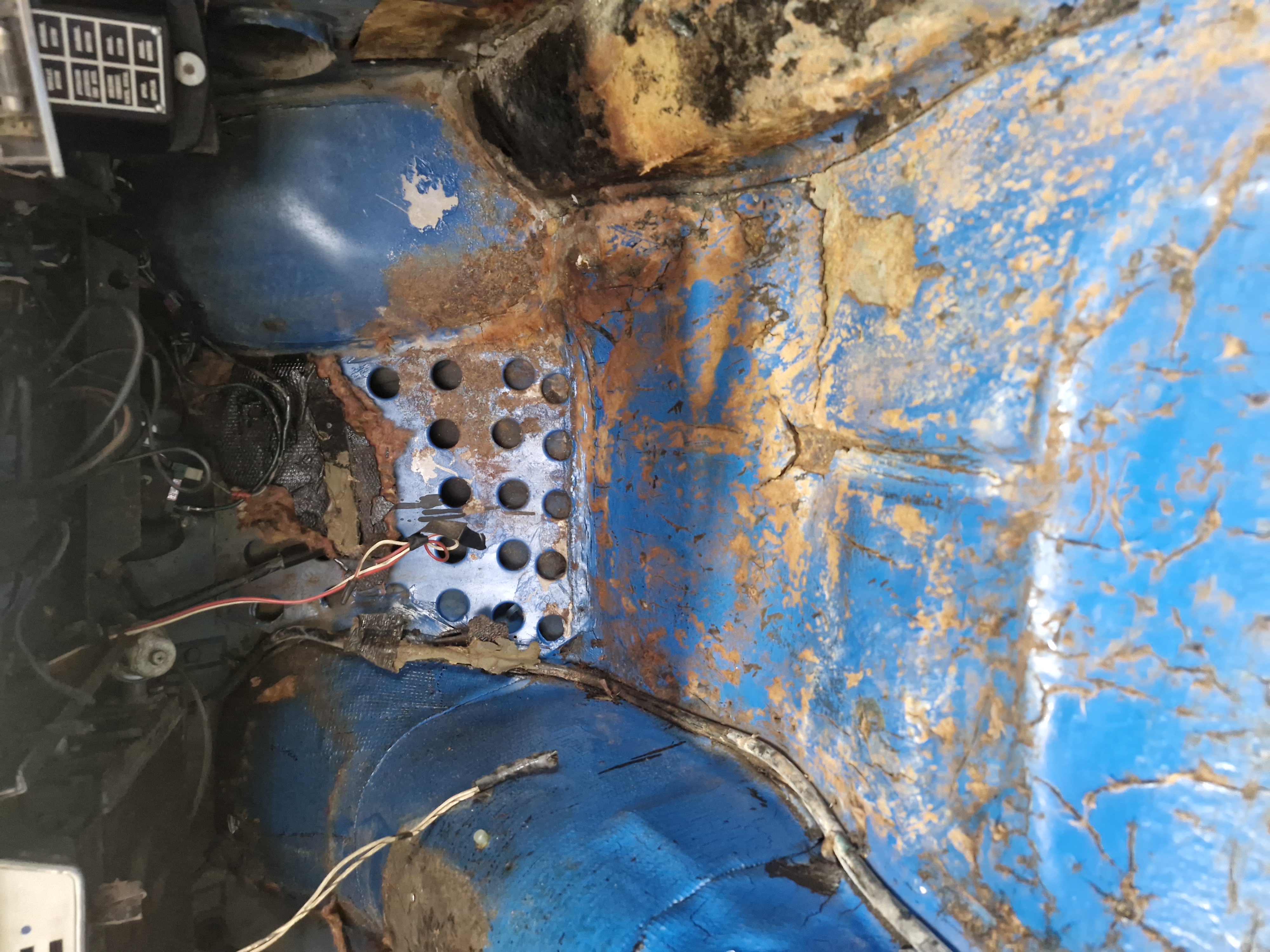

Hi another question if I can
Did all early Dino spiders have a welded in foot rest like the one pictured in the passenger floor ?
Our vehicle is LHD 2.0 1968 but I have seen images of other vehicle in restoration without this panel in the passenger footwell.
Can anyone share some information.
Sorry image is on its side
Thanks in advance

Bonjour,
Oui, les premiers modèles de Fiat Dino Spider 2000 "1ère série" ont cette particularité.
Voir les deux vidéos à ce sujet de Mark's italian garage sur Youtube, dont voici les liens :
https://youtu.be/hv-UBfnUinQ?si=sSJop12HtrMDF2KT
https://youtu.be/bX9Vy8_HxI4?si=LKLy-onoLC5X2Fdi
Bonne restauration !
