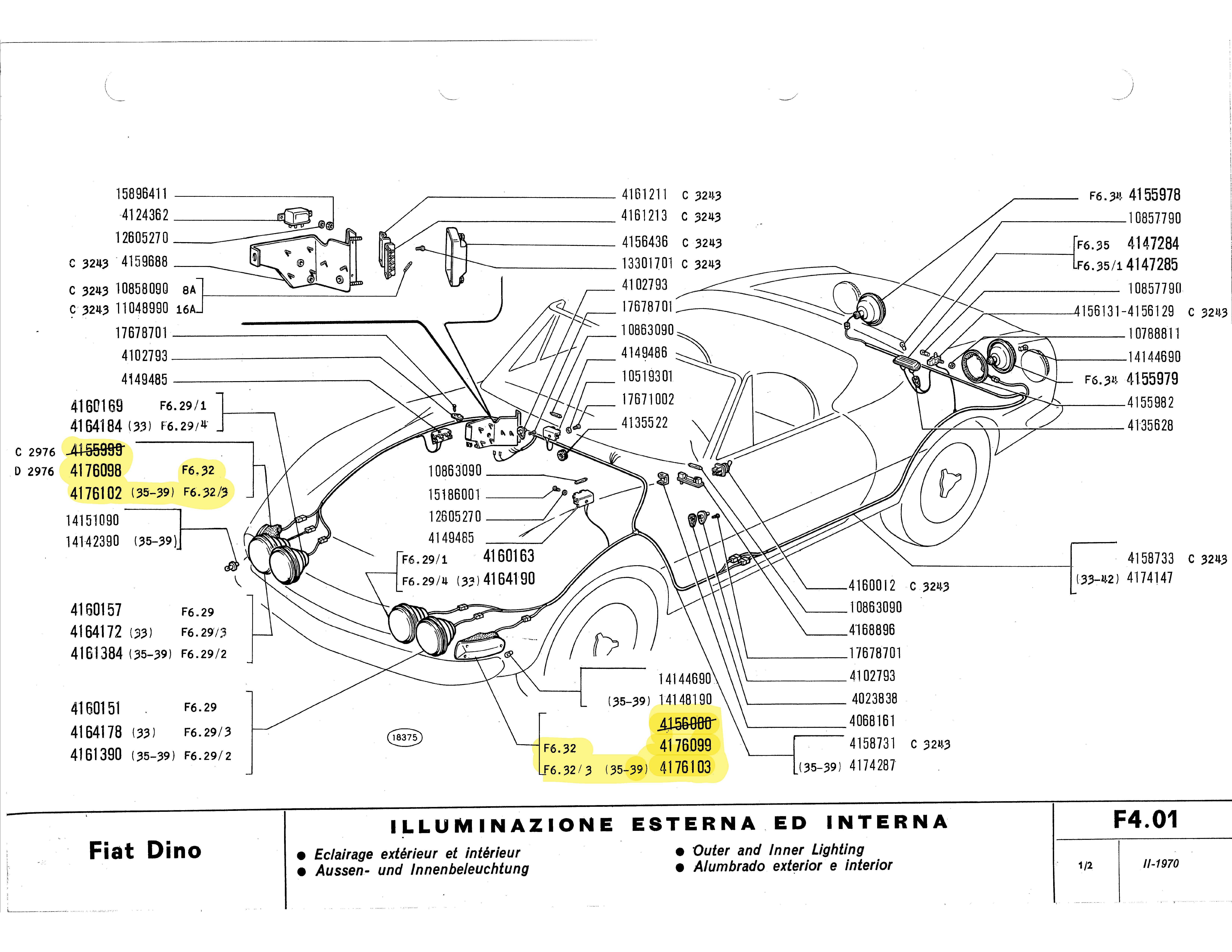

When you then look in the catalog, there is actually 3 variants of the front position lamp & indicator:
4155999/ 4156000 - This is the lamps used up to Ricambi no. 500, specified as Modificha C2976 in the catalog.
4176098/ 4176099 - This is the lamps used from Ricambi no.501, specified as Modificha D2976 in the catalog.
4176098/ 4176103 - This lamps are marked with (35-39), so intended for the German & Danish market:
In the chapter F6.32 & F6.32/3 there is specified different part numbers for lenses on the D2976 version, but in the text description they are both described as "Trasparente"!
F6.32 - 9917480 d/ 9917481 s
F6.32/3 - 9918782 d/ 9918783 s
So some of the mystery continues :shock:
