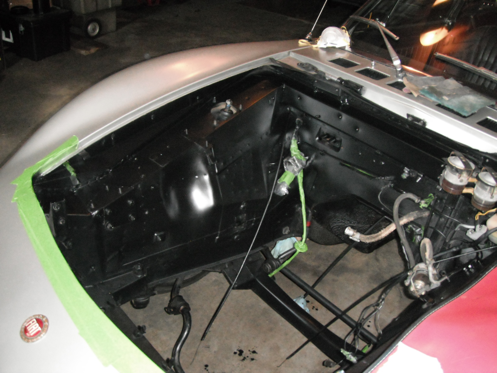

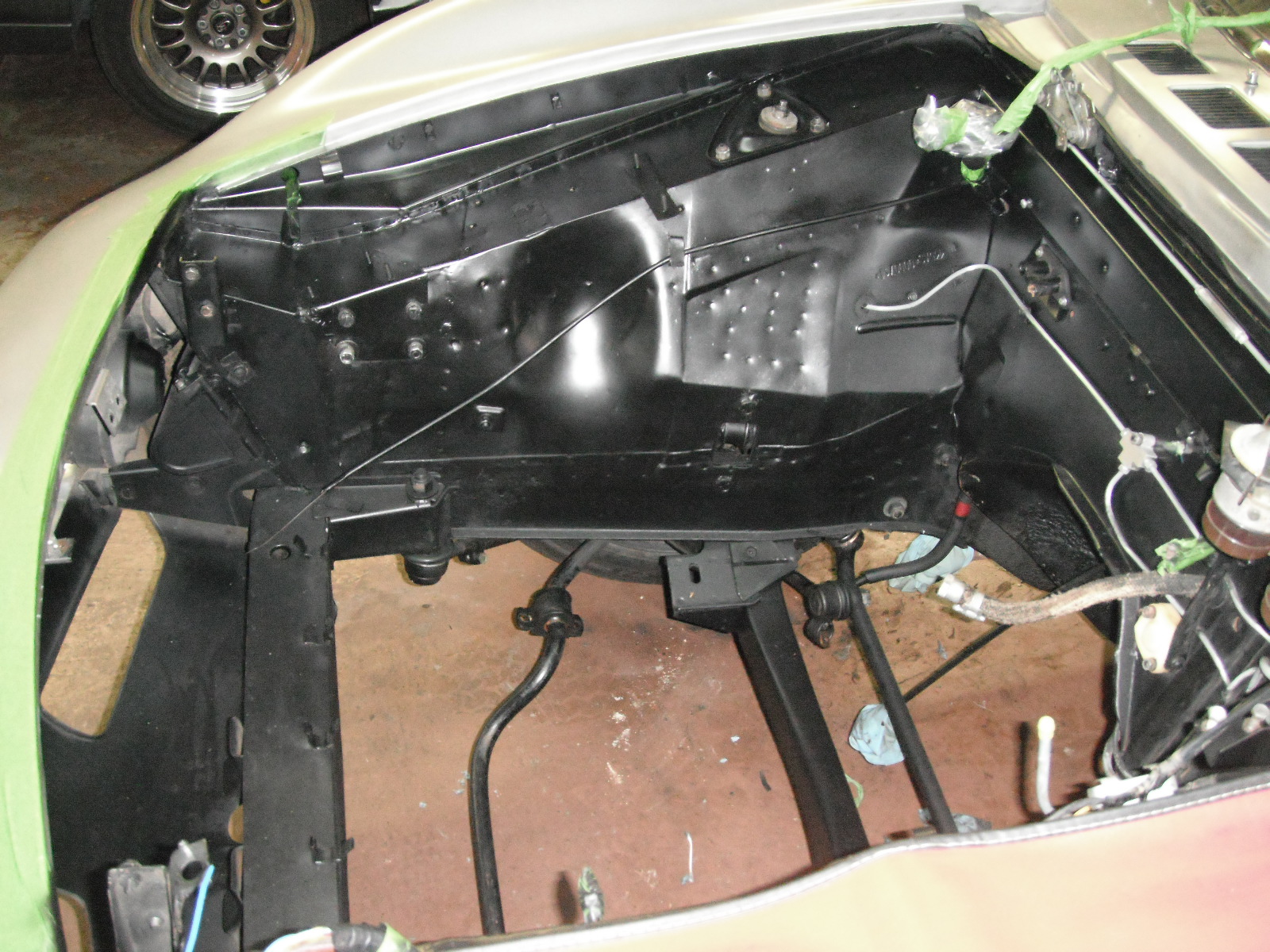

Engine bay has been painted and is almost done being detailed for recommission. The looms, hard lines, and other bits.
Sanding between coats

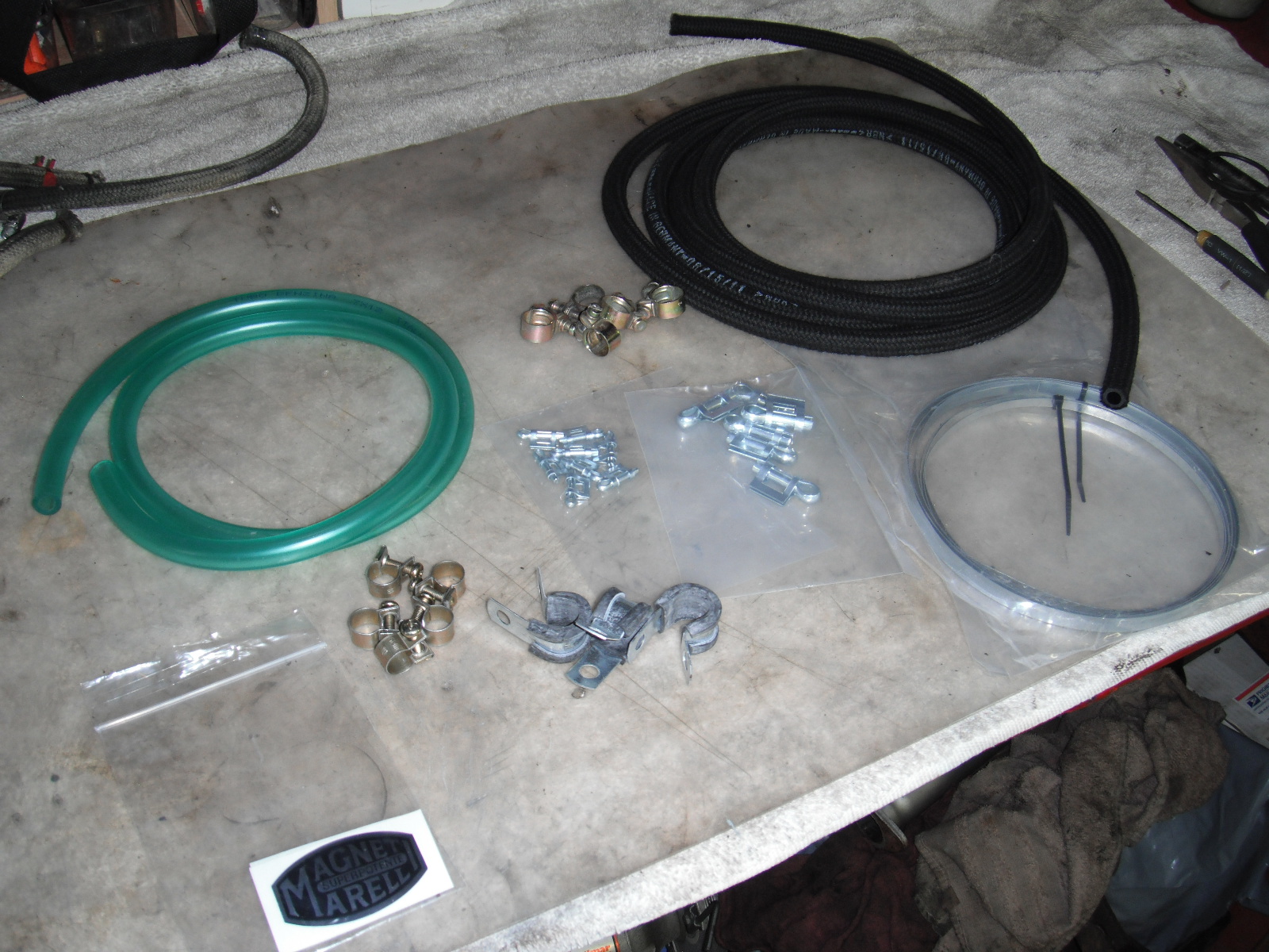

Also sourced some new braided cloth fuel line, Cavis green fuel line, various smooth-bore hose clamps, new loom clamps, new cotter pin clamps and banding, and a few other things. New and NOS parts are fun.

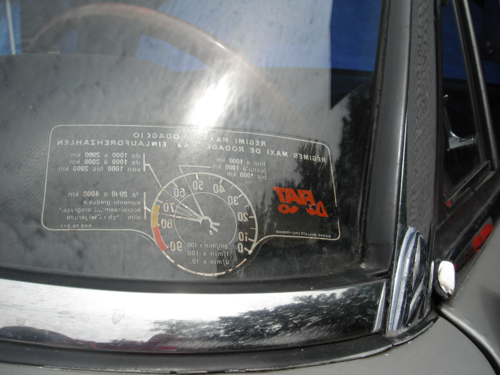

Original break in sticker. Where can I get a reproduction?

Hi, with regard to that sticker/decal I suggest you tape a thick white piece of paper on the inside of the glass to make the image stand out. Photograph it in high resolution, avoiding any reflections. Try to get the camera perpendicular to the curvature of the image. In Photoshop it will be not too big a job to reverse the image, repair any distorted or missing bits and approximately "flatten it out". Providing millimetre correct dimensions will help too.
If you post such a photo and dimensions I'm happy to have a go at it in Photoshop and repost an image you could get made into a decal

I would really great if someone would make the Breakin Sticker!
Is there one out there that can be replicated?

I can do it. If anyone cares to give me the size of the original width by height.iceblue wrote:I would really great if someone would make the Breakin Sticker!
