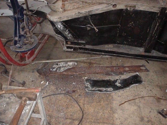

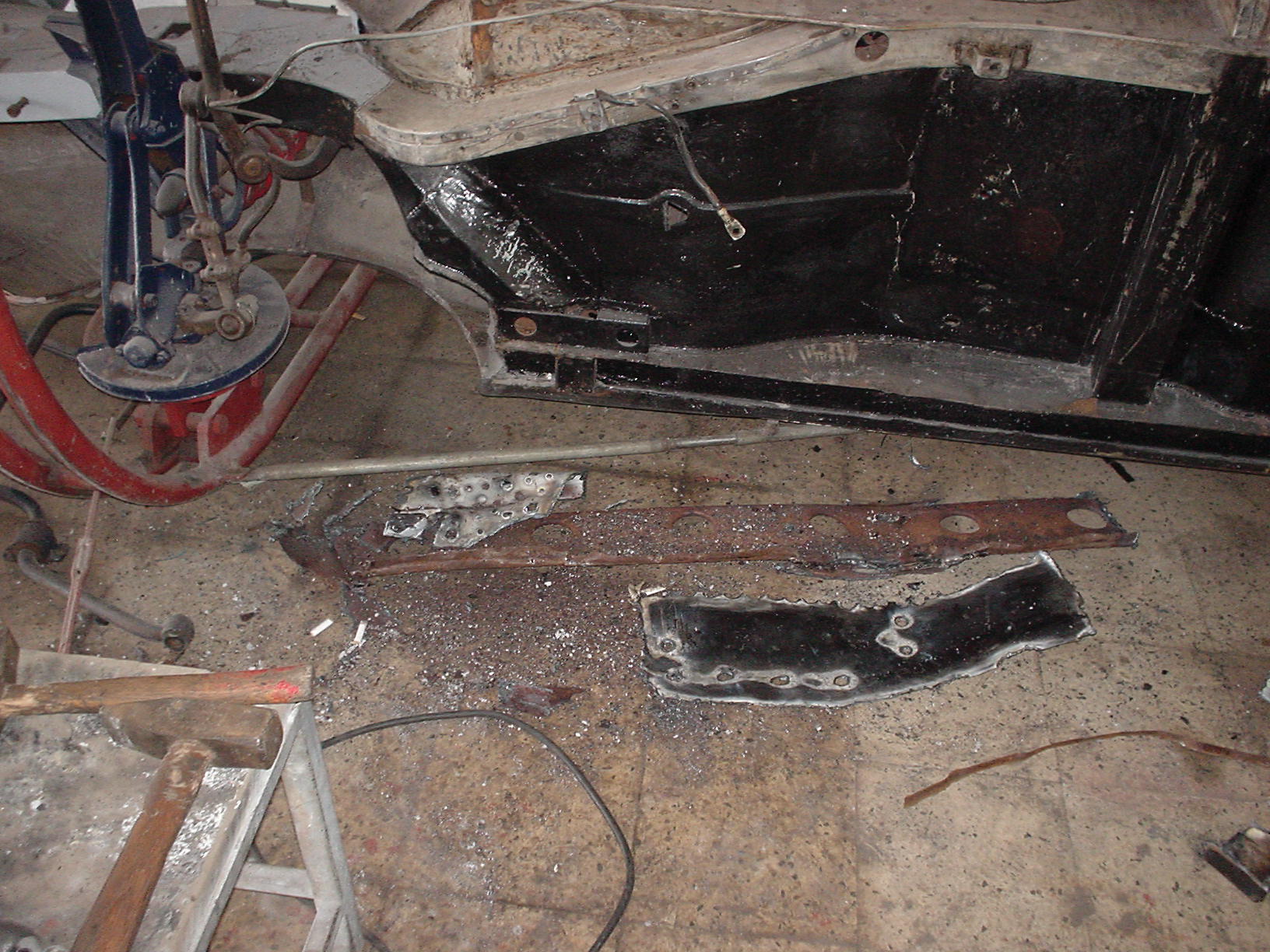

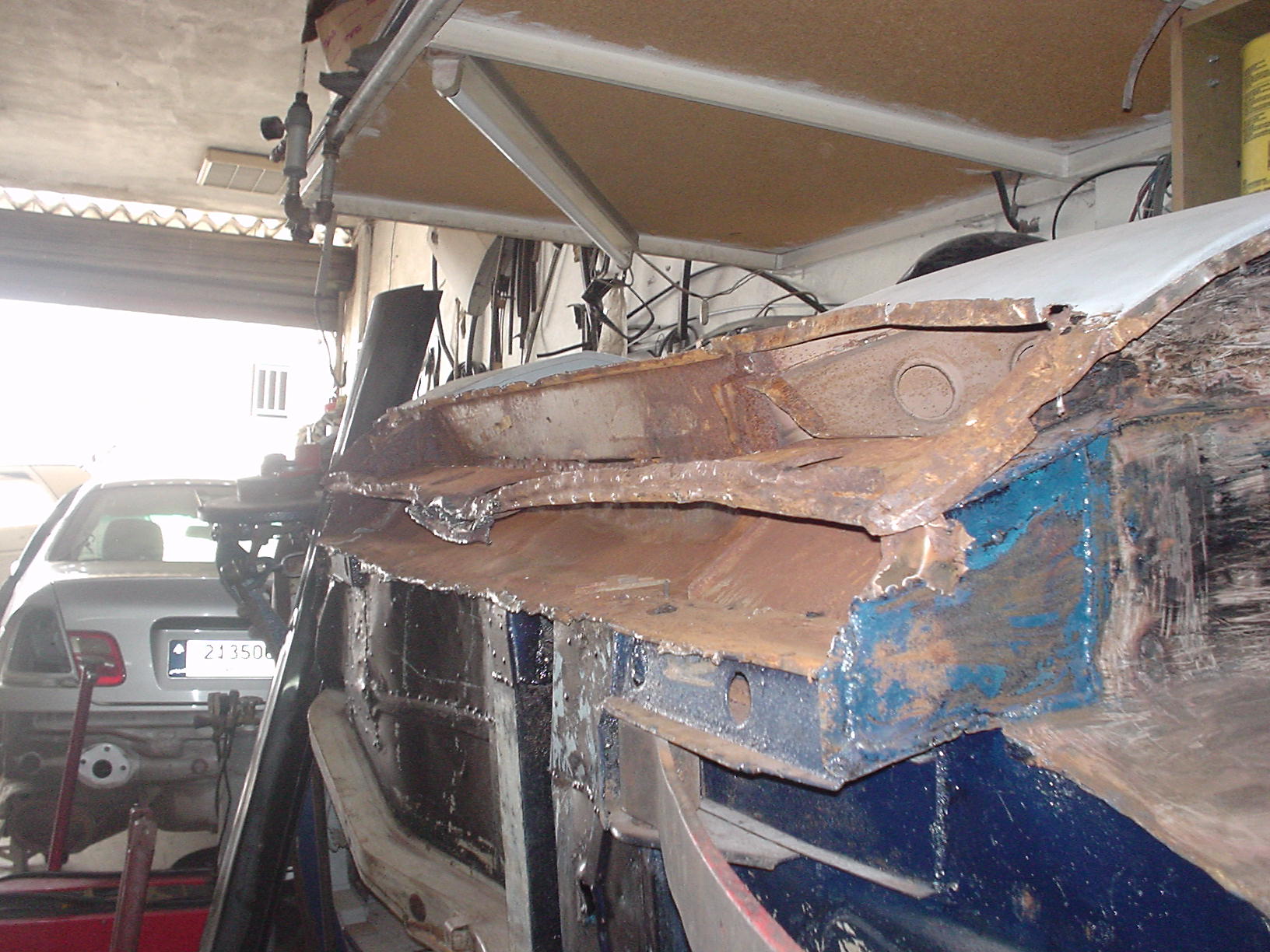

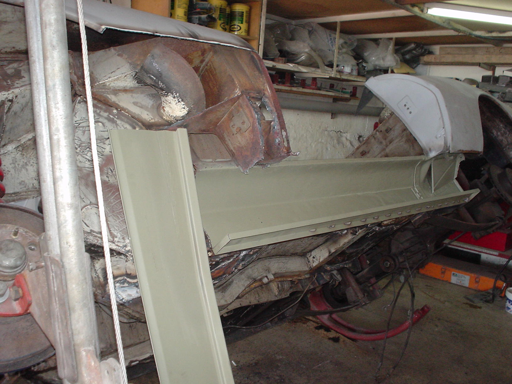

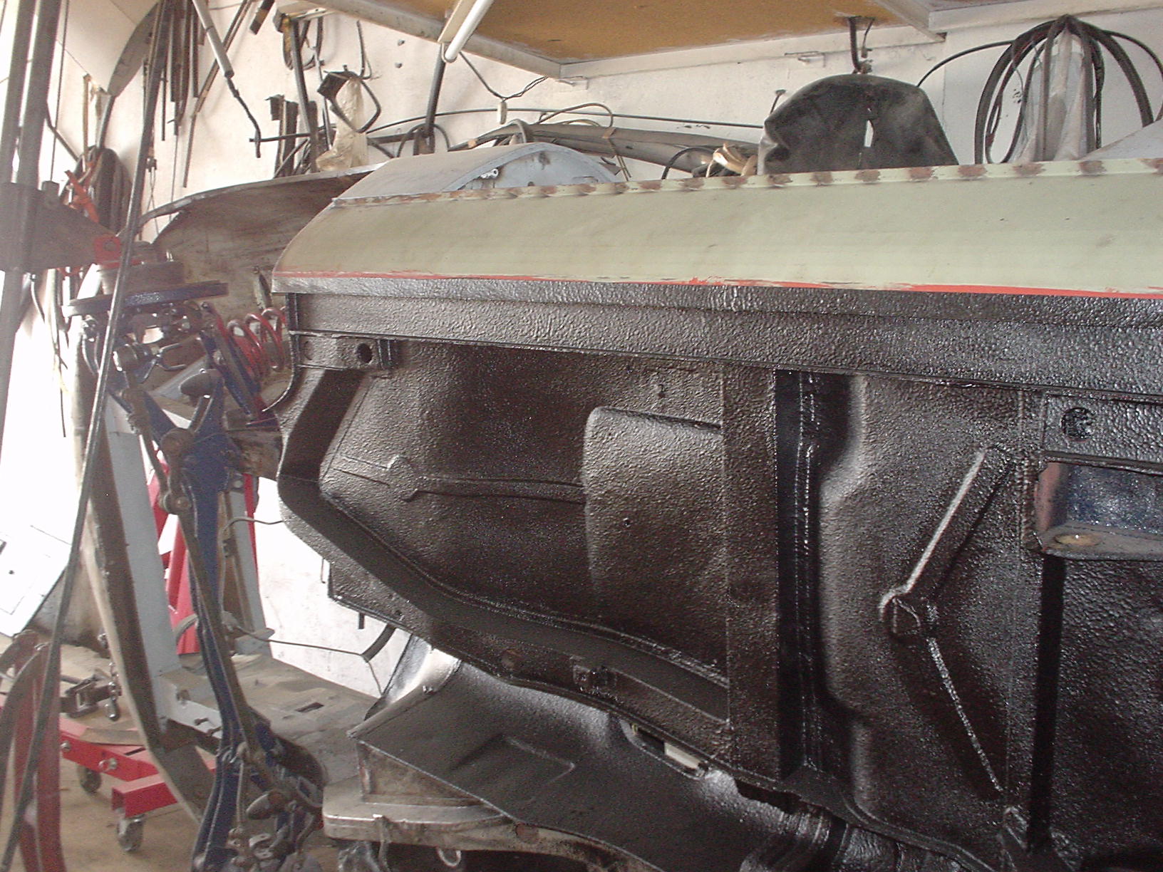

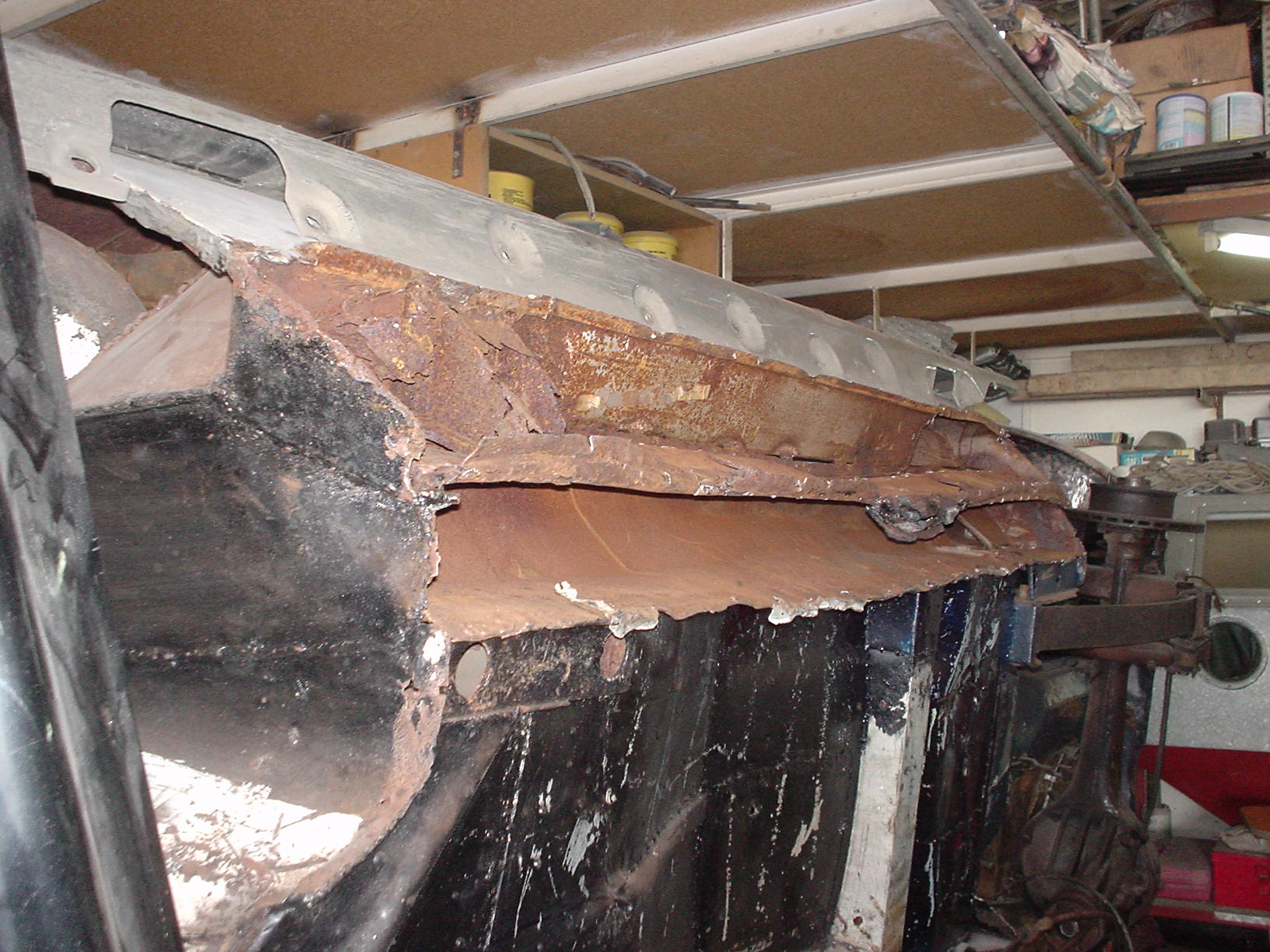

OK here are some pictures of the body. Pretty nasty rust everywhere...
						Re: Rebirth of a Dino
What I mean by nasty rust is rust UNDER rust. Plus botched old repairs (you can see Frankenstein soldering jobs in some of the photos).
That meant stripping the whole body bare on a rotisseries, and then peeling it layer by layer. Since no panels are available, we had to recreate many of them from scratch (we used a slightly thicker and better grade of steel for the load bearing parts)

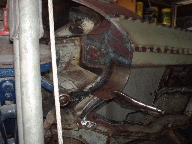

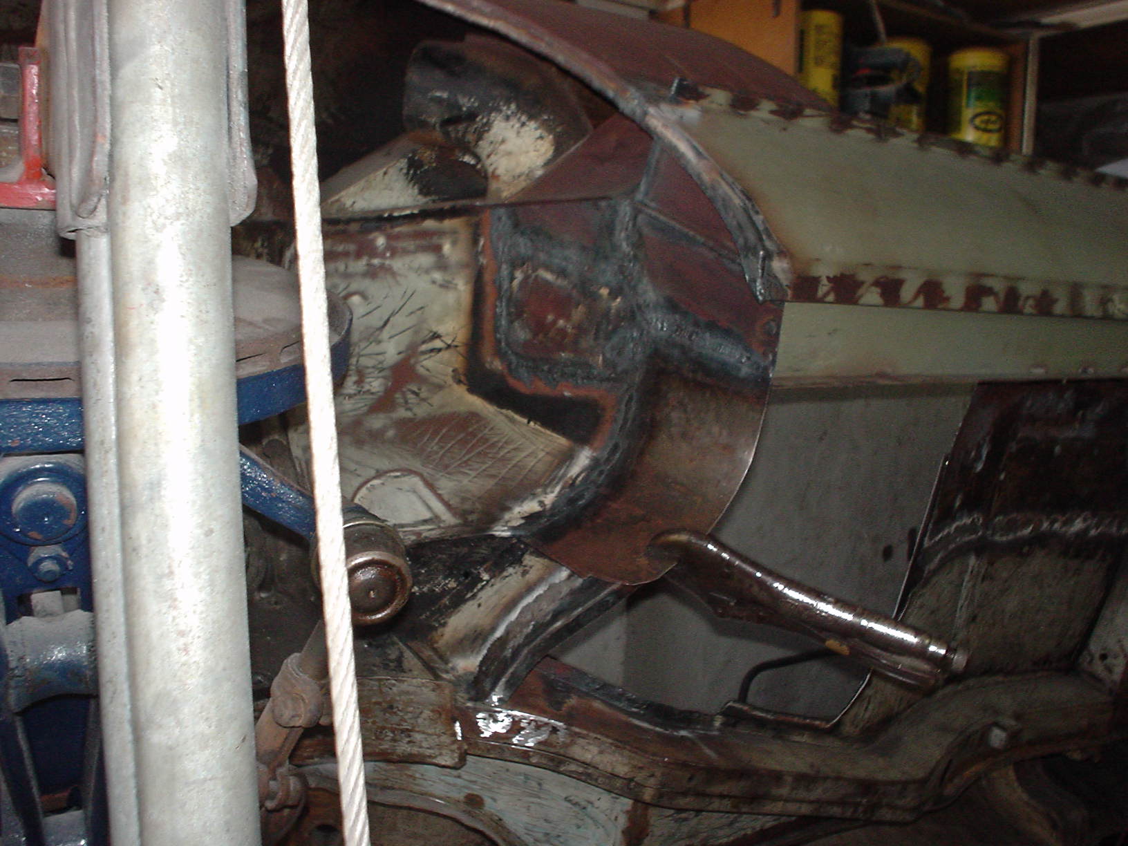

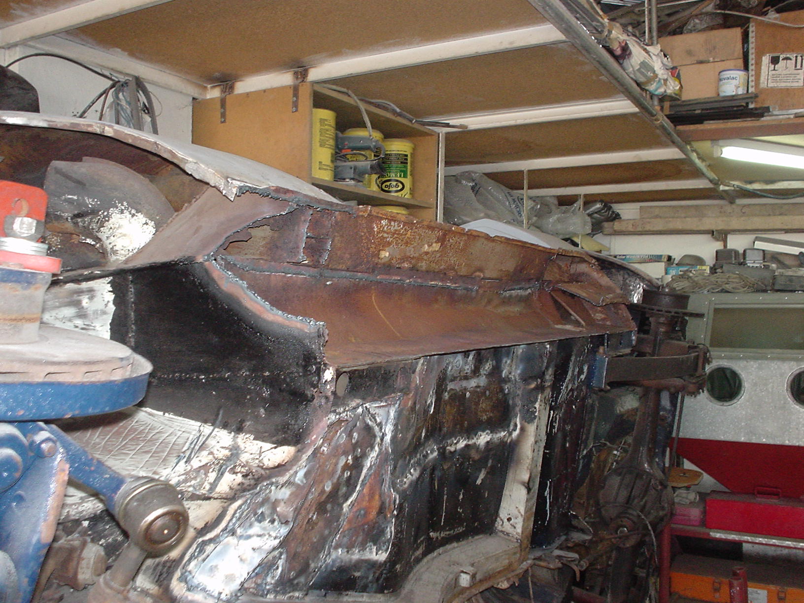

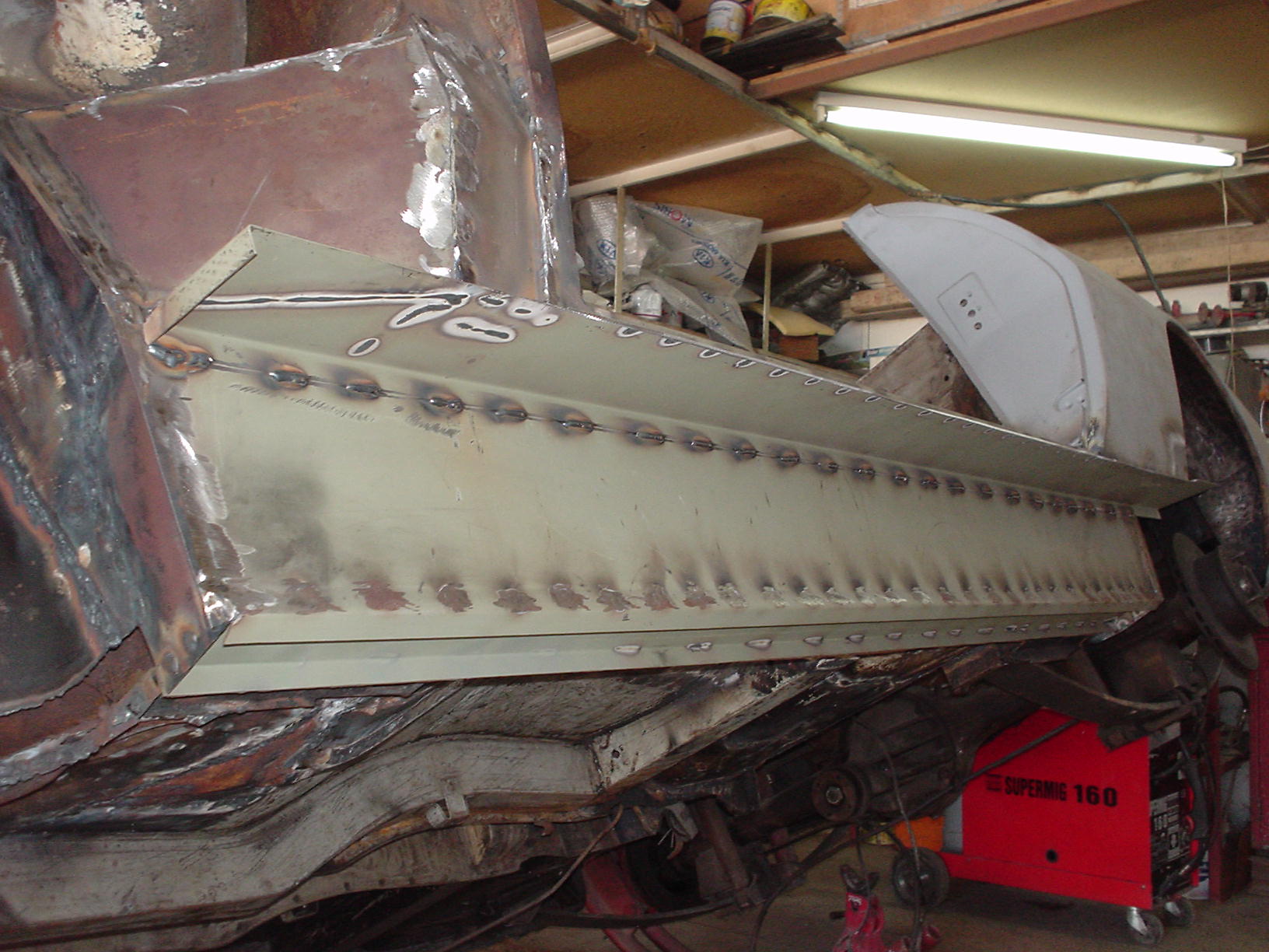

Here is some deep surgery
Hi Zorglub
You are doing a great job , but i cannot recognize any stiffenning.
Remember the Dino-chassis is very soft. Deformation can cause a lot of problems later, seen in my Dino Spider
years ago. Good luck Dirk
