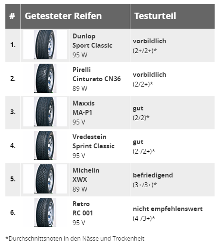

Well, the 2016 result is clear - first place for CN36 and third for XWX
In the meantime, there was another test executed with a Mercedes SL 107 - winner was Dunlop Sport Classic, but this is a new design in 1995 style.
https://www.autobild.de/artikel/reifen- ... 38661.html
Autobild Klassik Mrcedes R107 SL
CN36 was on second rank, so for me it is the best tyre with classic design- and it was specifically developed for the Fiat Dino.
The new CN36 was developed in cooperation with Porsche Classic and Walter Röhrl, but nevertheless it fits to Dinos perfectly - and I like the original look.

Thank you for all those tests, Ribolla.
For me, personally, I am wondering a bit as the Michelin were always the desired equipment in the forums for the past 15 years. Also, I did not know that the Pirellis were the first choice while releasing the Dinos.
