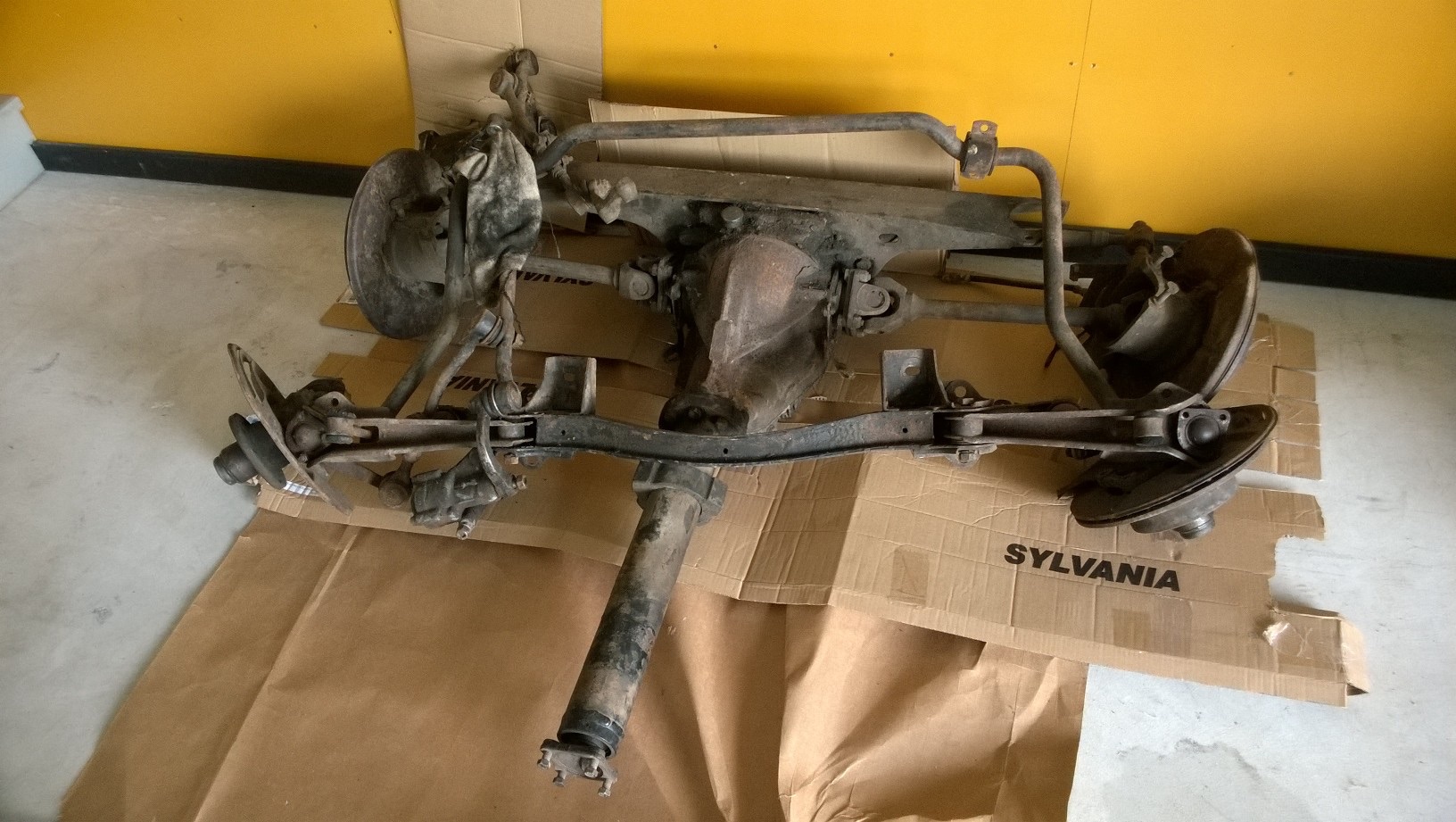

I have lots of spare parts which came along car. For examble all gauges, two rounds hedlights (clear and yellow), wood trims, ignition unit (early), 5 magnesium wheels, window trims, rear schocks, complete rear and front chassis etc..
Are these worth something?
Posts: 578
Re: Dino 2400 Coupe -71
JPohja wrote:I have lots of spare parts which came along car. For examble all gauges, two rounds hedlights (clear and yellow), wood trims, ignition unit (early), 5 magnesium wheels, window trims, rear schocks, complete rear and front chassis etc..
Yes, the differential gear is definitely sought-after. Also the ignition and trim parts. Keep them! Don't scrap anything.
