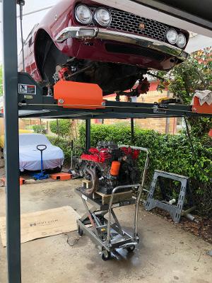

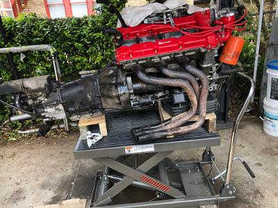

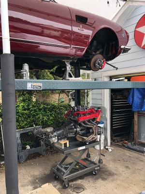

Thanks to doublegarage [Richard] for the suggestion of the hydraulic lift table. It worked great.
I fortunately did not need to make a head puller tool.

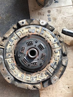

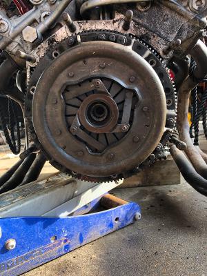

My car started easily, idled well and seemed to be a decent driver. I dropped the engine and transmission together to work on the clutch and also to try and figure out where my oil losses were. The engine was excessively burning oil and also leaking oil, mostly while driving. I didn’t really notice the oil burning when driving, either inside the car and I didn’t see any plumes of smoke coming out the exhaust but when idling in the driveway, the burning oil was severely irritating my eyes.
My diagnosis of a worn out clutch was correct. There was zero clutch material left on the pressure plate side of the clutch disk.

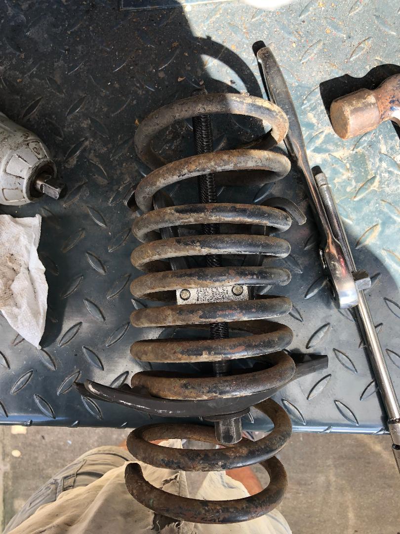

9. The front coil springs were difficult to remove. I tried my McPherson strut style spring compressors that work on the outside of the springs and that didn’t work. I rented another style spring compressor from the local autoparts store that went inside the spring and that worked, but I still had to man-handle the springs more than I would have liked. I usually restore [paint of powder coat] everything I take off a car before it is put back on the car. Is there a type/brand of spring compressor that works well on the Dino? Fully extended, the spring is almost 24” long but has to be compressed to <12” to get it off the car. I would hate to refinish the springs only to scratch them up on reassembly.

I do not have personal experience (yet, on the list...), but there is a post on the forum with pictures showing the spring compressor type which supposedly works well for the front springs: http://www.fiatdinoforum.org/viewtopic. ... ssor#p3957
Re: 2400 Coupe engine rebuild

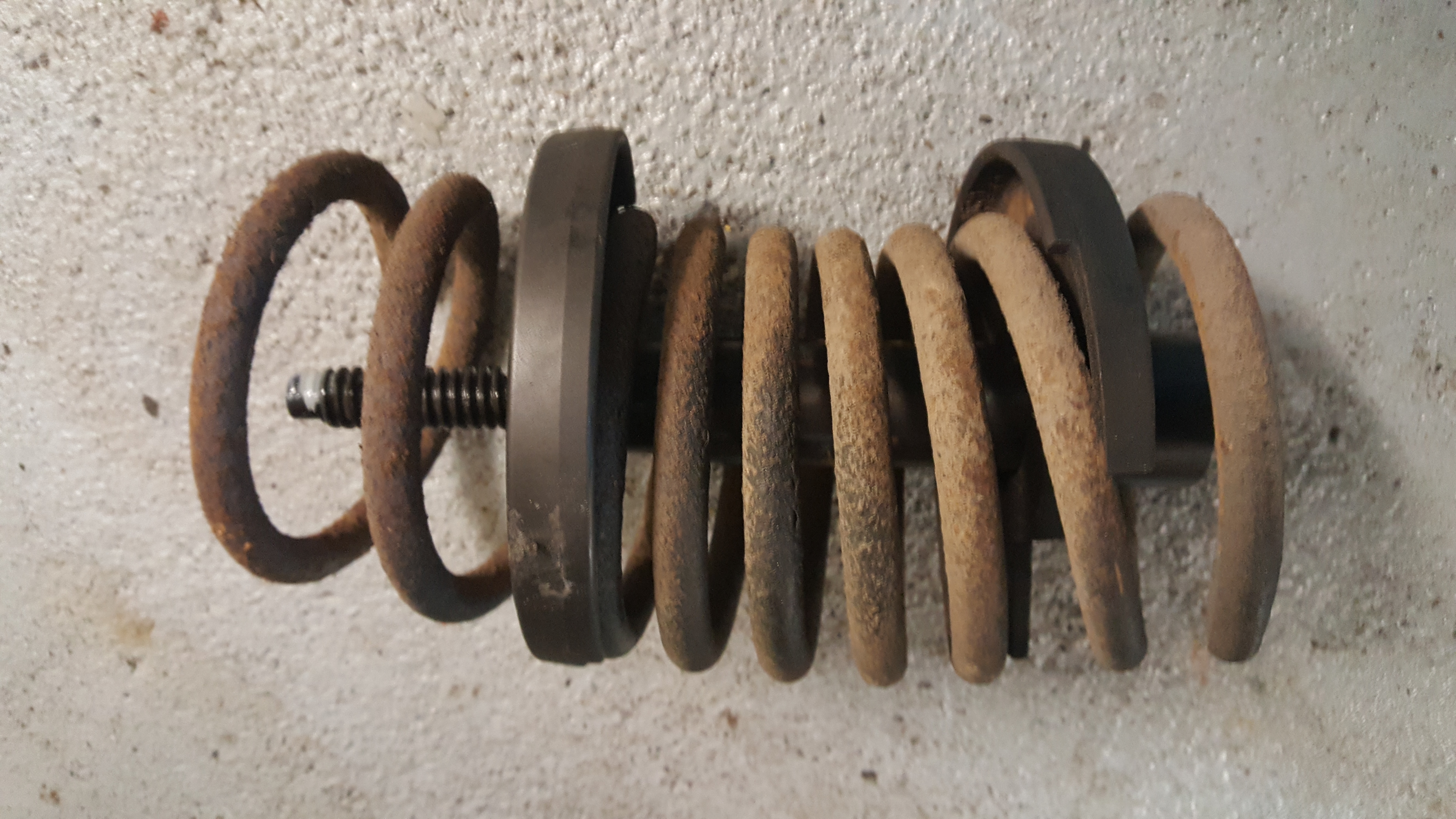

Right, you need these inner spanners with the "plates" and then to Place them as much up and down as possible - then it works very well.

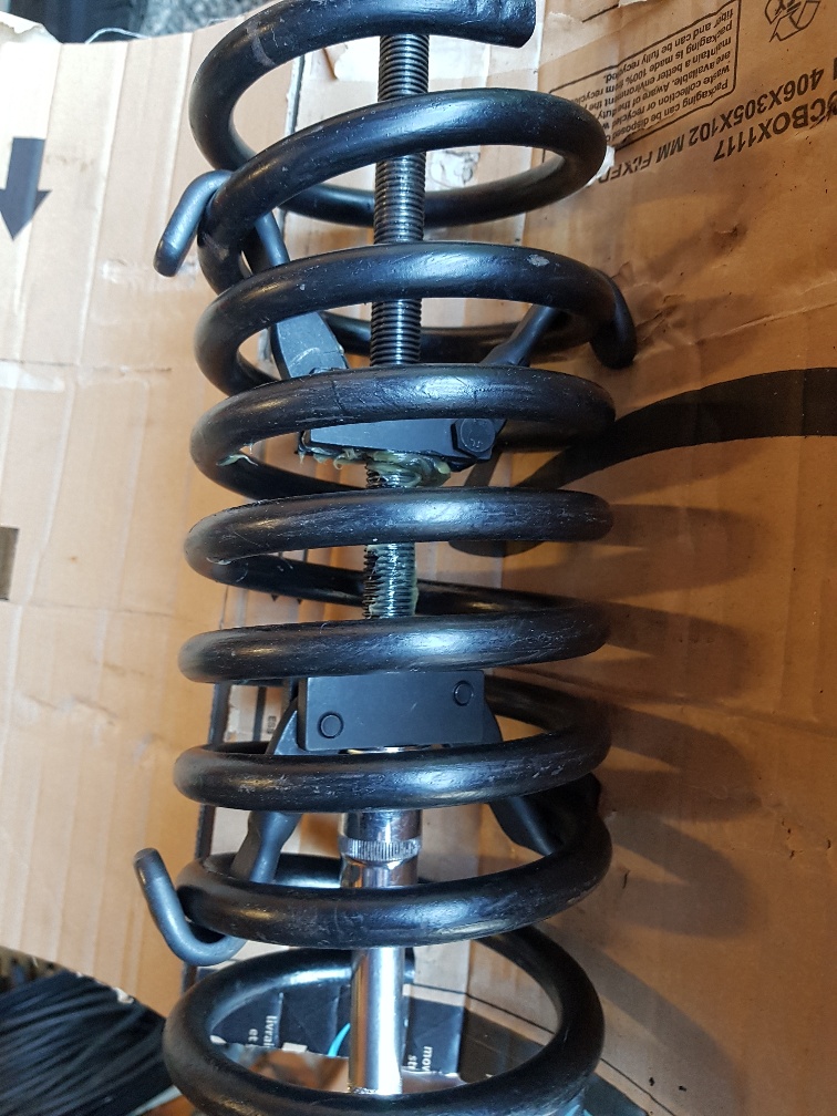

Here is my solution which works with our Dinos
The compressor is cheap and vey easely found on the net
I hope this helps
Dominique
I hope this helps
Dominique

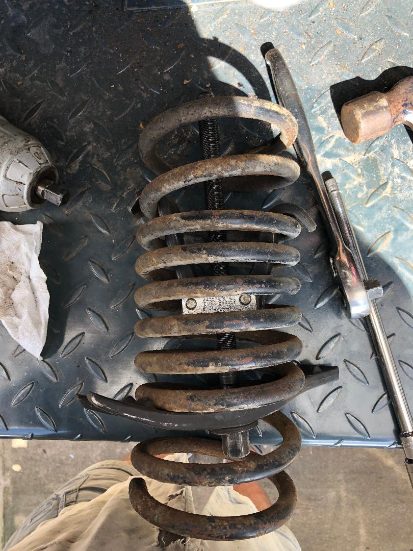

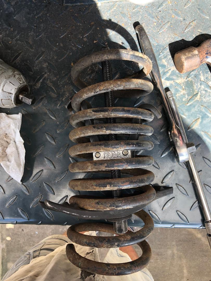

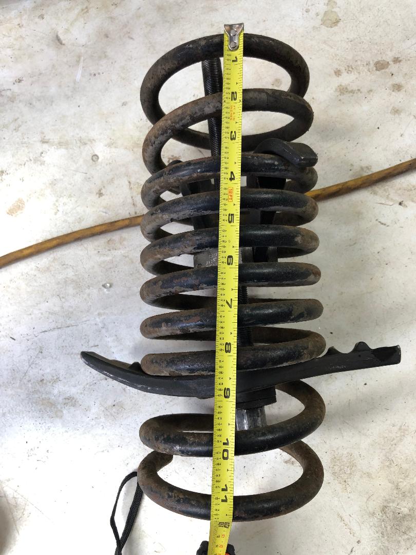

Thanks to those who replied about the coil spring compressors.
The one I used to get the springs off was sort of a combination of the two models you shared. Photos attached. The issue was the lower portion was on the thick side and I had to pound it in between the coils to properly seat and even then, it barely compressed enough to get the spring out.
I ordered one of the style with the steel disk at the top and bottom and will I see how that works.
Ben.
Ben.

Good to see your engine out and on the same lift-cart I used from HarborFreight.
9. The spring compressor shown by Dominique was the version I eventually used successfully - but that was after having bought 3 others that were pretty hopeless - 2 of them dangerously so. I think the main problem is the springs (on a 2400 anyway) being recessed up into the bodywork with the top coils shrouded by sheetmetal - so you can't get to the top of the spring with the typical external compressors. The type that goes inside the spring is the way to go.

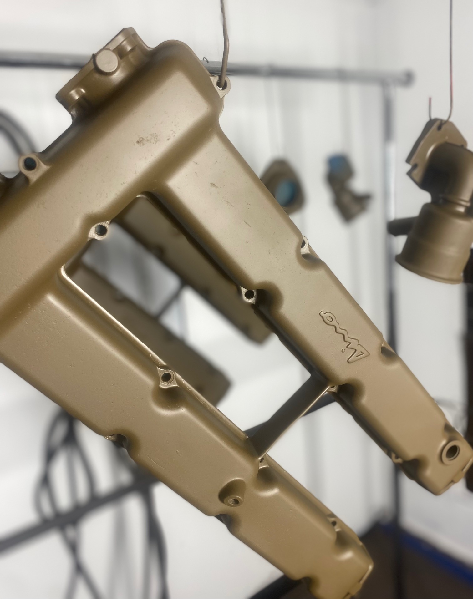

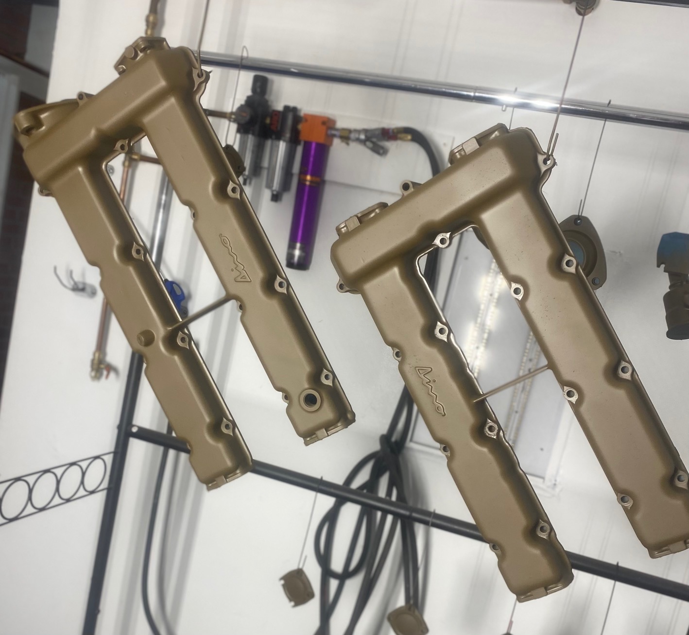

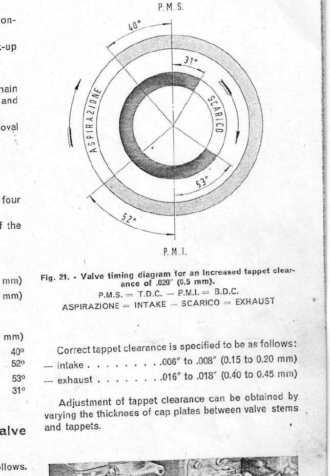

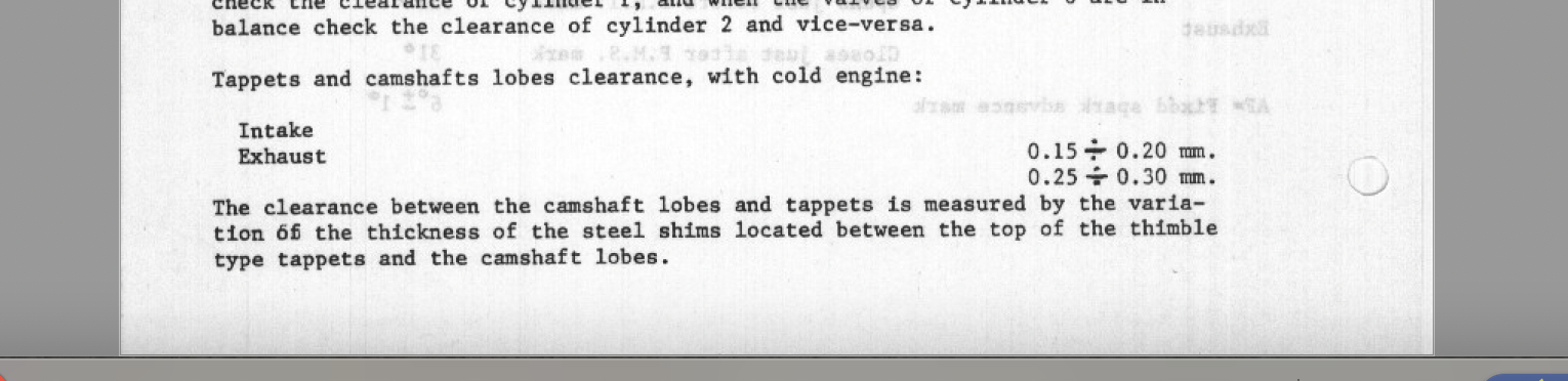

My engine (2400 Coupe) is finally coming back together after various showstoppers along the way. Most of them caused by incorrect or poor quality parts supplied. But those problems are now resolved, I think.
The heads have been reconditioned (needed lots of welding to mating surfaces), valve job etc, Therefore I needed to reset valve clearances and did that months ago with the heads on the bench. Now that they're on the block and torqued, I'm finding that the clearances have tightened up - many of them are at (or beyond) the low end of the spec.

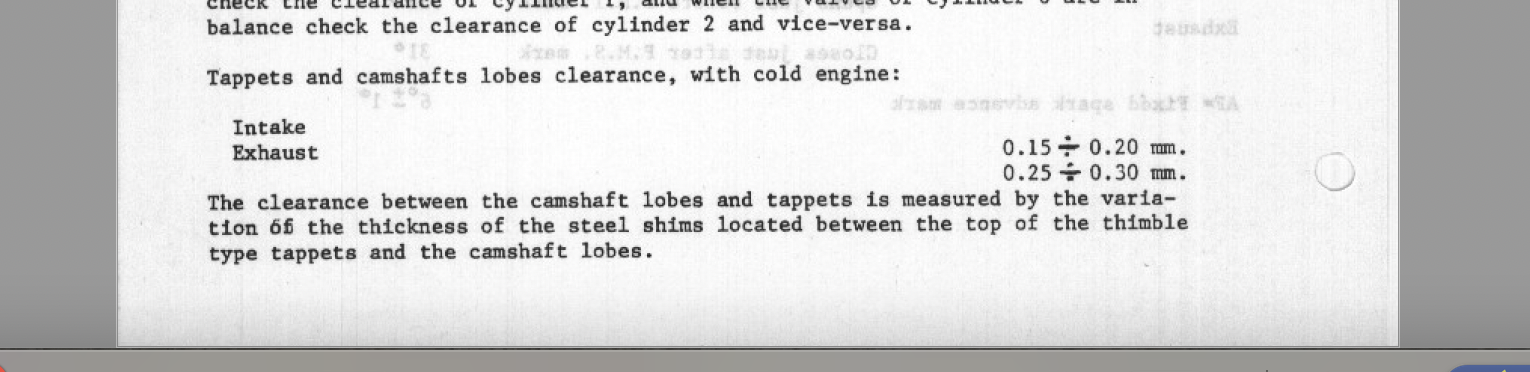

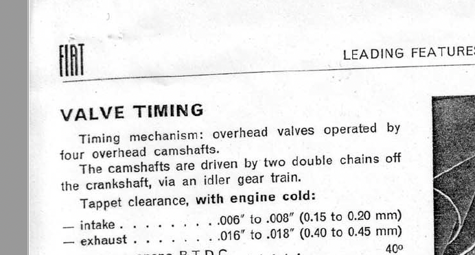

For instance - on one cylinder, the intake lash/clearance spec is 0.15-0.20mm. MIne is now sitting at 0.14-0.15. The shims are sized 0.05mm apart - so my choices are 0.14-0.15 or 0.19-0.20mm. What would you do - my 'thought' is that the clearances will tend to tighten over time - as the valve "settles" into its seat, therefore I should increase lash closer to 0.20mm But I'm not sure whether that's a good assumption? When I did the shims originally it was about 50/50, some too tight, some too loose. But that could just be bad maintenance. what do you think, where do you set the valve clearances - large or small?
Hi Richard, calve clearances are be defined in the Fiat manuals on 0,2 inlet and 0,4 on outlet as in the Ferrari specs it’s ( for the same engine!) 0,15 and 0,30.
So I go for the 0,2 and 0,4 but in cases like you describe go for the closer by and lower alternative. But in your example if to choose between 0.14/15 or .19/20 I would stay closer to 0,20.
I hope that helps.
KR Thomas
I hope that helps.
KR Thomas
Hi Thomas, yes that really helps, thank you.
After reading your comment I went looking for some Fiat documentation and found 3 places where the larger (0.40-0.45mm) exhaust tappet clearance is quoted, as you said. I was using the USA Ferrari 246 engine build manual which quotes the smaller (0.23-0.30mm) clearance.
Interesting that they decided on different clearances for the identical engine - all built by Fiat in fact. Maybe Ferrari finding a little extra zip with smaller clearance, but also happy with more regular/expensive maintenance? Don't know.
I ordered some more shims and will re-set the tappets to ~0.20mm inlet and ~0.40mm exhaust.
Thanks again,
