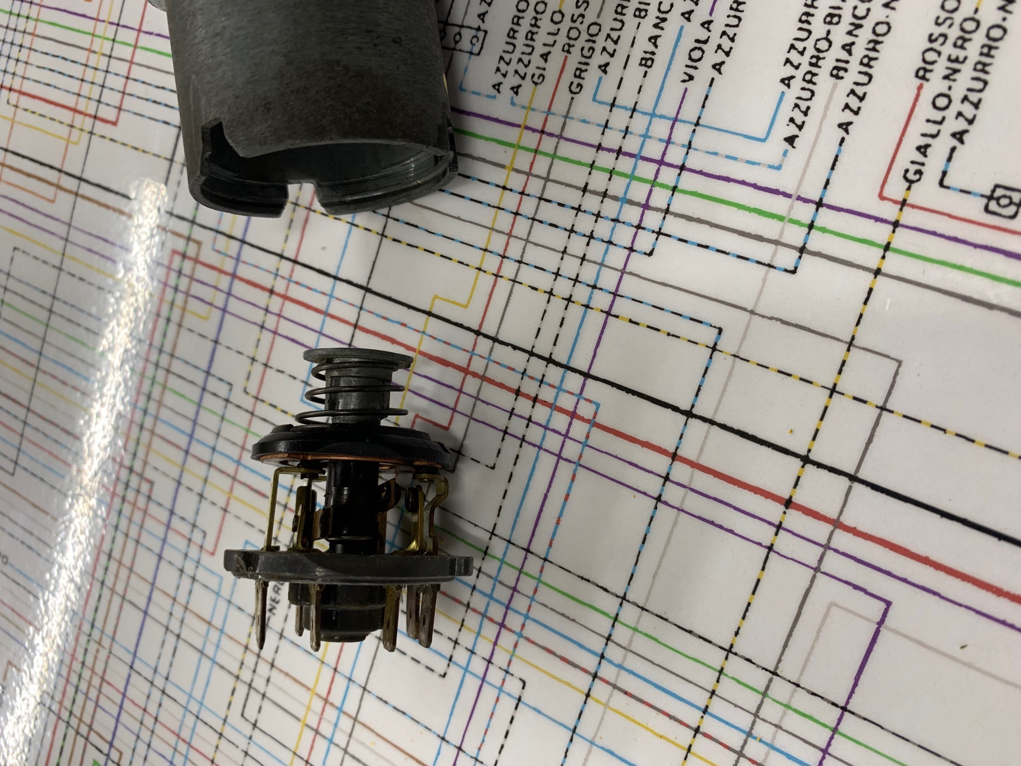

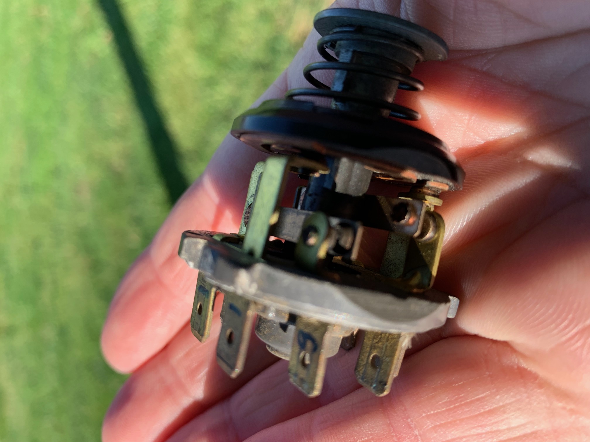

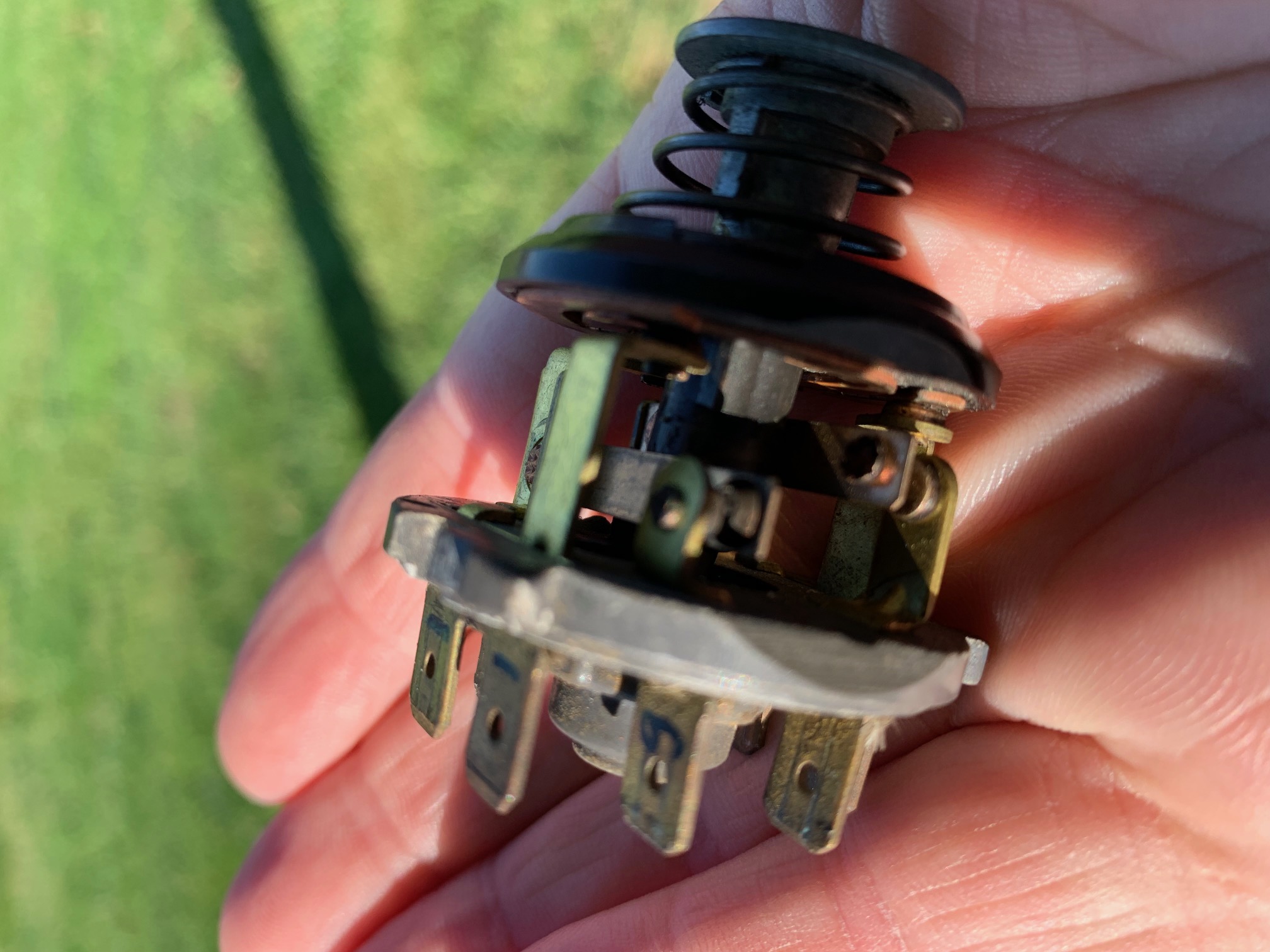

Thanks for the reply. To update this thread further, when I removed the electrical portion of the switch from the ignition lock housing, I found that the electrical portion is "out in the open" and no further disassembly is needed to clean the contacts. See photos. Not what I was expecting and certainly unlike the switch disassembly in the link I provided.

I have added a document to the Library section of this web forum. It shows ignition switch disassembly and cleaning. I have also uploaded a terminal numbering "cheat sheet" of the ignition switch terminals. I hope this will be of help to forum members. Additional photos, unused in the write up will be added as well. Thanks

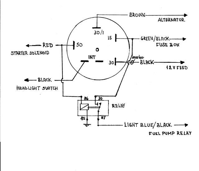

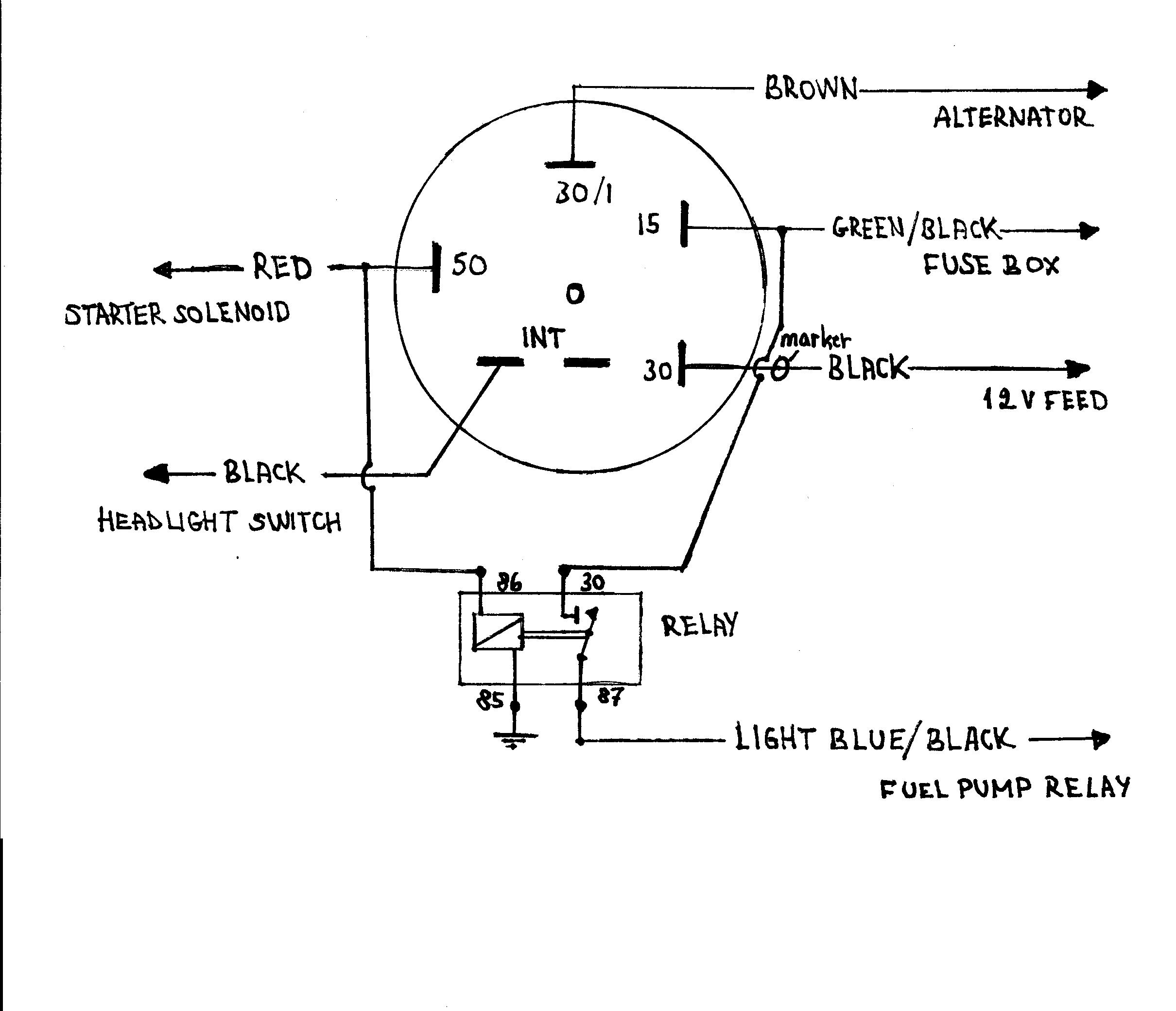

Finding a new original FIAT 4156194 ignition lock with the no. 16 contact is getting more and more difficult.
If your old ignition lock has too damaged (burnt) electrical kontacts, you still can replace it with the more
common FIAT 124/125/850/Lada ignition locks - although these are missing the no. 16 contact.
You just have to be aware of these ignition locks often come with different length of the steering locking shaft.
If too short, the steering wheel will not be locked when the key is taken out of the lock.
Contact no. 50 is feeding 12 Volt power to the starter solenoid when the key is turned to starting position, so
it may seem logical just connecting the light-blue/black wire to no. 50, if the contact no. 16 is missing...
But - when the engine is started and running, the light-blue/black wire still carries 12 Volt power from the
connection at the fuel pump relay. As long as the engine is running, the oil pressure switch activates the power
feed to the fuel pump relay, and if the light-blue/black wire is connected to the contact no. 50, the starter will
be running all the time!! Or, at least until a fuse blows... In other words - a total disaster.
Here is my solution: Adding a simple circuit with a standard-type 12 Volt relay will "isolate" the 12 Volt in the
light-blue/black wire from the no. 50 contact and the starting circuit when the engine is fired up, and ignition
key is turned back to "ignition on" position. See the wiring diagram below:

Posts: 227
Re: Ignition switch Issues
Sometimes you can find the electrical insert with terminal 16 to replace a worn one. You also can take it out and clean the contacts. To prevent too much wear a Relais between the ignition lock and the starter can definitely be useful.
