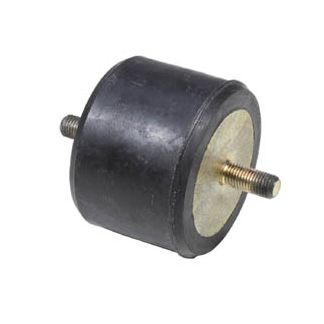

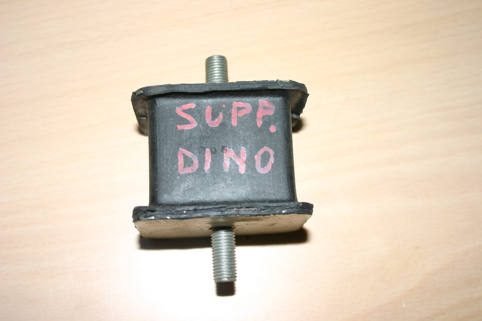

Re: Fiat Dino 2400 Coupe - drivetrain vibration
Hi Richard.
What type of rubber engine mount do you use? The original square or an alternative round? It's important that you use the sqaure type. Correct height and rigidity of the engine rubber mount is only guaranteed with the original type.
A difference in height of the mount compared to the originall causes an inclination / wrong angle from crankshaft / gearbox to propshaft. The donut / hardy disc will be bent. This is obviously not the only reason for vibrations but it adds up with existing wear and tear of the propshaft.
Also check if not already done if the rubber transmission mount is in good order and correct type.
I doubt that the rubber ring at the torque tube wears. It is a very solid part. But I would not exclude that a replacement can have an additional positive effect.
The only source for the square type engine mount I know of is Maurizio Zanella who lives somewhere at the Venice (Italy) area. Cellphone # +39 338 6274142.
Original type and alternatively offered spare.

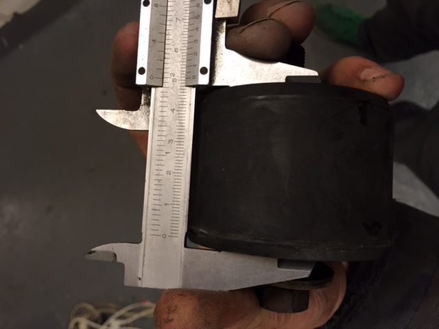

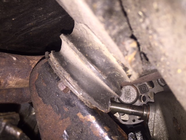

Correct height of engine rubbers?
Hi Georg,
Thanks for your info regarding the engine mounting rubbers.
What is the height of the correct square rubbers? ( I think that's most important)
My current (old) rubbers are 42mm and the replacements I got are 50mm so I am unsure what to fit.
Kind Regards
Tom
PS is it doable to fit new ones without removing the exhaust or mountings to the engine block?
Kind Regards
Tom
At drivers side I have managed to change it from downside, when the engine hang on a crane. Other side is more difficult due to the starter...
as Thomas says above, I think the starter motor side would be very hard to do without the exhaust downpipes removed.
Maybe use this as an excuse for stainless downpipes and re-furbish the starter-motor while also fixing the motor mounts?
Thanks for thinking along!
I guess I will just have to try it!
But what about the mounting rubbers Thickness? I want to make sure to fit the CORRECT height rubbers, especially because it's quite a job to replace them.... What height of rubbers do you have fitted? (and is your car virbration-free?)
Kind regards
Tom
Kind regards
Tom
