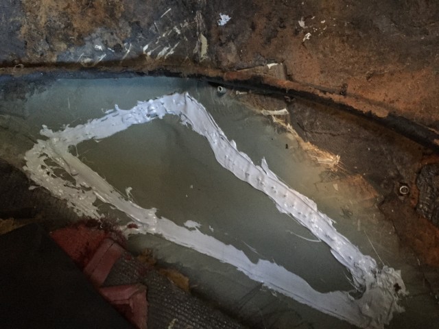

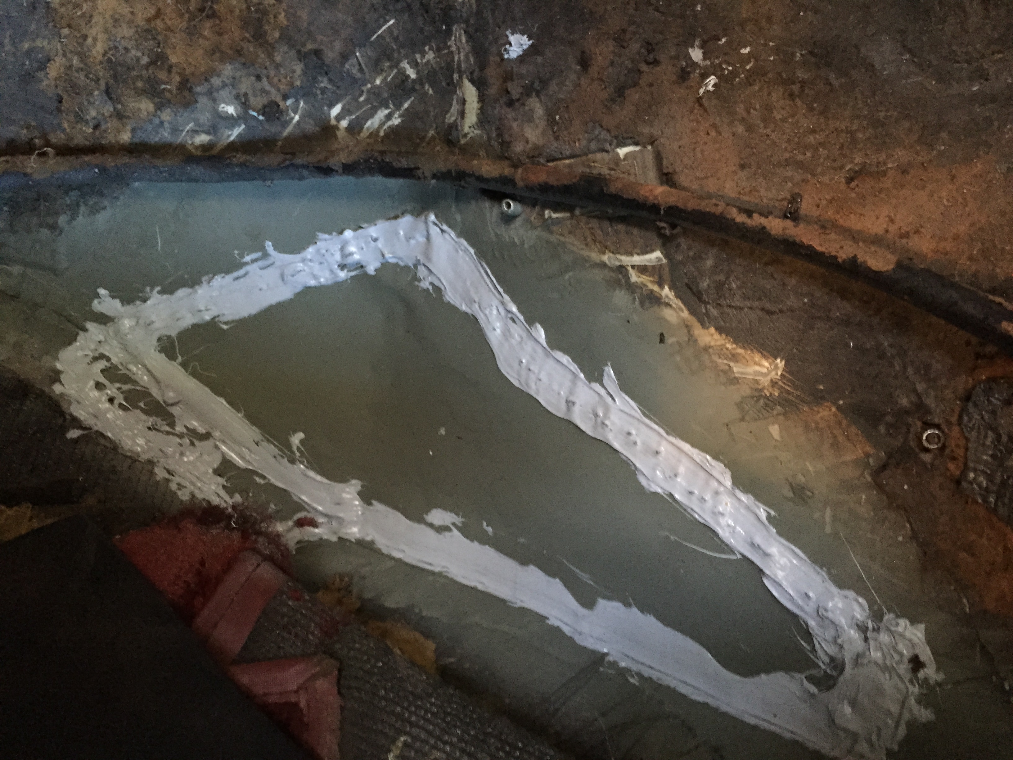

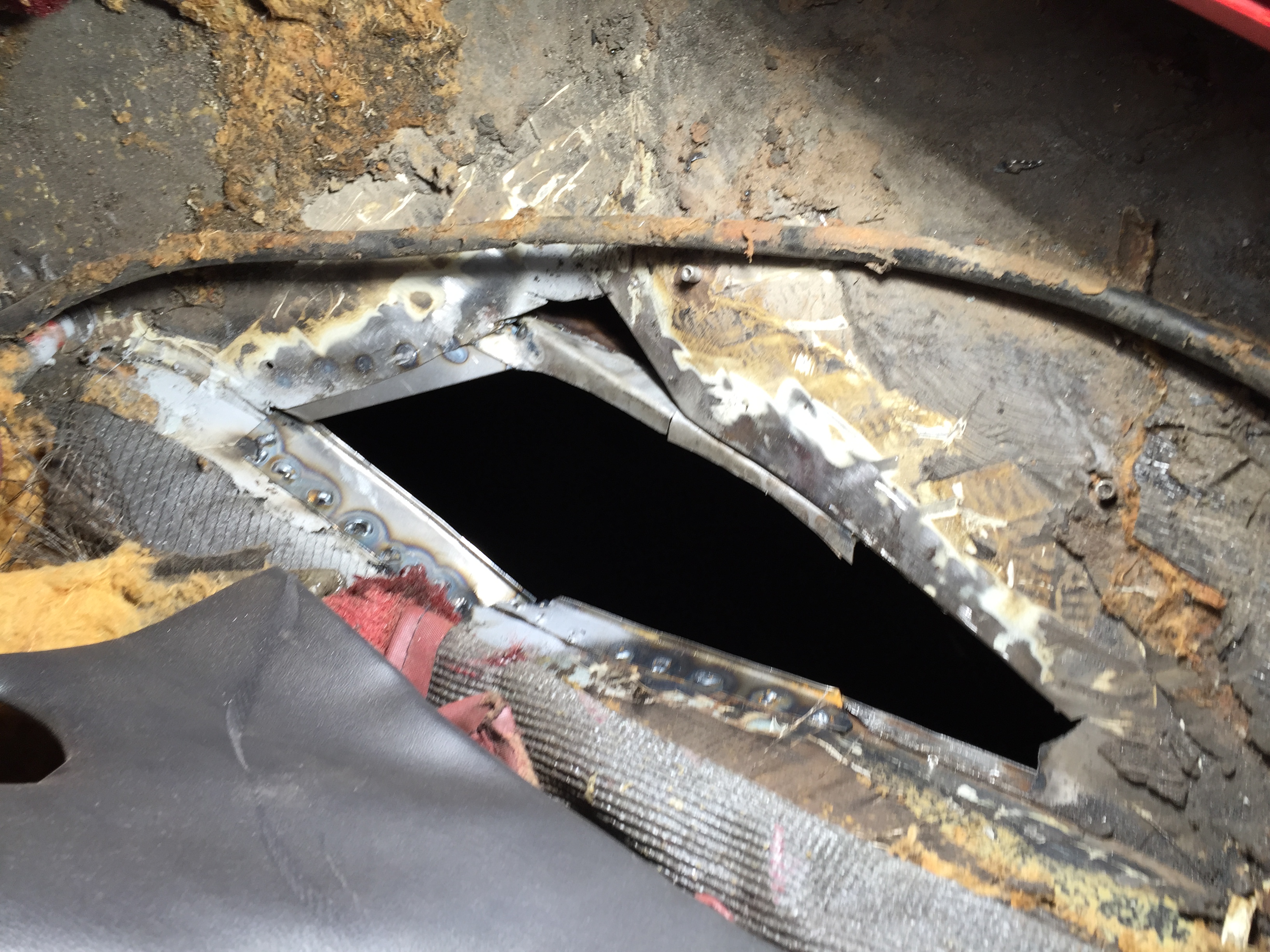

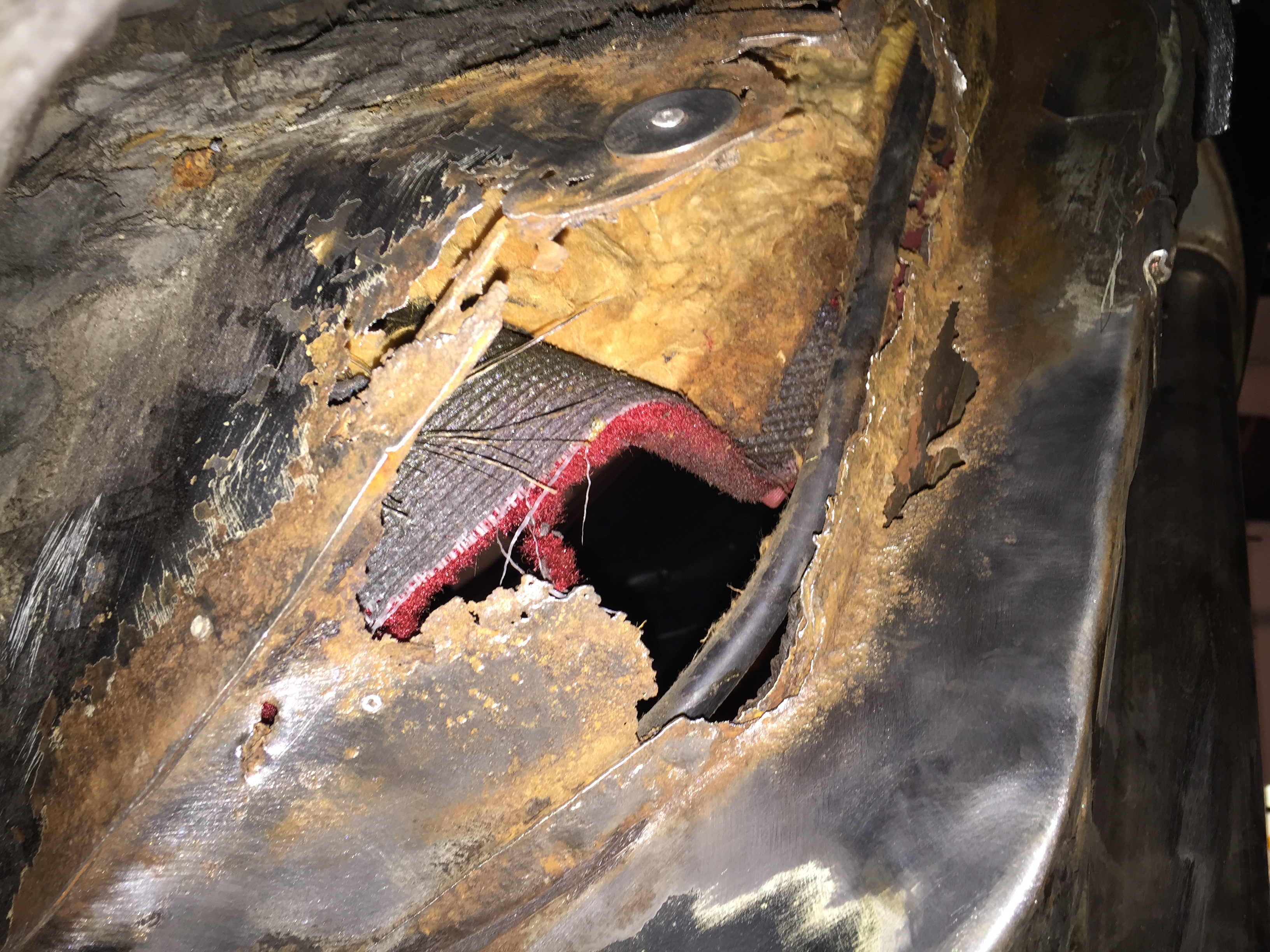

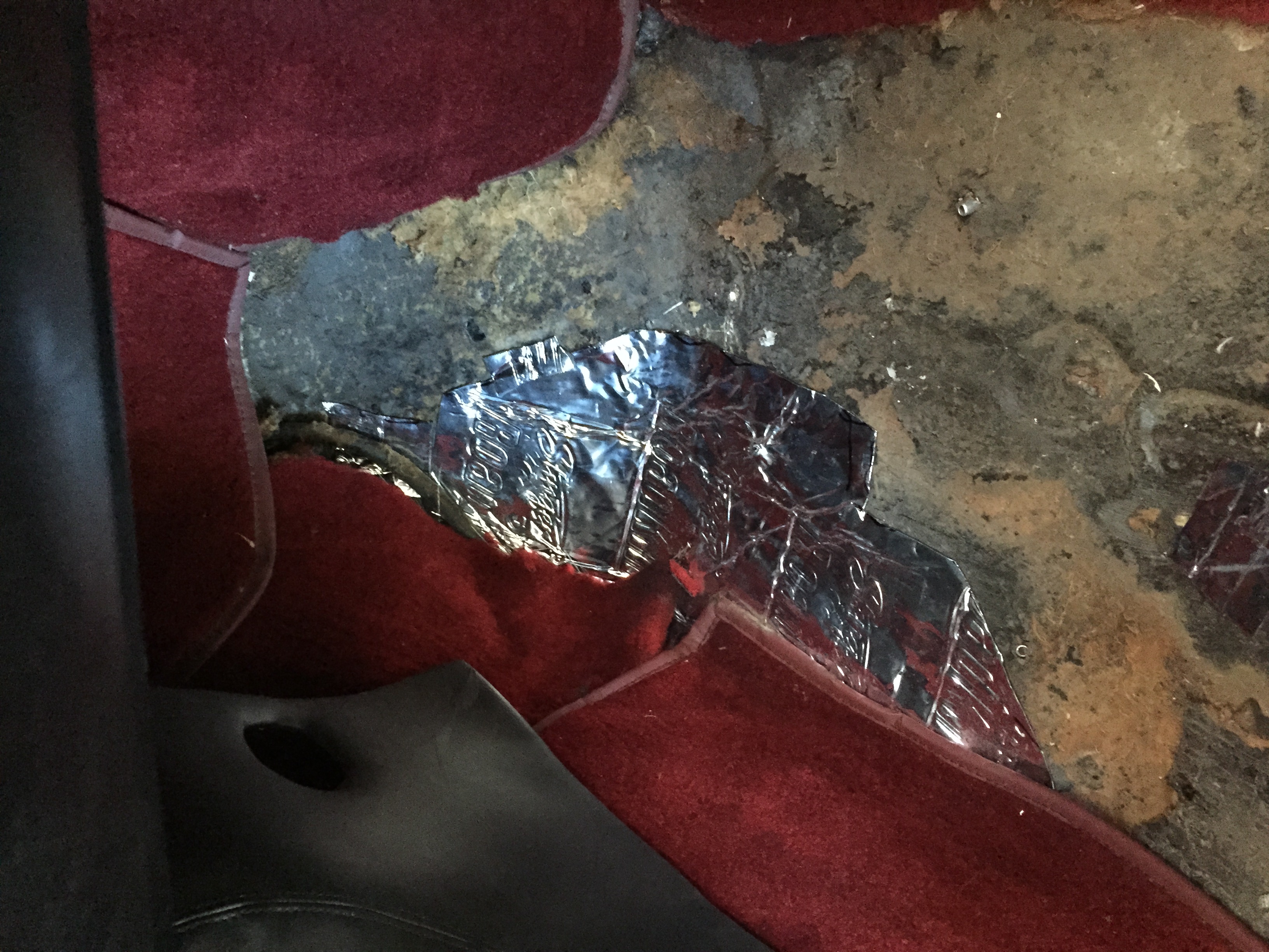

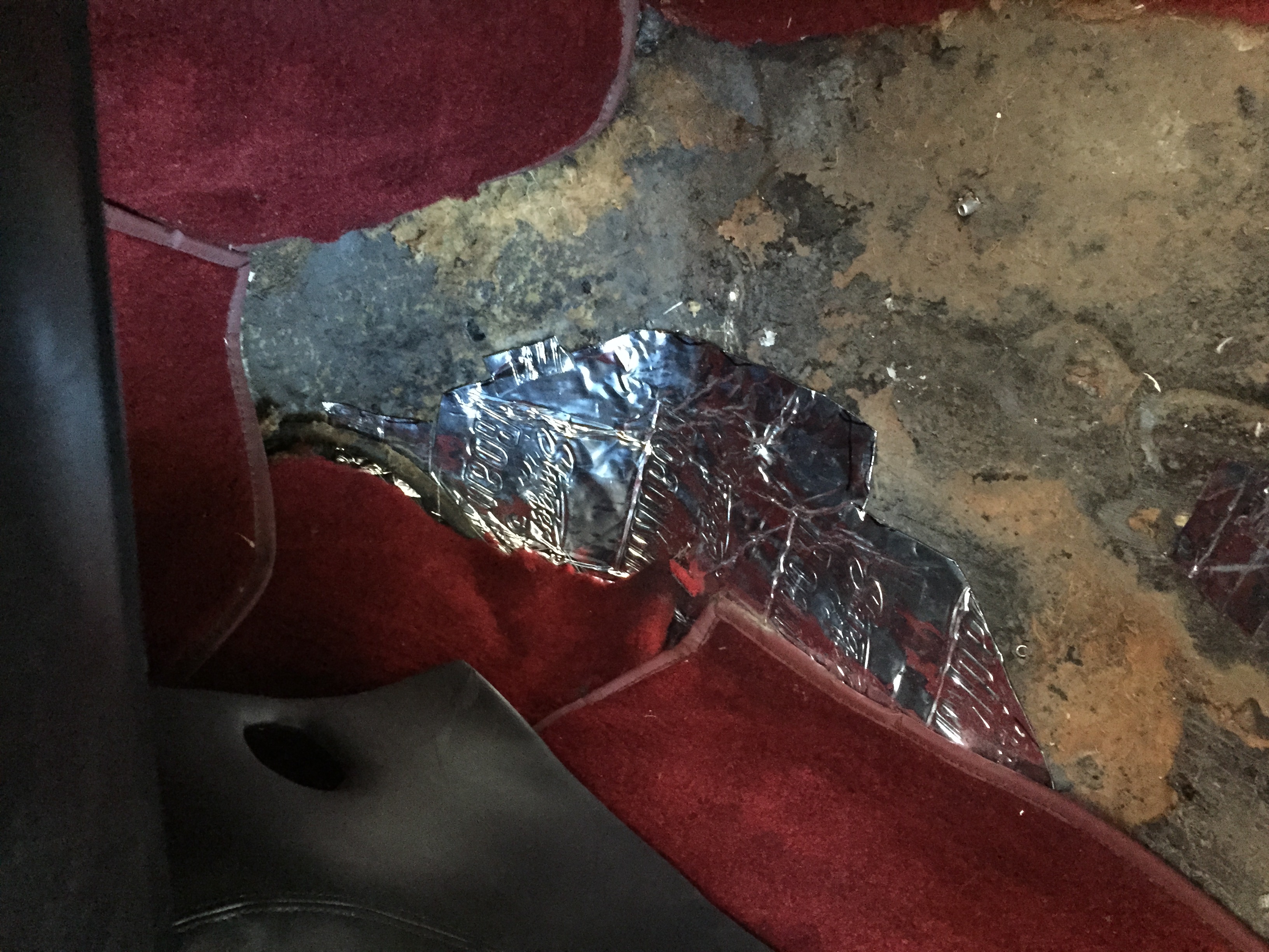

Today (actually all last week) I welded up the passenger floor of my 2400 Coupe.  The rot was pretty bad - and had got into the box section that runs diagonally under the floor.  This was all underneath the sound-deadening material attached to the underside - this stuff must have got wet, retained the moisture and rusted out the sheetmetal beneath - all when this car lived in worse climates (central Canada).

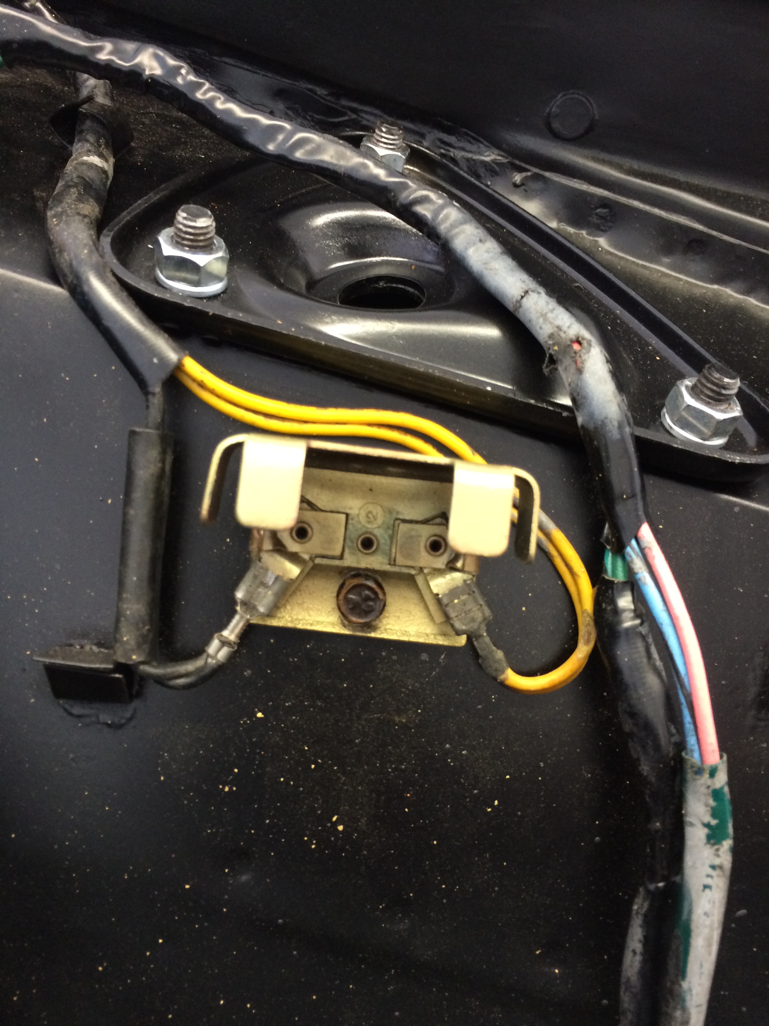

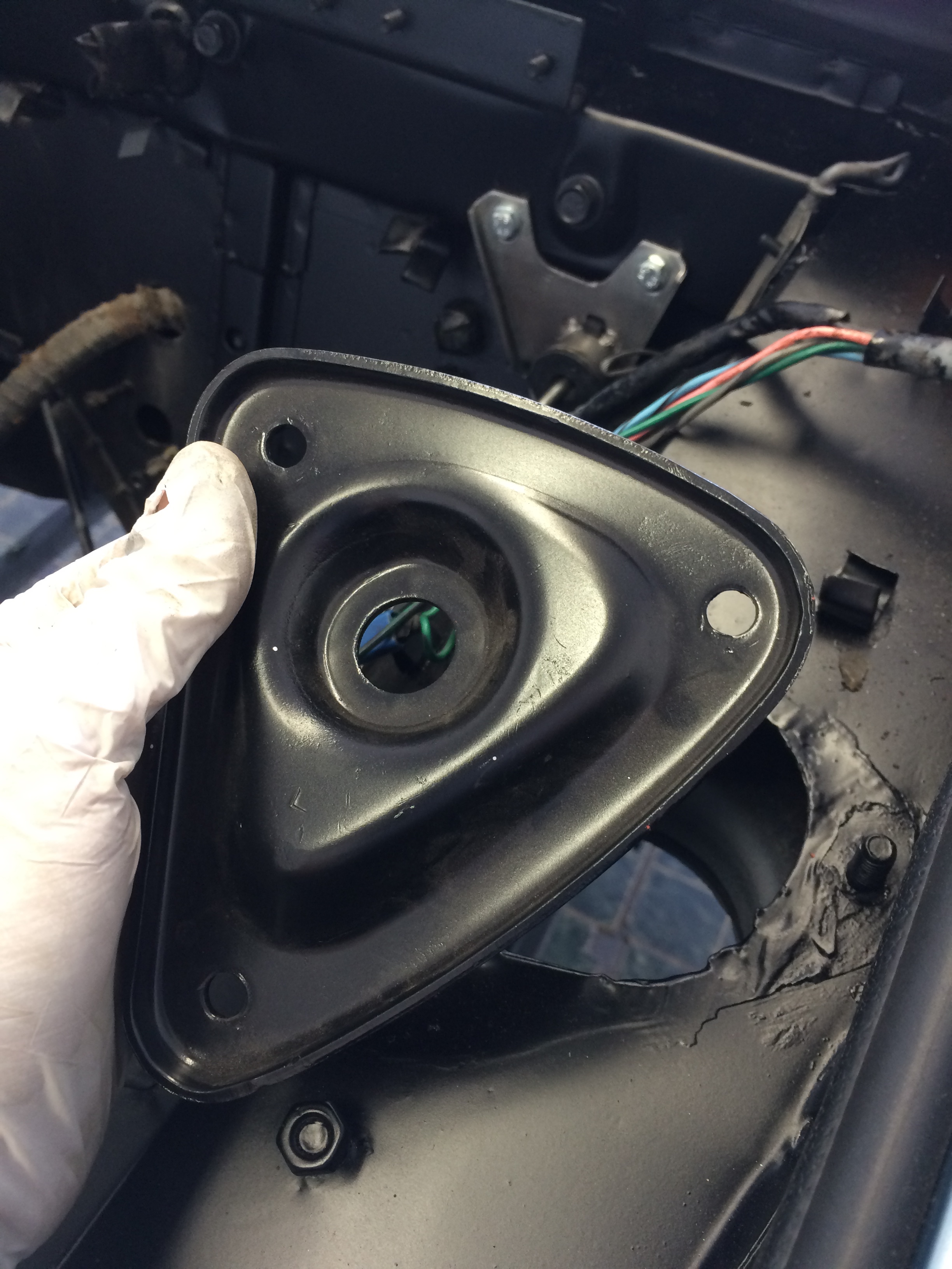

Today I removed, cleaned, polished, painted and changed bushes to the vacuum pump and pressure swith, and in the way, I managed to break one stud in the strut plate while removing the pump. Made a quick fix drilling, tapping and bolting another stud. I also changed all the door rubbers for a new ones (only one today)
I also changed the oil and filter, changed fuel hoses to to the carbs, done a bit of cleaning in the engine compartment.. Plenty of work. And muuuuch more to be done, only to put it on the street.
Thes week I have also changed both exhausts, fixed the wippers issue (they did not return to the stop position) by bolting to the plate a microswith, as the original system was completely destroyed... Slowly moving forward. Next week I want to start, adjust timing ignition, adjust CO, fit the new plugs, airbox and new air filter, and finally drive it (Really short trip, it is not registered yet)

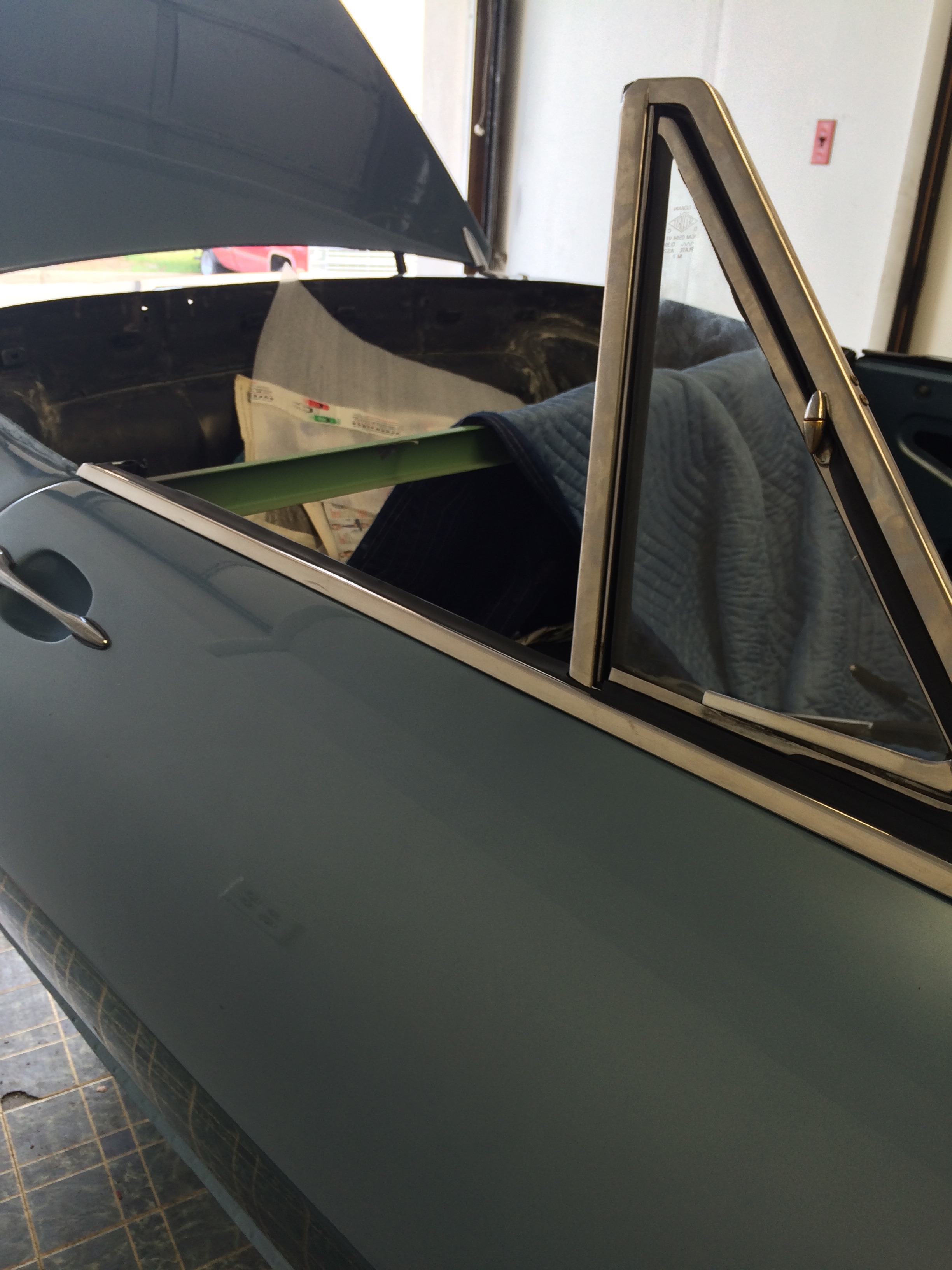

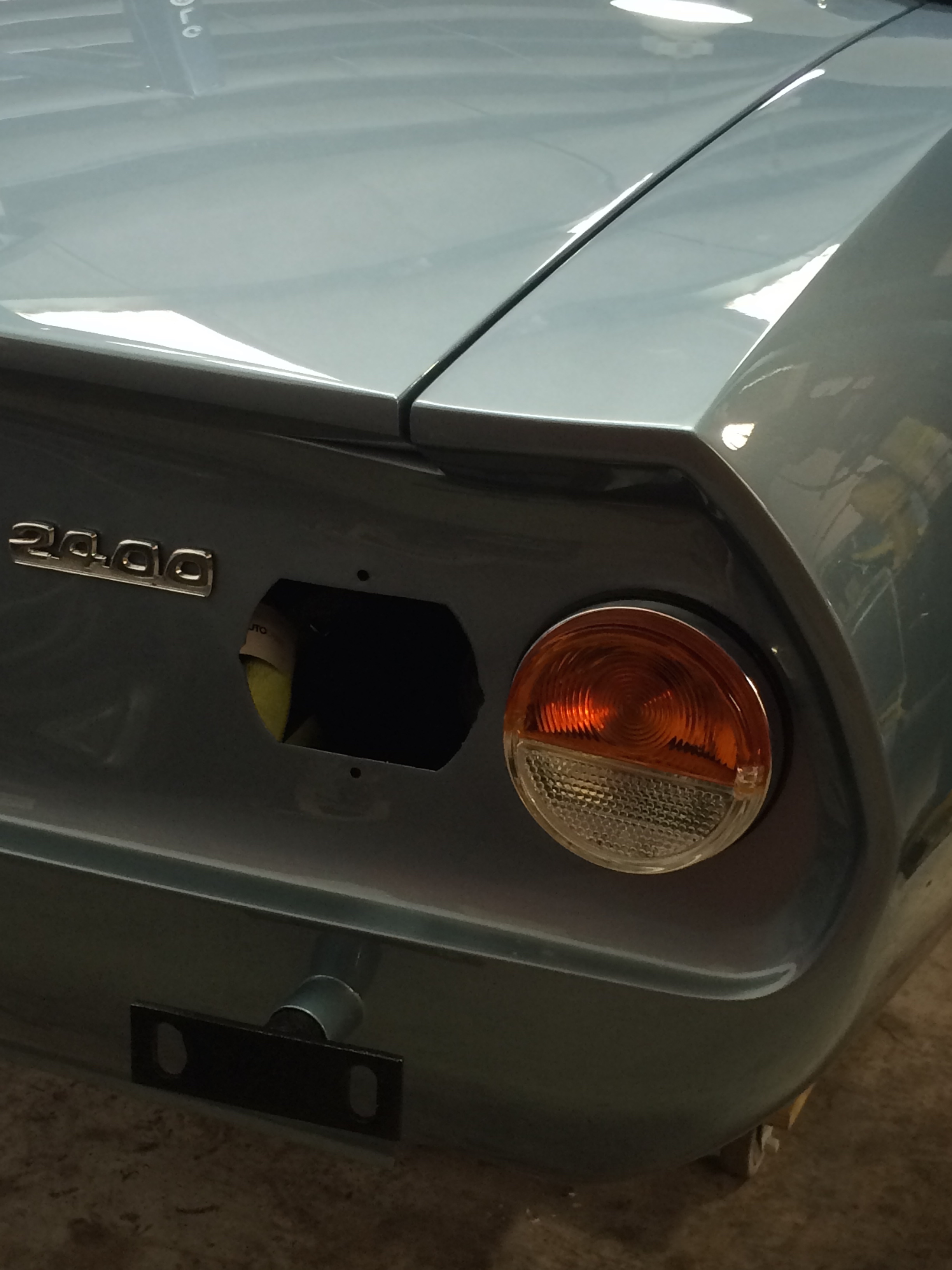

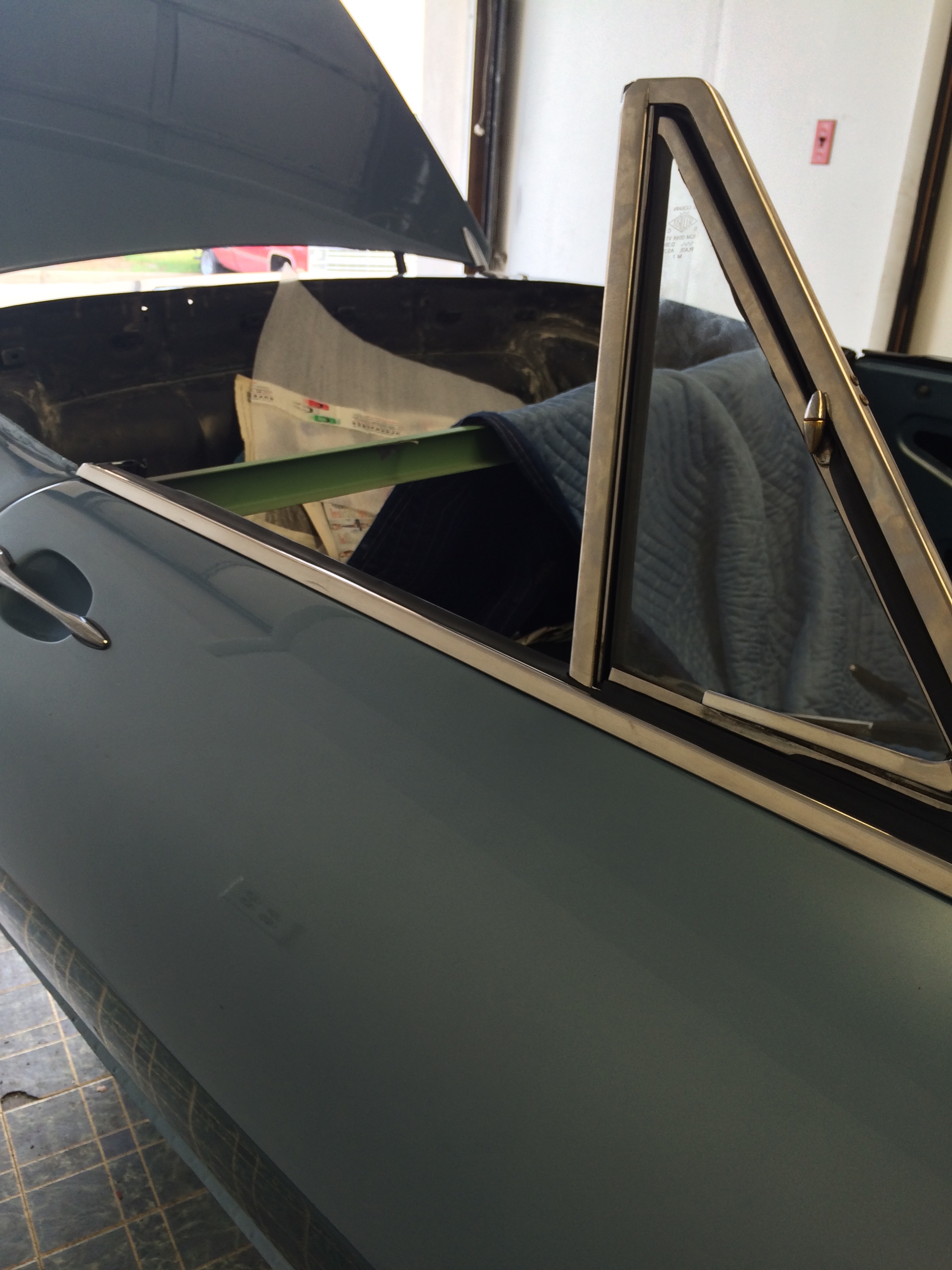

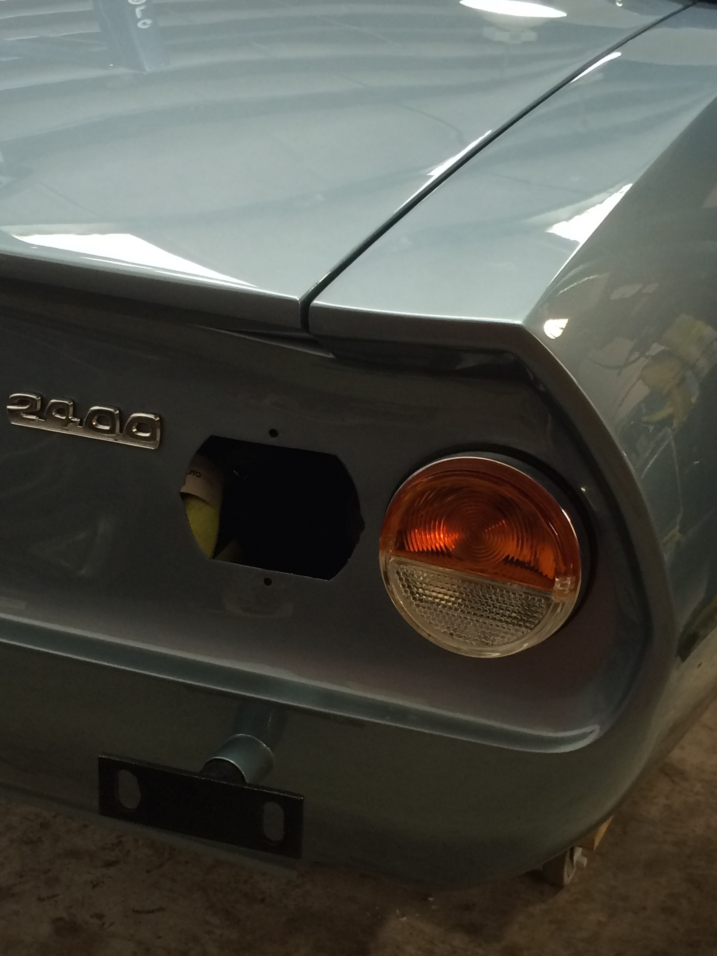

I added my shock plates, windows, trims and electrical light in the engine.
Moving along with my restoration.

Re: So what did you do to your Dino today?
New fromnt shocks fitted. Rims resprayed. Got some new window scrappers still to be mounted..
