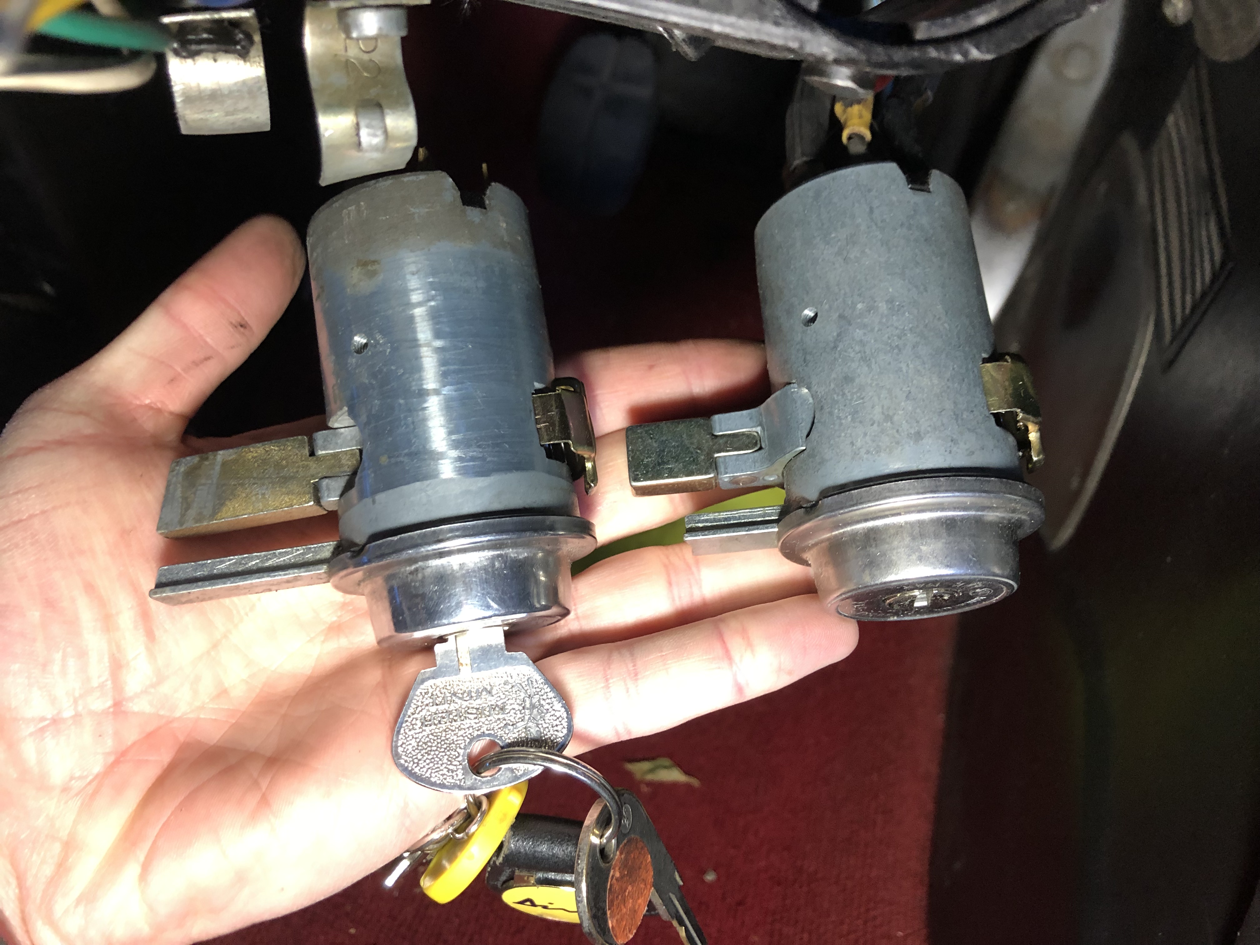

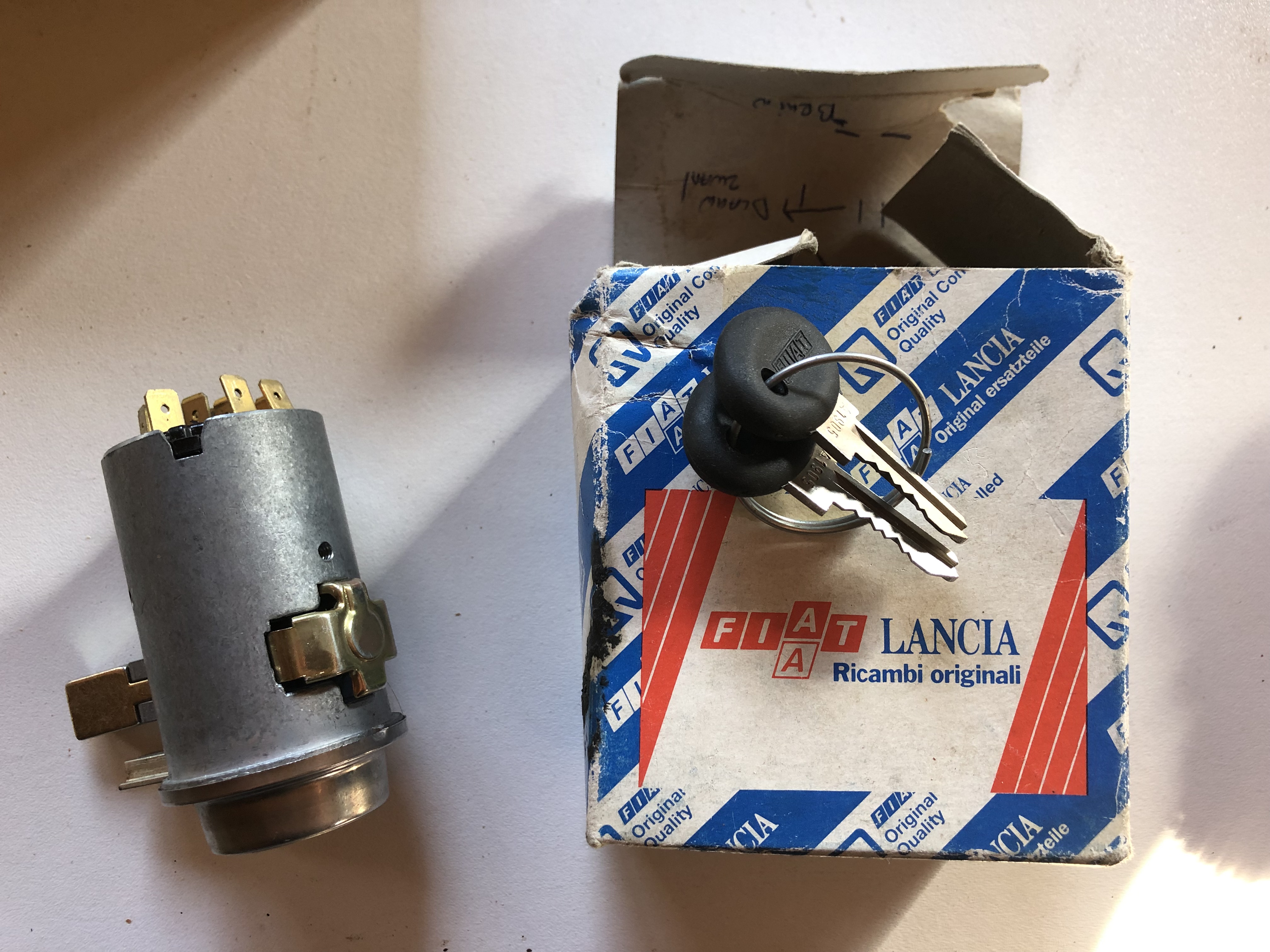

The problem soon got worse. It turns out the problem was indeed the ignition switch. A NOS example popped up for sale locally for a very reasonable price, so I picked that one up.
Changed them over last yesterday and everything is working as it should again. The only "problem" is that the NOS switch is slightly different and as such the steering lock does not work.
I will have a look at the old one and open it up some day, not a priority though. Also, I'll get a decent set of keys for the new switch...

How about changing the switchplate of the new (non fitting) ignition switch into the old one?
I had a similar problem to ours with my 2400 coupe and cured it with a new switchplate from holtmannn & Niedergerke. The old one was corroded, dirty and finally had burnt contacts.

Ribolla_67 wrote: Tue Mar 29, 2022 9:30 pm I had a similar problem to ours with my 2400 coupe and cured it with a new switchplate from holtmannn & Niedergerke. The old one was corroded, dirty and finally had burnt contacts.
I didn’t know those are available, it’s on the order list now, thank you!
