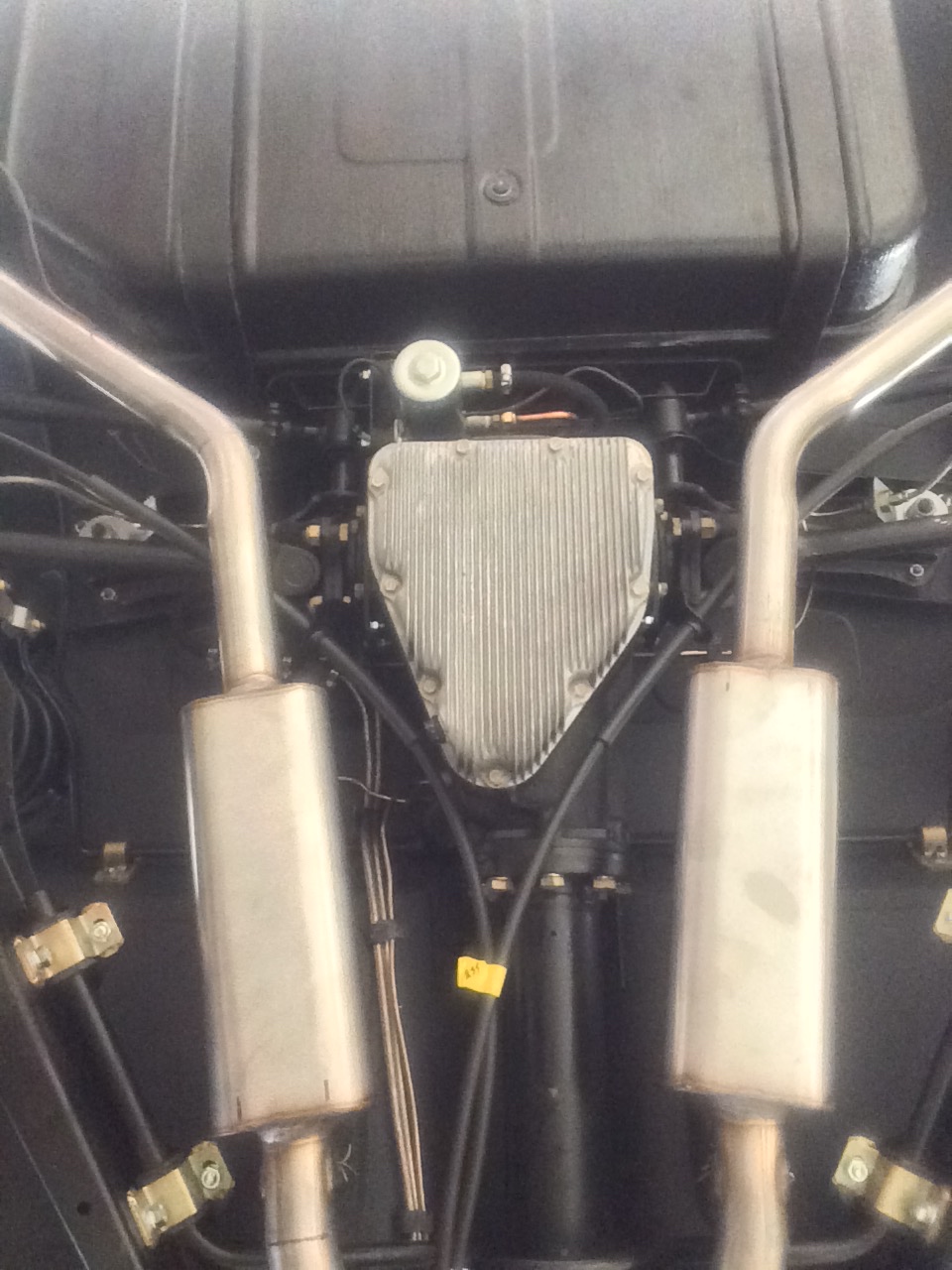

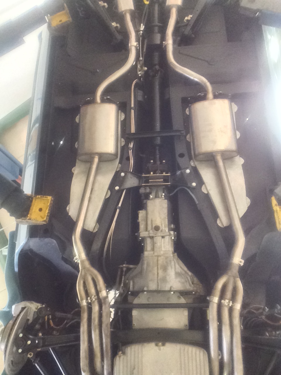

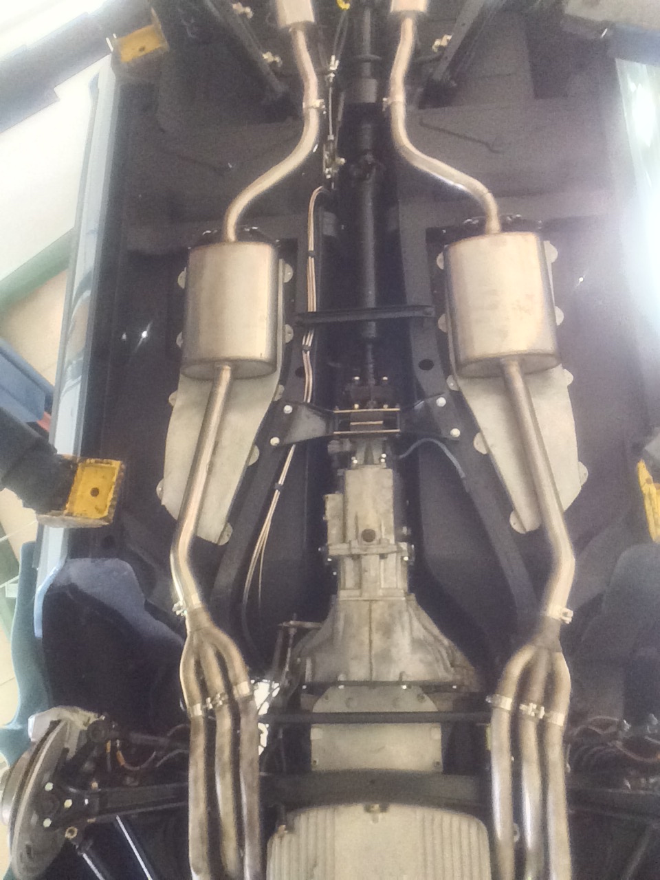

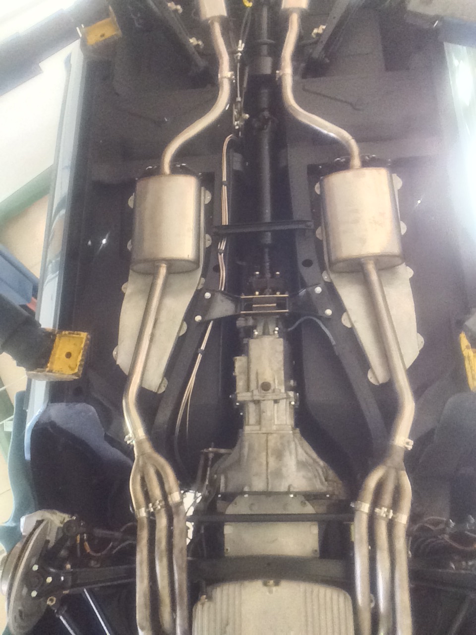

We are nearly there,
Just installed the exhaust system.

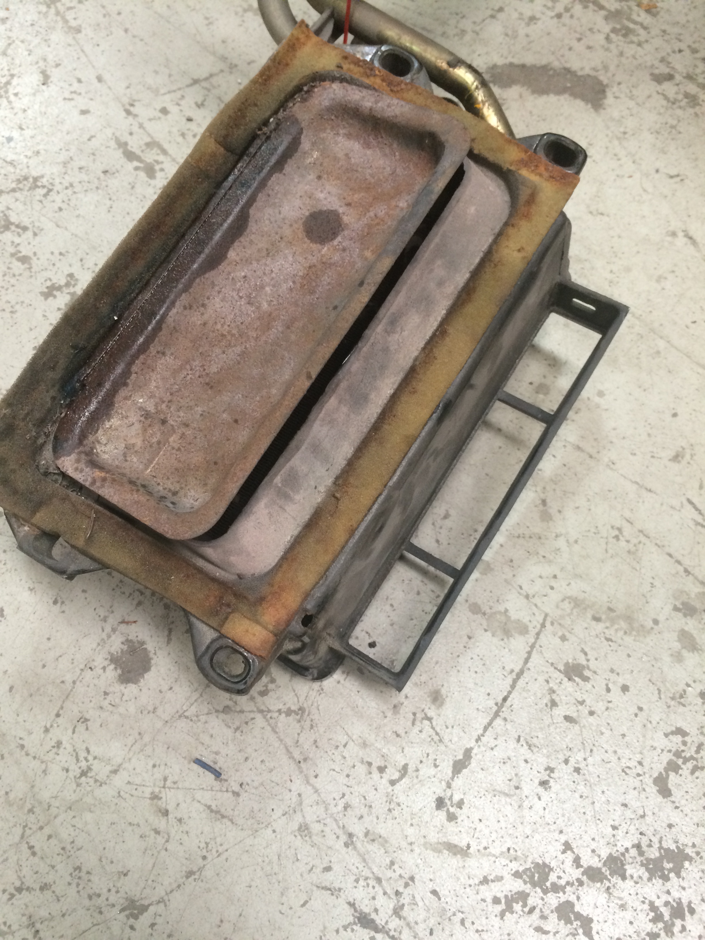

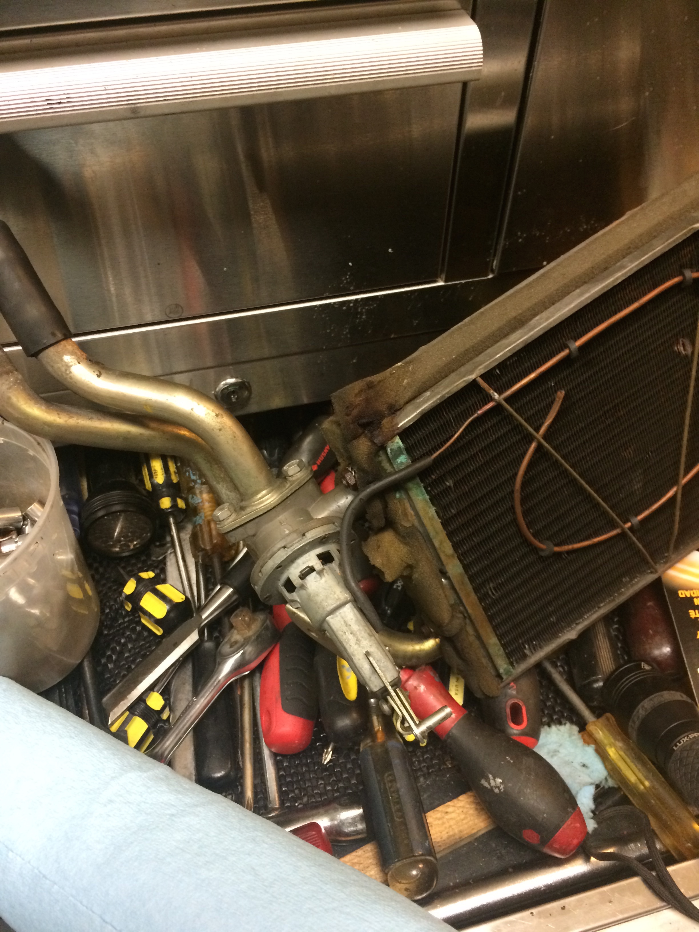

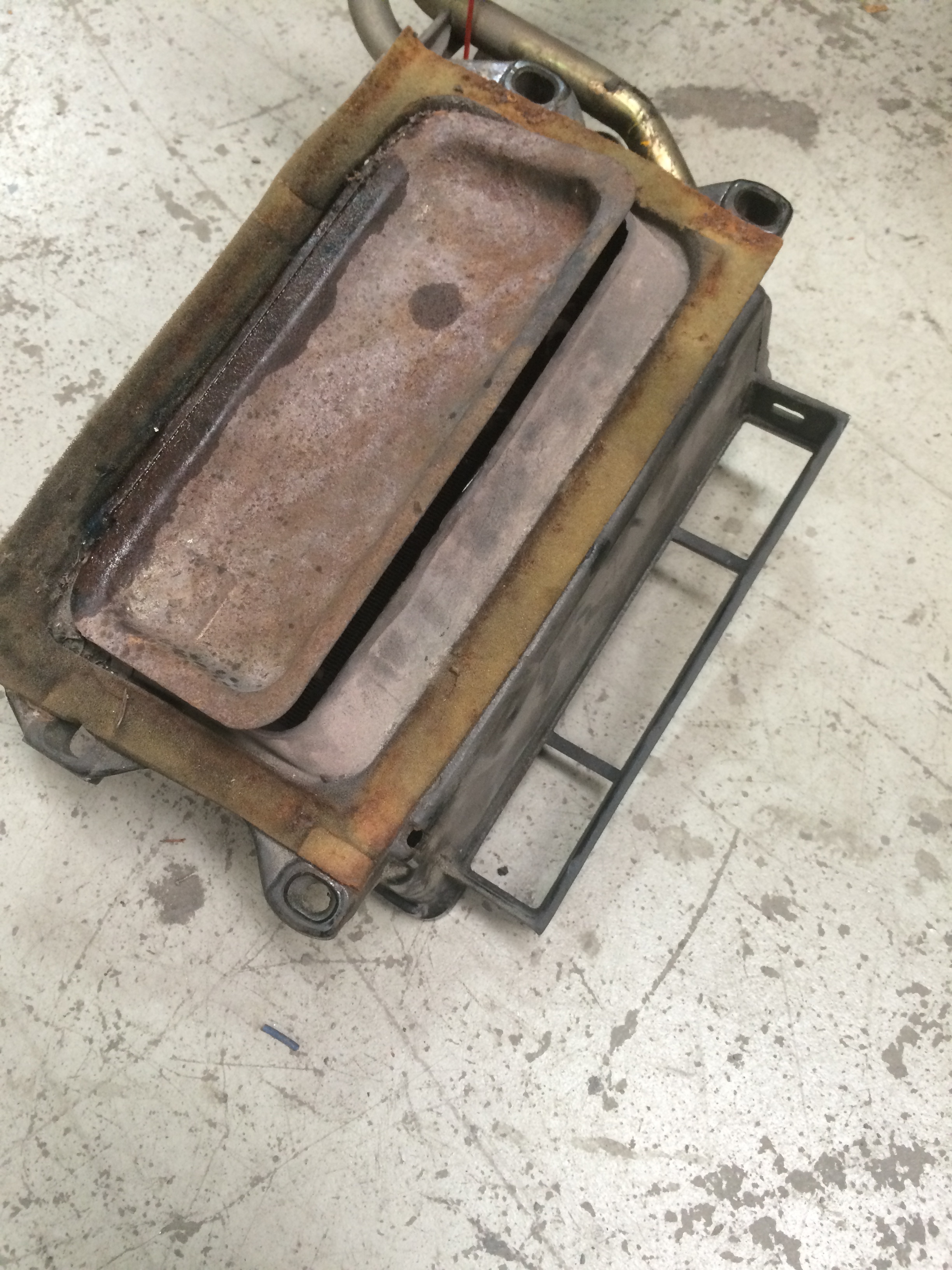

Now taking apart the heater core unit.

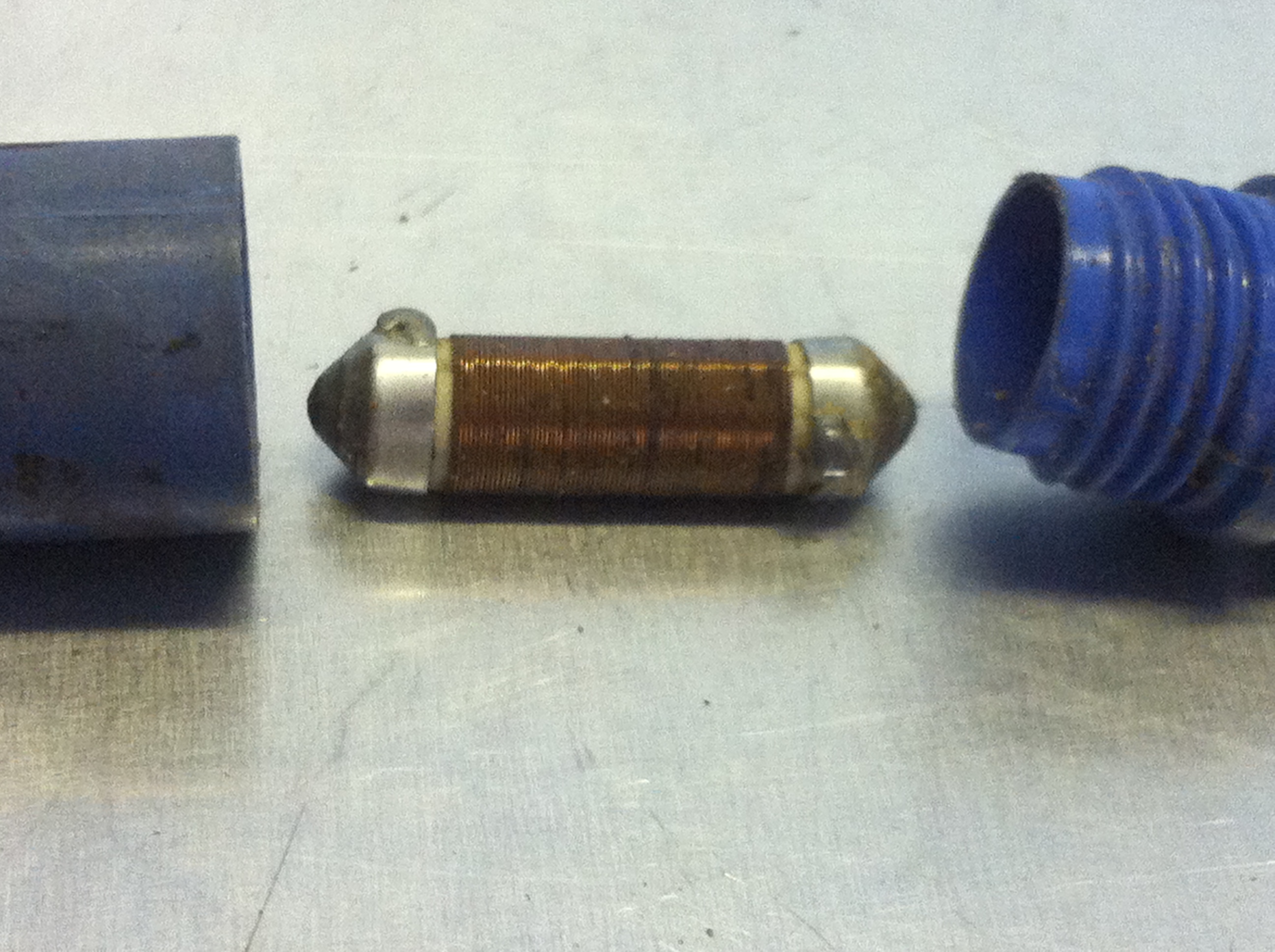

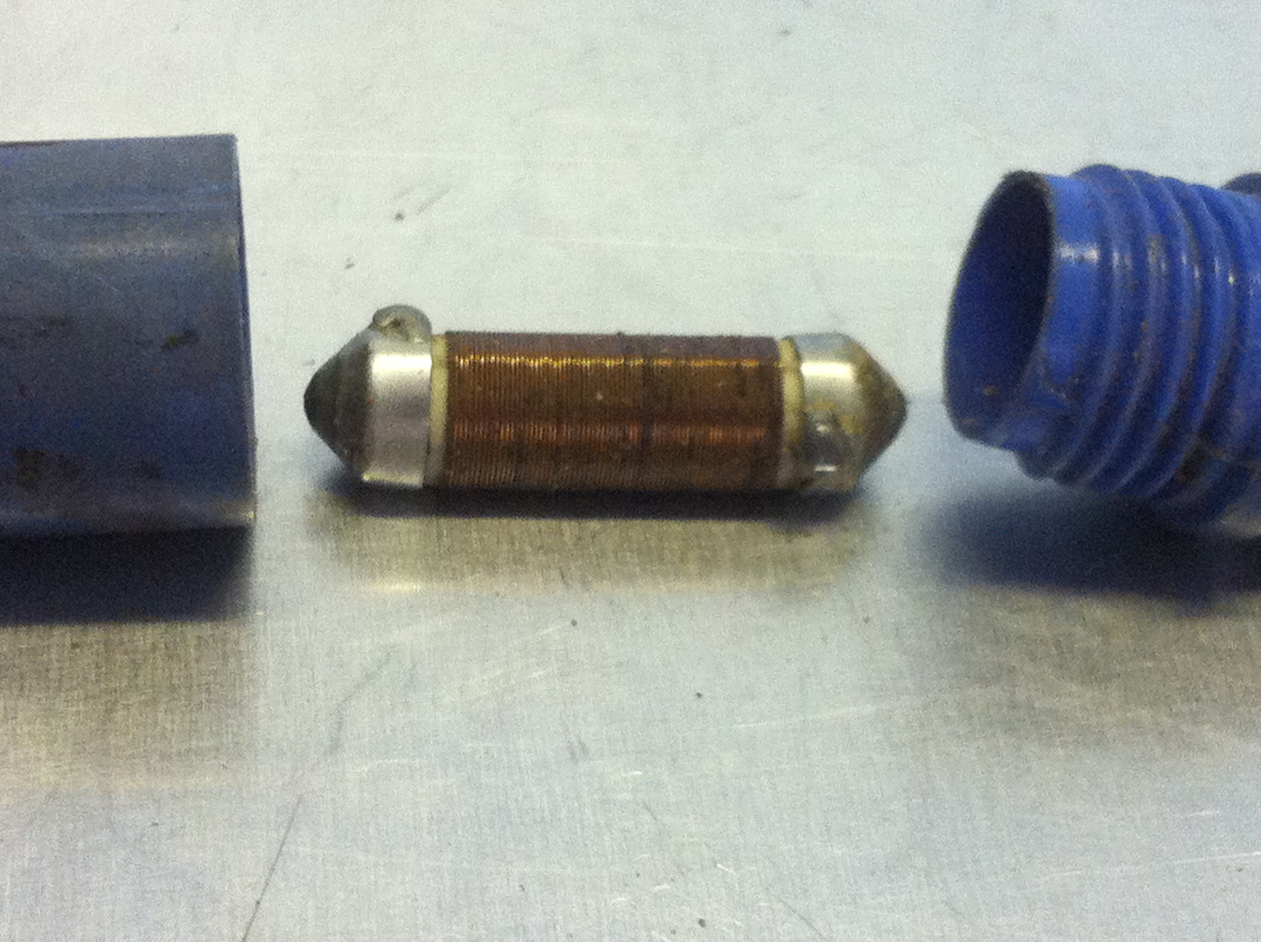

The blue fuse is in fact a voltage stabiliser for the instruments and takes a resistor. Complete new units are available.

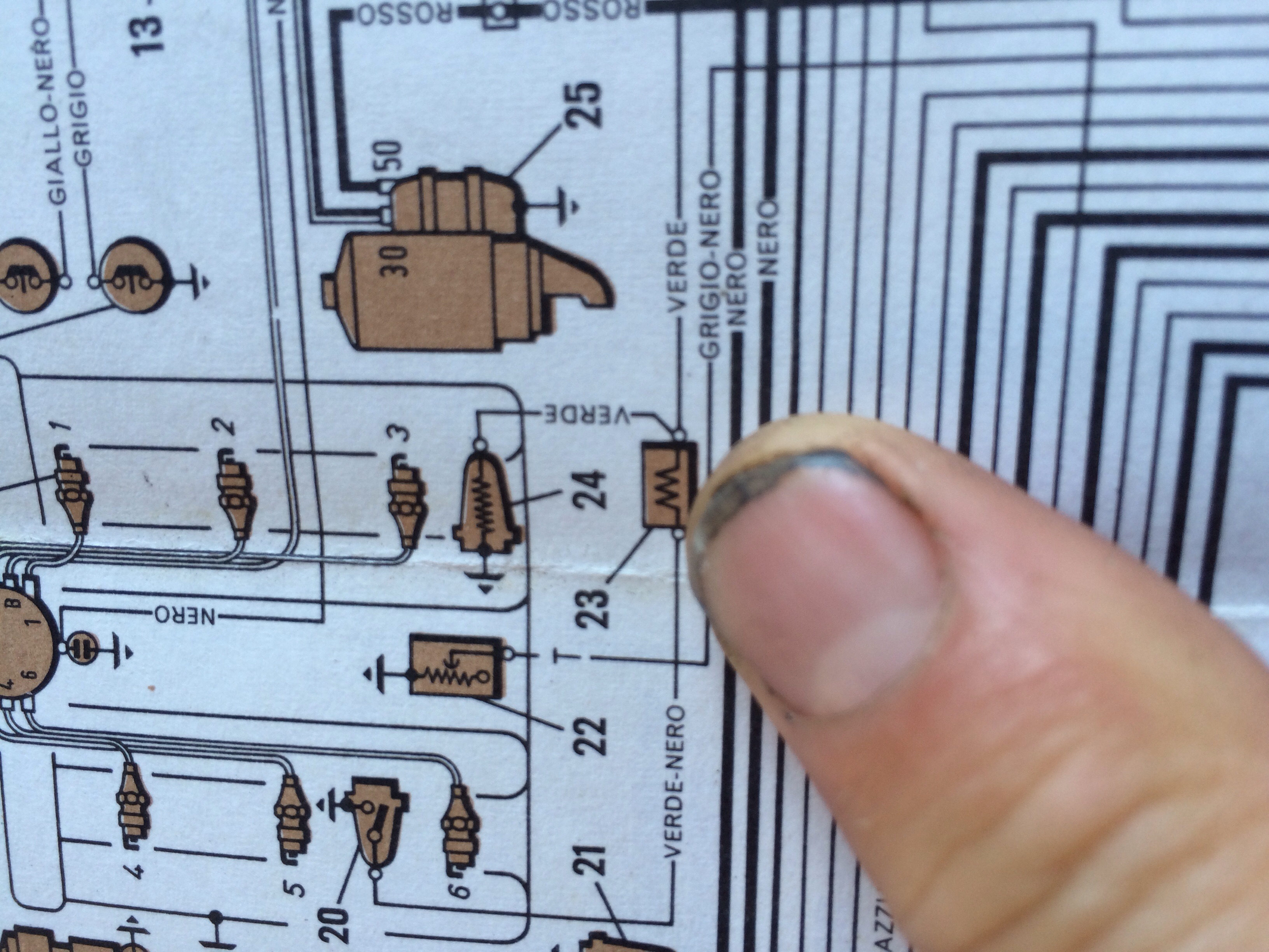

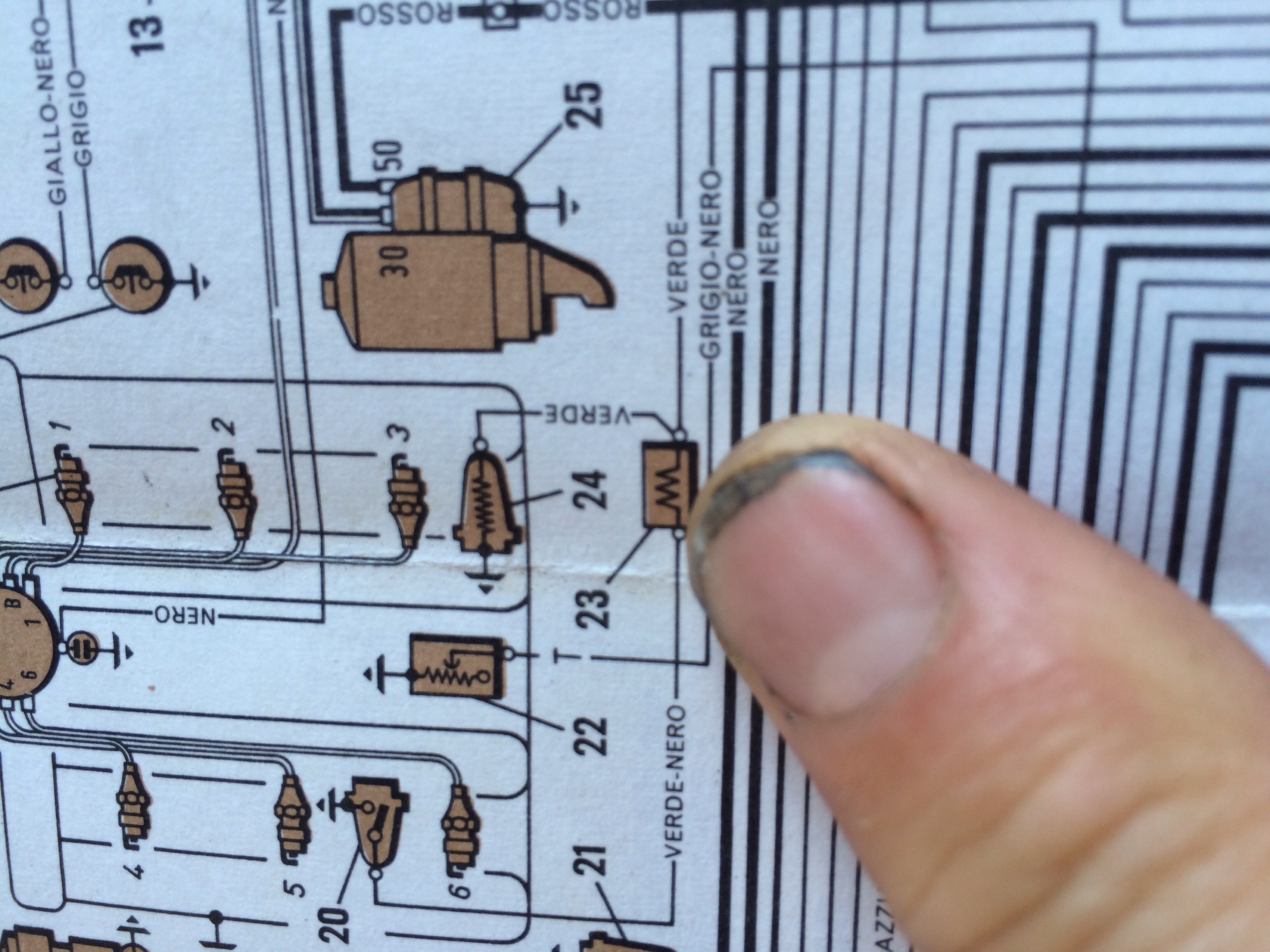

As per the resistor. I figured out that the blue resistor is part of water temp gauge number 23.
Where can I locate the proper resistor? I believe it is a 100 ohms?

I must be going mad, I thought I saw a modern replacement resistor listed by Superformance, but now I can't find it! I'm sure there must be other FIAT/Ferrari applications. The main purpose is smooth out the swing of the gauge needle.

From the shema, my fuel relay is located under the dash.
I manage to get a full blown print 42" by 42"
This really helps.
Thanks for the help.
This really helps.
