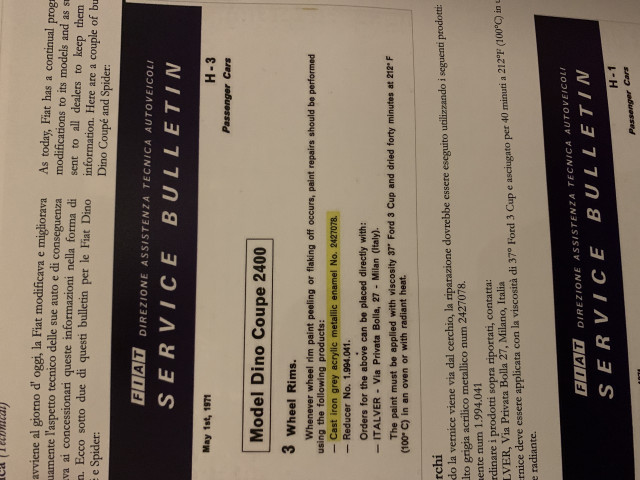

Also is there an official colour for the silver finish? I’ll post a few pics later today.

I don't have the color match for the silver wheels, but you can order free swatches from many of the powder coat places online, like Prismatic colors or Powder by the Pound. It is shocking how many different "silvers" there are.
