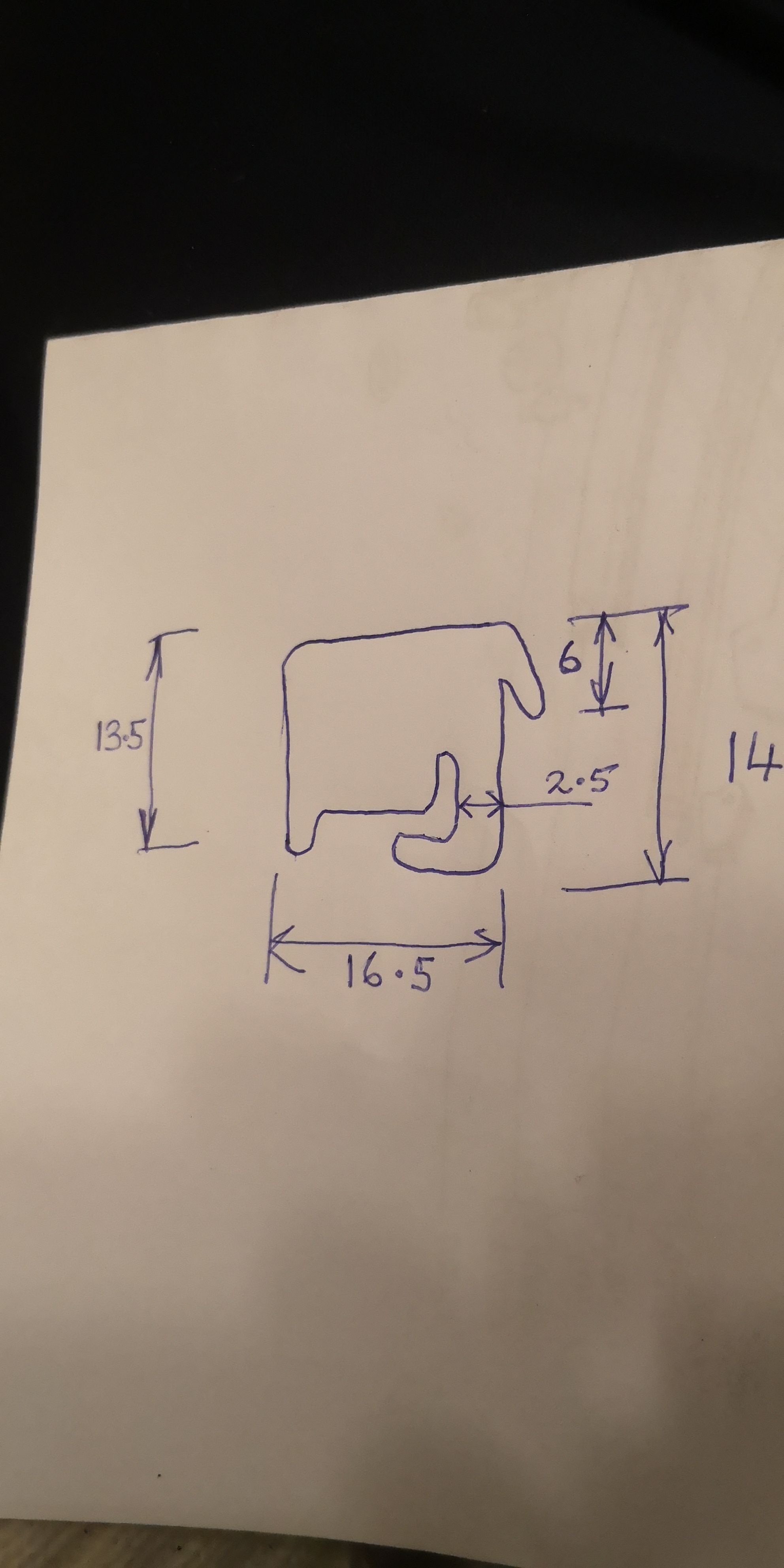

This is the approximate cross section. The overall ring diameter is approximately 155mm. Although the best way to set the dimension is to measure the flange diameter on the box.
With this, is there somebody who speaks Italian who can speak to Cicognani and get a price? For production they could use a seal and measure with a shadow graph or CMM.

And the rectangular seal outer dimensions are 145mm x105mm. Again the most accurate way is to measure the box it has to fit onto and use a Shadow graph or CMM to measure the section.
