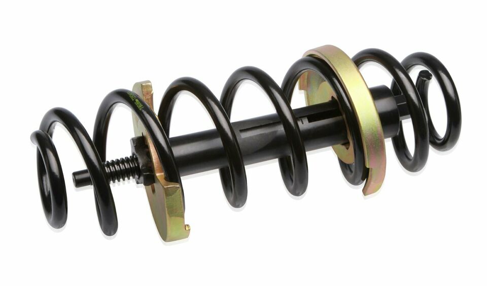

Hi Thomas,
just to be on the safe side, as I plan to overhaul my front suspension soon:
do you mean the sort of spring compressor shown below?
Yes absolutely, these are the rights ones! In Common Internet platforms there are many Sets of these, usually there are Two Pairs of "plates" in it, the Dino needs the bigger ones.
KR Thomas
This is the one (very cheap) I used to install my springs
It worked well but you have to be careful to position the 2 fixings in opposition so that the spring remains straight
