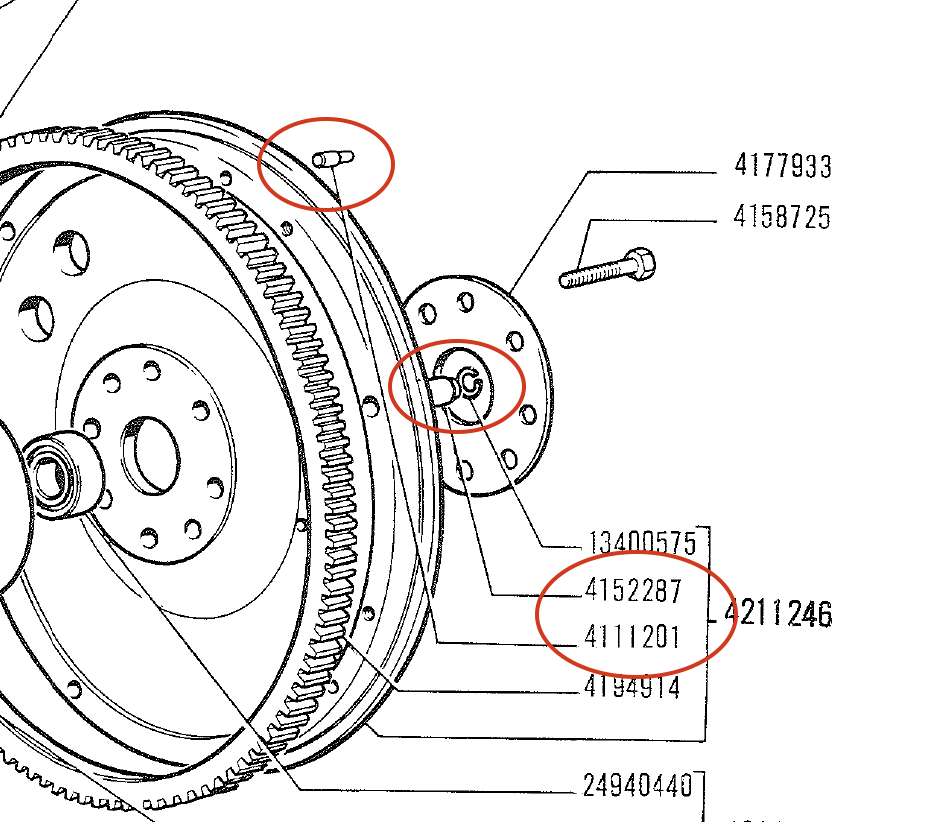

clutch kit
I've been buying new parts while the engine is at the machine shop, including a clutch kit (pressure plate, friction disk, throwout bearing)
The 2400 flywheel has been re-surfaced - so the dowel-pins were removed, surface re-ground, pins replaced.
But...the new pressure plate does not fit on the pins. Where the old pressure plate has large bosses with holes for the pins, the new one has no way to accommodate those pins.
I bought the kit from Superformance - looking at the clutch kit offered by Dinoparts, the pictures are exactly the same. There is no manufacturer marking on the parts whatsoever so I don't know where they buy it. The 'fingers' of the pressure plate (where the throwout bearing pushes) are 5mm closer to the flywheel. But I suppose that can be compensated by the clutch cable linkage adjustment.
I guess the idea is that the torque is all taken by the mounting screws (x6) and not shared with these dowel pins. I tried to look for someone to rebuild the original pressure plate, since it seems to be a better/more robust design - but I guess that's no longer 'a thing' - everybody just buys new parts.
Has anybody fitted a recent clutch kit from one of our 2 favourite suppliers and can confirm that it works well?

Re: 2400 Coupe engine rebuild
Has anybody fitted a recent clutch kit from Superformance or Dinoparts?
There are two sizes of dowel-pin fitted to the flywheel
3 x 4152287 (about 10.8mm diameter and 25mm long
(the parts book shows a lockring on the end of each)
3 x 4111201 (tapered, about 8mm max diameter and shorter)
The 4152287 pins interfere with the new clutch pressure plate and will have to be removed
The 4111201 pins, at 8mm, are too small for the 10mm hole in the pressure plate, therefore provide no locating function
is that going to work?
