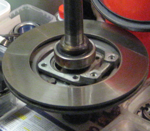

Assuming you don´t really need to separate the actual knock-off hub from the driveshaft, there is a way
withdrawing the driveshaft from the rear axle tube - with brake disc and knock-off hub still in place.
After dismantling the brake caliper from its bracket, only four bolts 4149851 are holding the brake
caliper bracket, which holds the driveshaft with the outer wheel bearing and brake disc in place.
With a suitible spanner, there is possible to undo the four nuts 12164721 and withdraw the driveshaft.

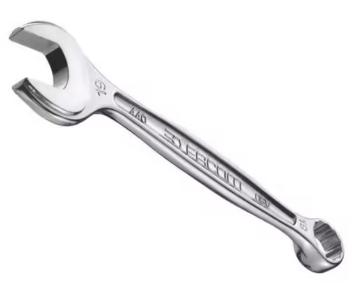

If you don´t have a suitible spanner, buy a standard one, like this:
Skärmbild 2023-05-12 084453.png (61.29 KiB) Viewed 17025 times

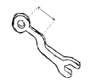

After suitible heating, bend it to a kind of S-formation, like my terrible drawing:
Skärmbild 2023-05-12 091413.png (21.24 KiB) Viewed 17025 times
The shown measurement is of importance, to make the spanner fit into "the brake disc inner circle".
Otherwise the spanner and the nuts cannot be turned freely.
Skärmbild 2023-05-12 091845.png (439.7 KiB) Viewed 17025 times

2. What is the dimension for the distance from the center of the spanner to the start of the offset. I assume from yr sketch that the offset makes the ring and open end in the same plain? In other words it would lay flat on the bench!

2. The distance you have to figure out yourself, as I for the moment not have access to the tool
I made. But the "first" bend should be close to the "ring end".
My drawing probably confused you - no, the S-shape should not be "sideways" - that means the
spanner should not be lying flat on the bench, after the conversion is made.
When you are under your Spider, trying to use a regular "ring spanner", (not sure if it´s the correct
name for it) you will understand which way you have to bend the spanner.
