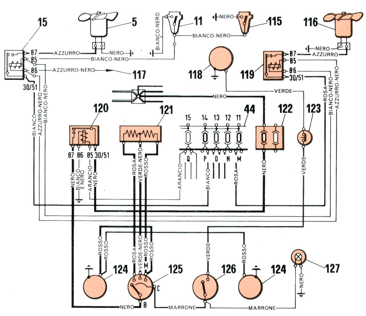

There was a factory A/C option but it was not very common. I've never seen a Fiat Dino with A/C. I've found a wiring diagram that might help you.
