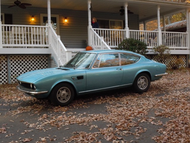

I recently purchased the 1971 Fiat Dino Coupe in the attached photo and I was wondering what the proper interior color and materials are?
The only website I could find with any Fiat Dino interior materials was < www.elvezio.com >.
My questions are...
1) What is the proper color for the interior? Are photos of the proper color on the forum website?
2) Can I purchase the proper material to make the carpets?
3) What material is the head liner?
Any experience anyone has with www.elvezio.com I would appreciate. I was planning on purchasing all the window and door seals from them. Does anyone else make the window seals or deal seals?
Best Regards
Fiat Dino Coupe Metallic Blue

Color on the intirior and carpet depend on the extrior color.There are 12 known extrior colors on the 2400 coupe and even more intirior combos.
Seems like the color on your car is the same used on the Dino 2000.If your car has higer chassinr than 4480 the colornr is stamped on the chassiplate.

seems you have the color nbr. 448 -"Azzuro Metallizzato".
Looking at your picture you seems to have a brown "Marrone" interior which seems to be the correct one.
Matching interior scheme you can find on this site: http://www.dinouk.com/technical_colours.html
NIce car and do not hesitate to send some more pics incl. the interior!
