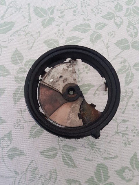

I know. Even the complete one i have is not really straight and good looking anymore.
I think it will be a bit (too) complicated to have it remanufactured exactly as it is original. The original one is made out of 3 parts and left and right are opposite of each other so you would need 6 moulds. I think the best way to do it is to make it look as original as possible from the outside and forget about the mechanism itself (i have it here with mechanism and i think it's really questionable if this system would have worked anyway)

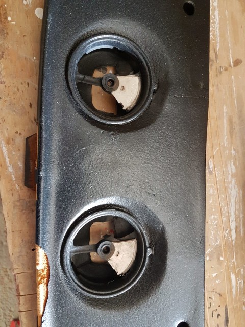

Please explain to me how this is supposed to function.
I do not see ventilation grids that can be opened and closed but just the rubber and a steel wire. Steel wire pushing against the rubber increasing force while turning the knob because of the angle of the vent-housing. I don't really see in what way this would adapt to anything like acceleration/deceleration or exhaust gasses.

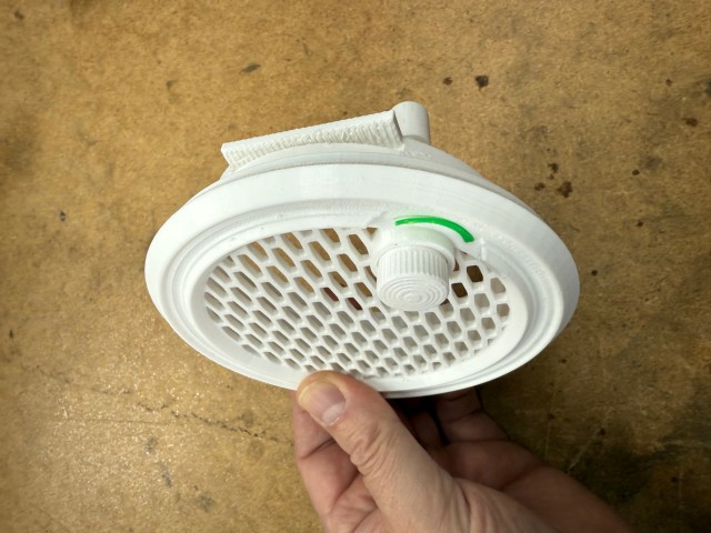

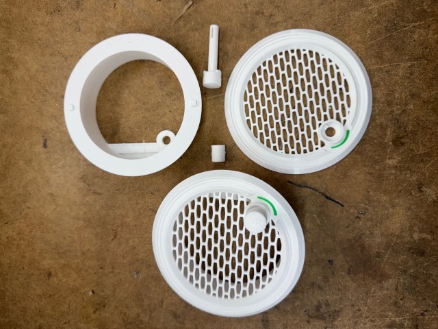

But i finished the model, making it the same as original with mounting position for the rubber membrane and steel wire going through the axle. Send it out to a 3d printing company so i'll might have it here withing two weeks or something. Than i can see if it's really a nice replacement or more something for the garbage can.
Also made a left and right version.

Looks good. Let me know what you hear back from the printing company.
Thanks.
