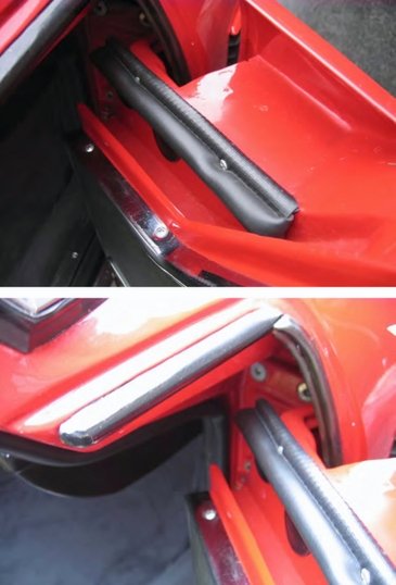

3. The rubbers around upper side of front doors are missing on my car, how did you fit it? Or how should it be? I don’t know, (screws, rivets? Or?) Where can I buy them?
I found this photo: Is this correct?

I can take pictures of my door rubbers if you like, I think I have those still fitted - I'd be interested in pictures of the trim on the sloping section of the door up above that too as I think I'm missing parts there.

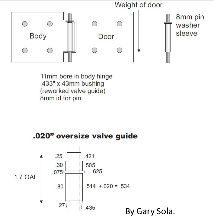

Door Hinge: The factory hinge uses a plastic bushing within the center sandwiched bracket attached to the body sill. The plastic falls apart resulting in a dropping door when open. You will need to replace the bushing, obviously, to restore a smooth, sag free swing. Dimensions required 11mm dia (.433") x 43mm long x 8mm bore. I used 4 'used' valve guides by machining down the OD and finished length. The ID is accurate and the yellow alloy is ideal for the application (and I thought it was a pretty cool thing to do). The stainless pin which connects the 2 parts of the hinge together will need to be pressed out. I machined the guide to be a friction fit, guessing .0005 undersize, but this is not critical. When reassembling the hinge use a washer between the upper claw and the restored center piece to accommodate the weight of the door. The original Bertone plastic bushing has a collar for this purpose. Realigning the door can be tedious, but you should be able to get it perfect. New stainless Allen cap screws are available (McMaster Carr # 92125A box 25) for the hinge - 32 required in all.

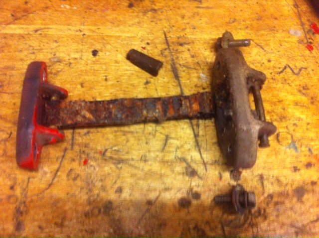

door retainer which lost his function:
door retainer mechanism
foto 1 (1).JPG (147.61 KiB) Viewed 12215 times

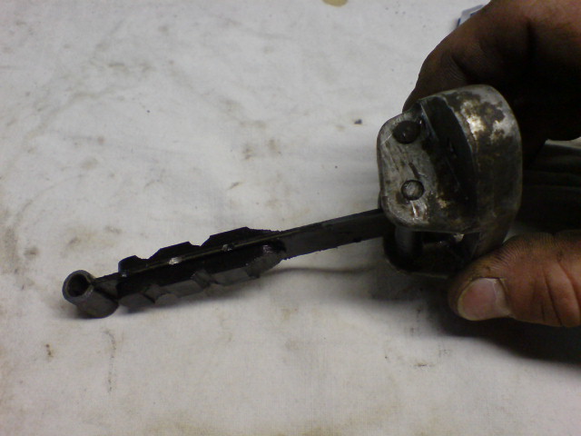

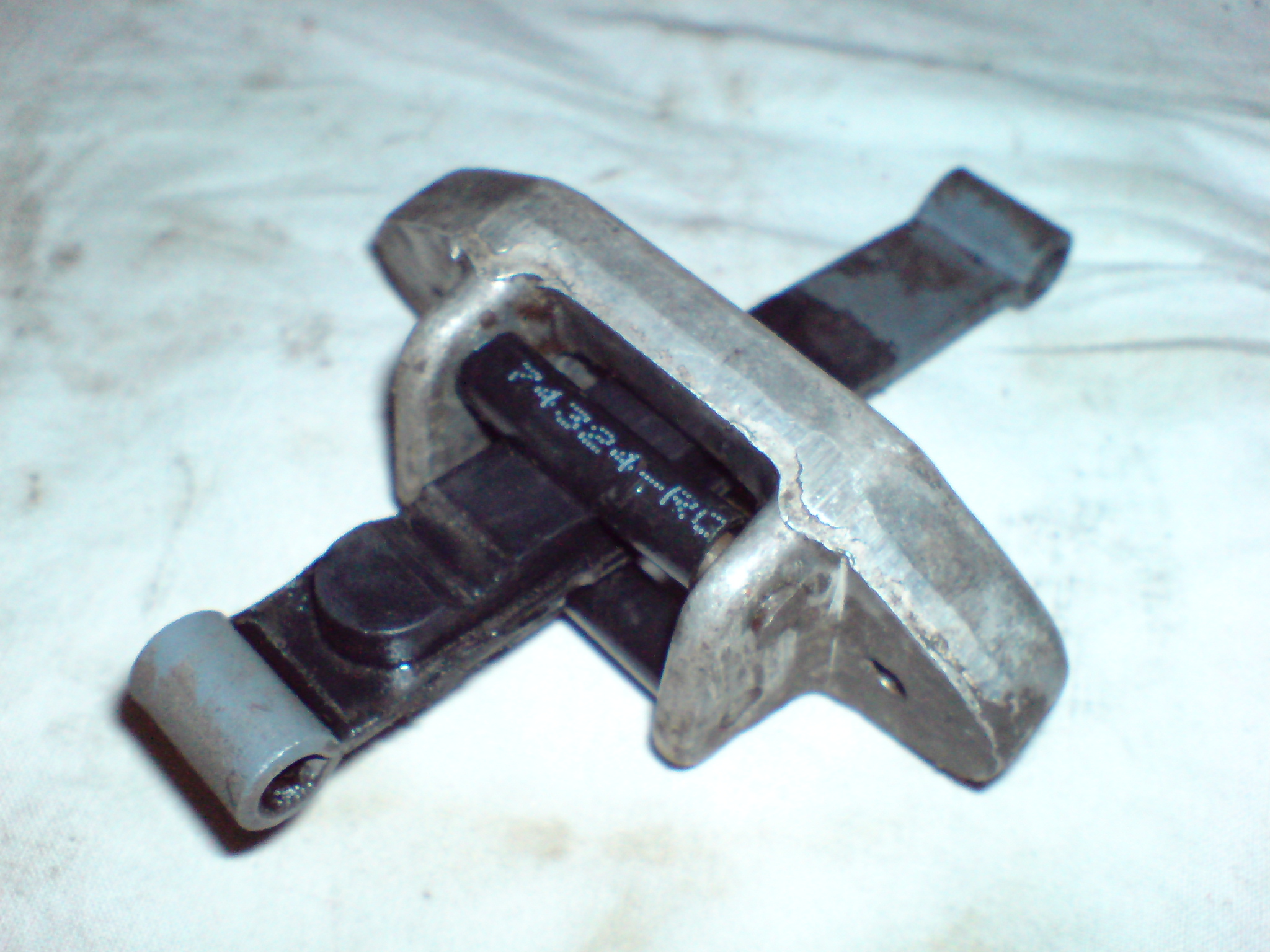

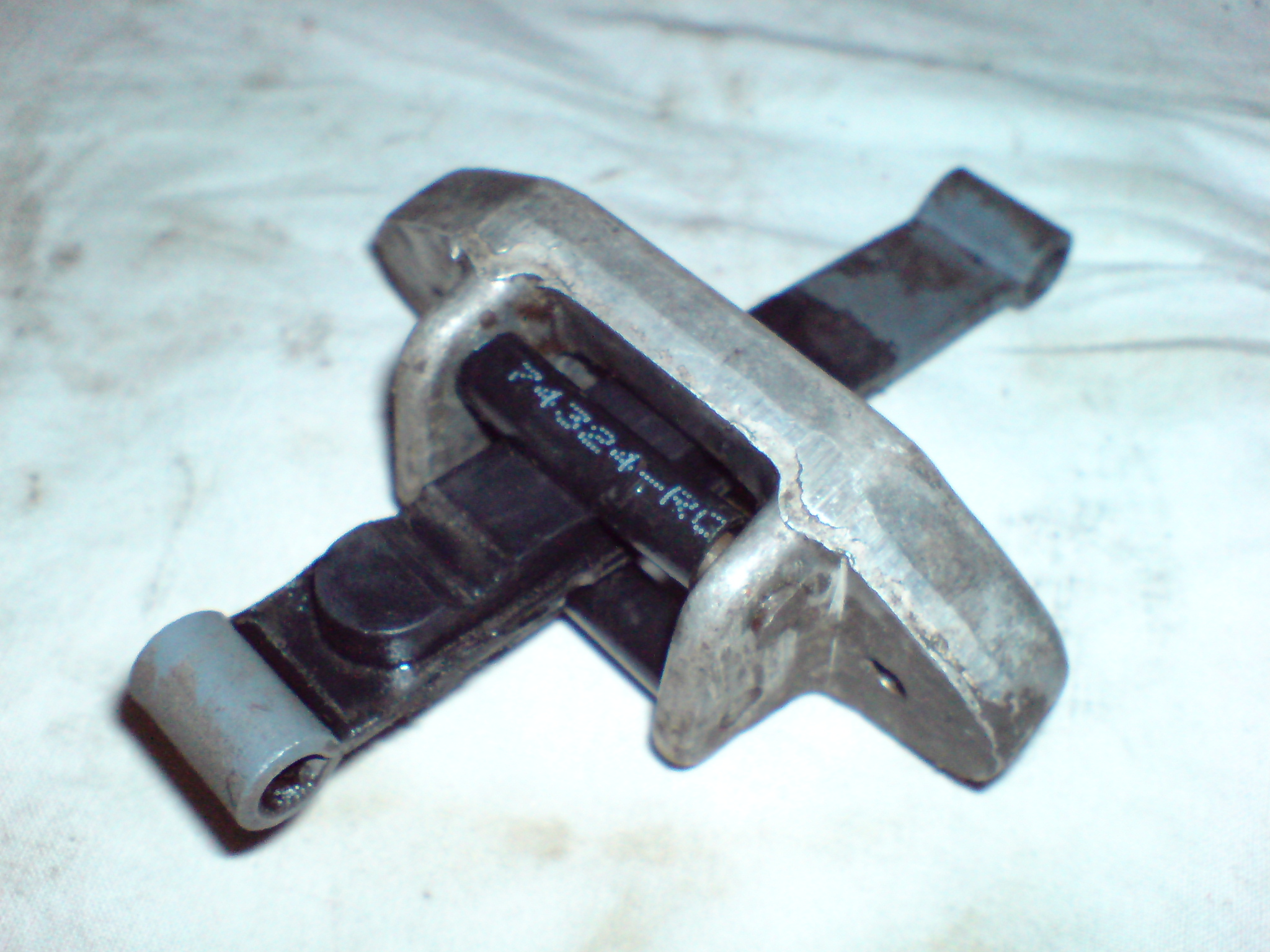

photos i found on yahoo forum how to improve it with some v belt glued on there and some grooves;
afterwards
afterwards
afterwards2
afterwards2
Here a photo Gary sent me on how to improve the hinges:
