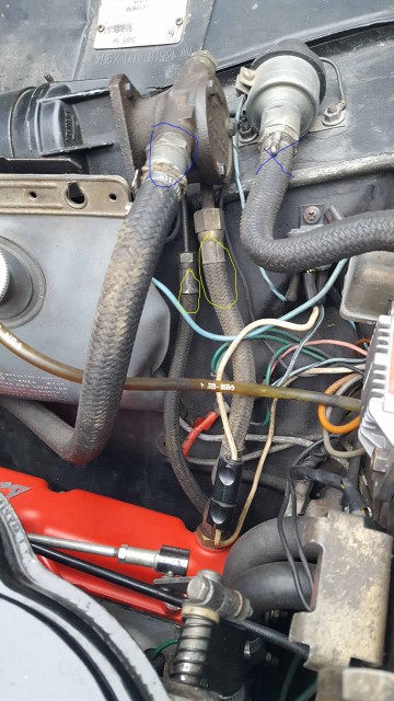

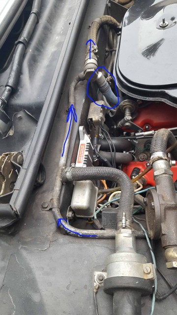

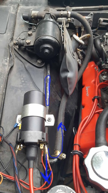

Hi, I've had a request for pictures of the vacuum system, so I shot some this morning when I took the car out to go to work :)
Here is a front pic of the system. I drew yellow circles on the oil lines (the small one is the oil delivery, the large one is the oil return line). A blue circle on the vacuum line to the system, a blue "X" on the line to the pump vacuum switch
On the next pic, you can see where the vacuum pump connects to a metal pipe through a T junction. The front connection goes to a large canister in the front bumper. The back connection goes to the brakes and vacuum switch

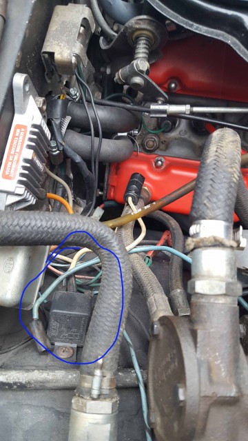

On another pic, I drew a circle around the relay and disconnected the wire from the vacuum switch for you to see. It's not the original relay (obviously) but I think it's the correct location judging from the length of the wires.
Lastly, you can see where the metal pipe goes along the back of the engine bay and separates into a vacuum take-off from the engine and a rubber hose to the park booster.
Sorry for not imbedding the photos, it's not working too well for me and they move all over the place... :roll:

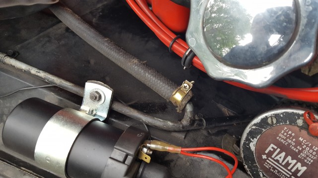

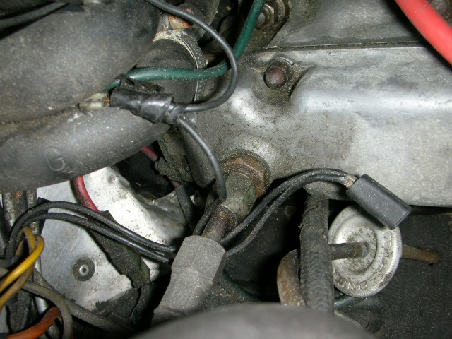

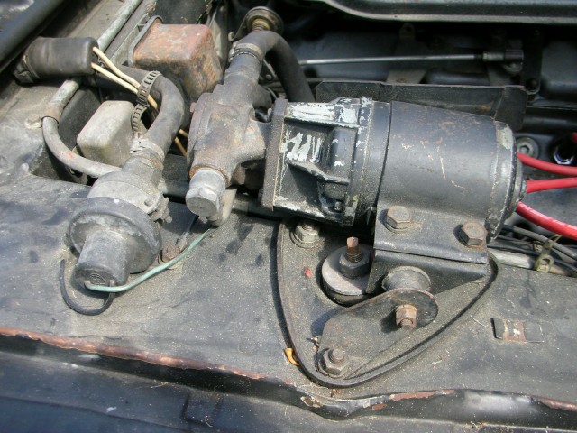

I attach some photo's from a friends Dino.In one you can see a round device with two wires.You don't have on your car it would appear.Is this the fuse you refer too? What purpose does it serve? As I have a Superformance modified 2.3 litre alloy block engine ,I presume I could add an oil tank to supply the Vacuum Pump for lubrication for the 2 smaller flow and return lines, rather than connect to the engine.Then add a powered relay to supply the Vacuum Switch and Vacuum Pump

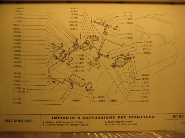

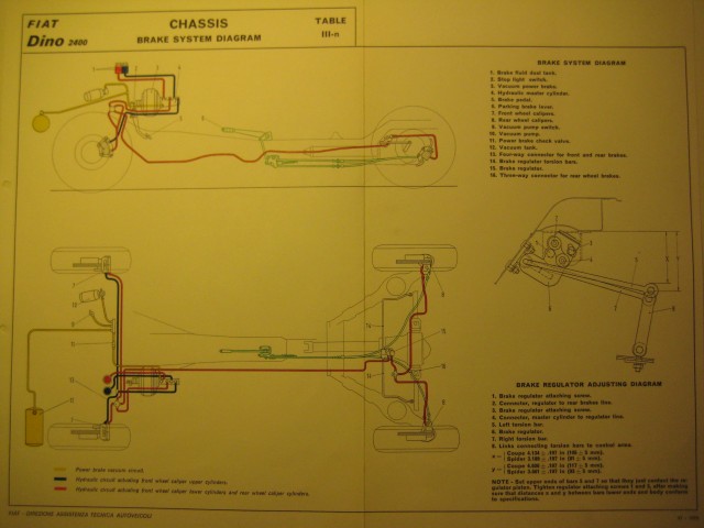

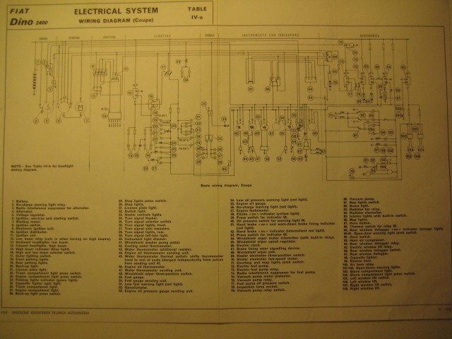

Here are some Fiat original workshop manual pages that might help you solving your servo pump issues. Note that the 2.4 litre
electric diagram really shows the pump, pressure switch and safety switch wiring.
As far as I can understand, there is no oil feed line to the vacuum pump...?

Dinoswede, There are oil pipe connections not shown on the schematic drawings. See the pictures sent by Dario and look for the 2 small pipes with the orange markings.

Maduno, you are absolutely right! When looking at page G1.03 there is no trace of any oil lines -
probably because they are shown at page A3.01 !!

Dinoswede, Thanks for adding the 2.4 spider page. I have only the Coupe schematic pages and the oil connections are not shown there.I have found the electrics on the other page you posted, now to see if I can make it work. The only problem I have is determining what item 75 on the elecs is.Vacuum Pump Protector??????? What is this? Is it a fuse seeing that the elec feed is direct from the battery. I am not familiar with the symbol.

Post by Dinoswede »
Maduno, if you search for an old post: "Electrical problem, fuse keeps blowing"
by "sveckan" 15 September 2014, you will find all about the safety switch no 75 !
Please note, when I refer to the safety switch as "no 73", I found that info in the
2,4 Spider Electric diagram. The 2,4 Coupe Electric diagram has a slightly different
numbering...
