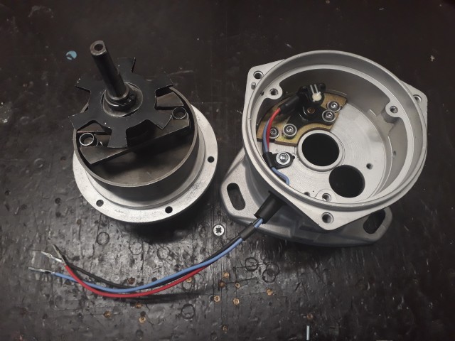

I traced a spare distributor and removed the whole mechanical advance system and locked it in place. After that I installed one of my chopper wheels, base plate and a OS50 optical sensor.

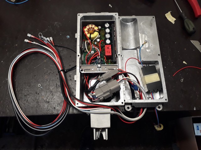

When that was finised I took one of my reproduction AEC101 dinoplex cases and milled it out internally to be able to get the MSD ignition in there. Both the dinoplex case as well as the MSD case needed quite some machining to make it fit but in the end I was able to get it in there. Adrian advised me to make a voltage regulator for the optical sensor so I made that and was able to get it into the case as well.

MSD in Dinoplex case
Distributor with locked shaft

Very nice Stefan. Since the MSD box now lives inside the Dinoplex box with no air flowing over it to cool it off, did you somehow couple the MSD box with conductive grease compound to the Dinoplex case such that the MSD can still dissipate its heat load?
What means did you use to lock up the advance mechanism?

I just made some bushes that slide over the pivot point where normally the weights are attached to. These bushes keep the 3-lobe cam in place.
I'm not worried about heat, in the MSD unit there is really not much attached to the case anyway, there are just some transistors bolted to the case, and they still are right now but that's it. The case is just there for protection of the electrical components i guess.

OK, I couldn't make out from the photo if the weights were still in there or not, thanks for the clarification. Looks like a simple thing to do. In light of this, Rob's (on Ferrarichat) development of a custom shaft with no weight tray for these distributors seems like a lot of work and expense for not much benefit...

I think the custom shaft is nice to have but i don't think it is 100% necessary. You want to be really sure that the whole shaft setup is without play, best way would be to go for a solid shaft but i think the way i locked it down right now is also perfectly fine.
