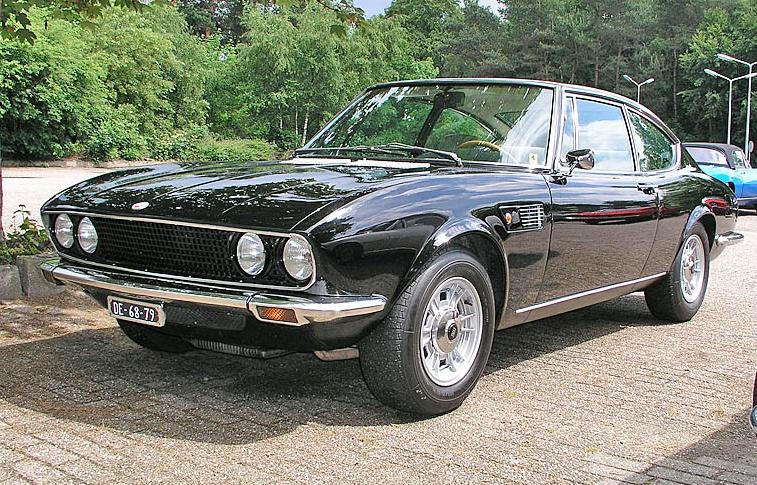

Can anyone help me identify the correct rocker trim for a 2400 Coupe. I have seen several different versions:
The Dino 2400 Spare Parts Manual shows a three piece trim similar to the 2000 but it wraps around the wheel arches.
Many photos show a single piece trim that wraps around the wheel arches.
Some photos show a single piece trim that stops short of the wheel arches, similar to the 2000 trim but a single piece instead of a three piece.
Is there any differences between Coupe and Spider trims?
I would really appreciate if anyone can send me photos or details on their trim, especially if they are original.
Cheers

The 2400 has a single piece trim. I've never seen the wrap around pieces on a car. I'm surprised to see this in the parts panual. I don't know if Coupe and Spider trims are identicl, but it is not likely.

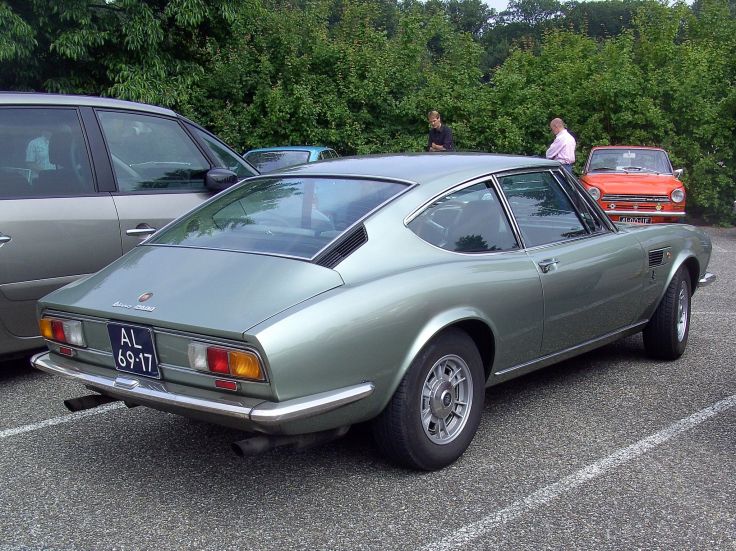

I have been looking for this part for a long time. At times, very original cars are fitted with it, but no parts dealer could ever deliver the trim, and no one I have ever asked could answer the question of whether the trim was fitted during the entire production life of the car. The drawing is not very accurate, the trim is quite short and also thinner than the main trim. Clearly and differently to the 2000 coupe, the main trim consists of one major piece only and clearly, the spider is a different story all together.

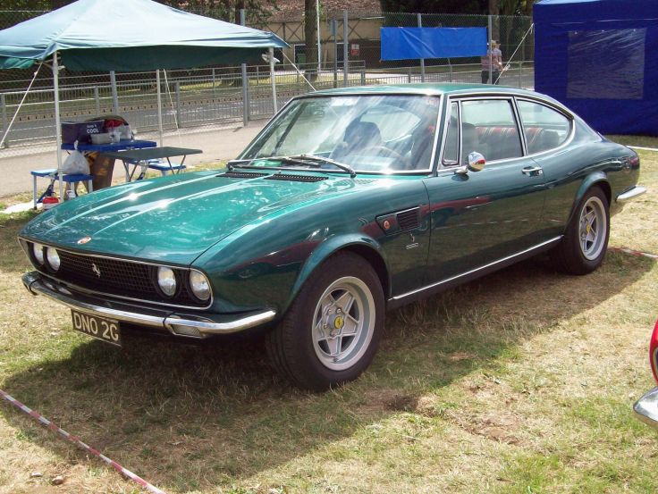

This small chrome item's you find only on the 2400 Coupe.They all had them when new.
Today most Dino 2400 coupe don't have them any more.But you always find them on original untouched cars.
Not possible,or very hard to find used.On my green car I had them rechromd.

Can you tell me if your trim is a single piece or does the part that wraps around the wheel arch detach from the main trim? I know someone who has two single piece trims without the wrap around part, they look exactly like the 2000 trim but are a single piece and not the three piece like the 2000. The two trims that he has are different lengths, one is 1520mm long and one is 1640 mm long. He thinks the 1520mm piece is off a 2400 Spider and the 1640mm is off a 2400 Coupe.
If the 2400 Coupe trim has the wrap around part then the two different lengths don't make sense.

The lenght of the trim is 174 cm.
Since we are on the topic original,here is a photo of how thing was when The 2400 Coupe left the factory.Alu wheels black and gray, hubcap chrome and black, black paint under rocker trim and the small black plastik trim between bumper and carosserie.For them who like to stick to original.
