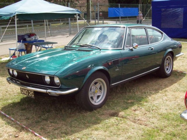

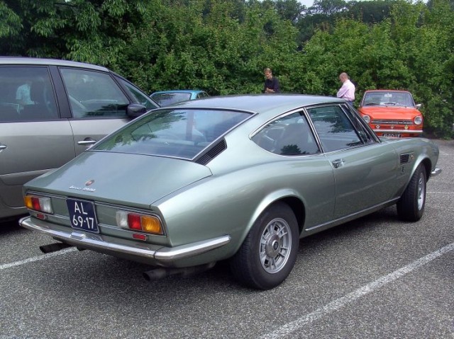

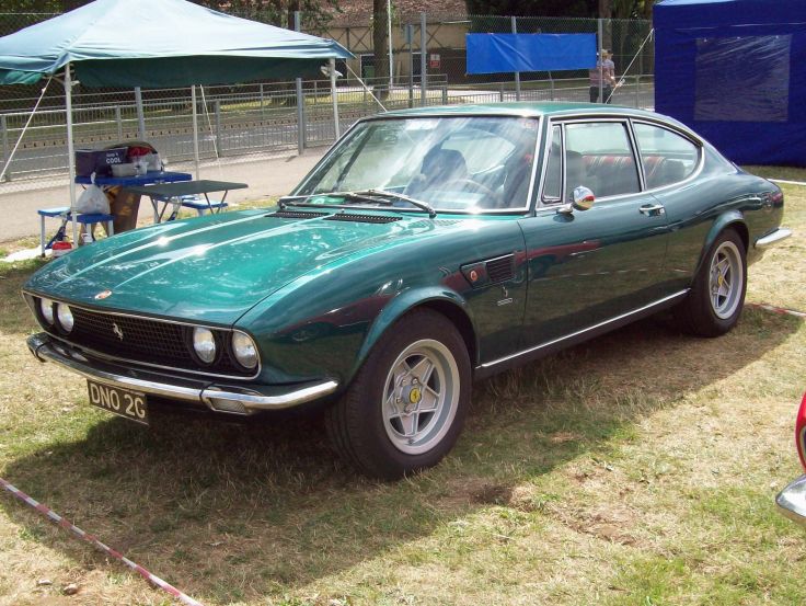

single piece wrap around trim
Single piece trim
Single piece trim
Single piece trim
Single piece trim

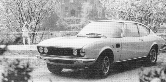

Looks like an original photo with a single piece wrap around trim

The 2400 Coupe didn't even have these trims in the brochure. Maybe they've been intended but never installed. Or they were supposed to fall off immediately, even before taking the car to the studio for taking the brochure pictures.
