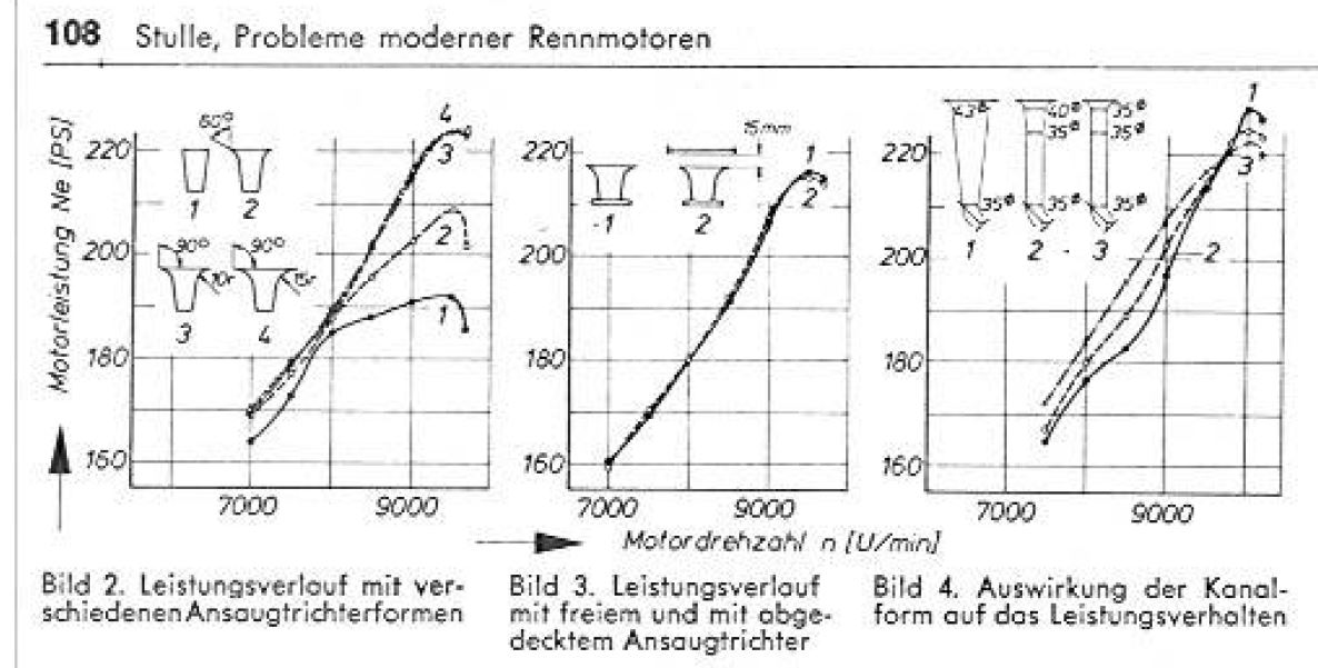

HugoHarris wrote: Tue Feb 15, 2022 10:31 pm Wow, nice work! What power advantage did you achieve?
The final benefit was 5 kW (measured)

Ribolla_67 wrote: Wed Feb 16, 2022 9:53 am The final benefit was 5 kW (measured)
Really impressive to have approached this scientifically. Were you able to measure airflow?

No, we did not measure the airflow directly - but the benefit of velocity stacks and cooler air intake temperature is evident for decades now and can be easily calculated.
Measured impact of air intake shape on engine power
RET_Bellmouth_Sept.pdf
CFD simulation of airflow
(1.68 MiB) Downloaded 565 times
