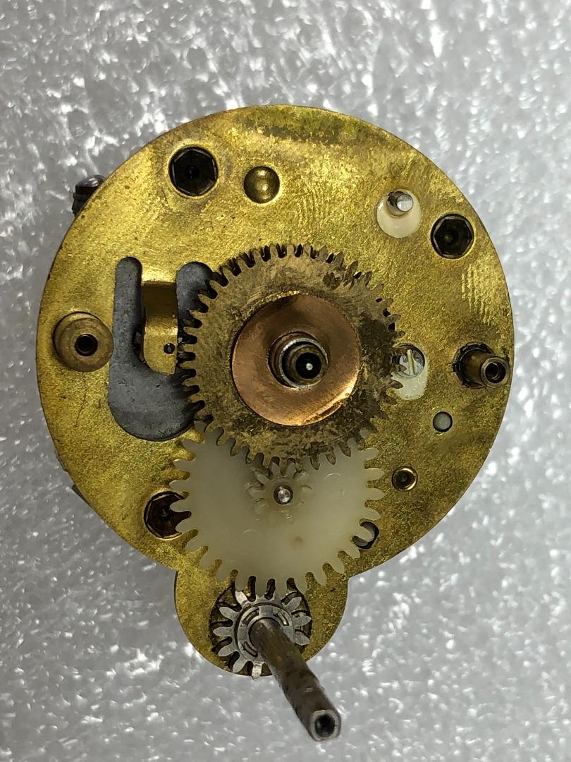

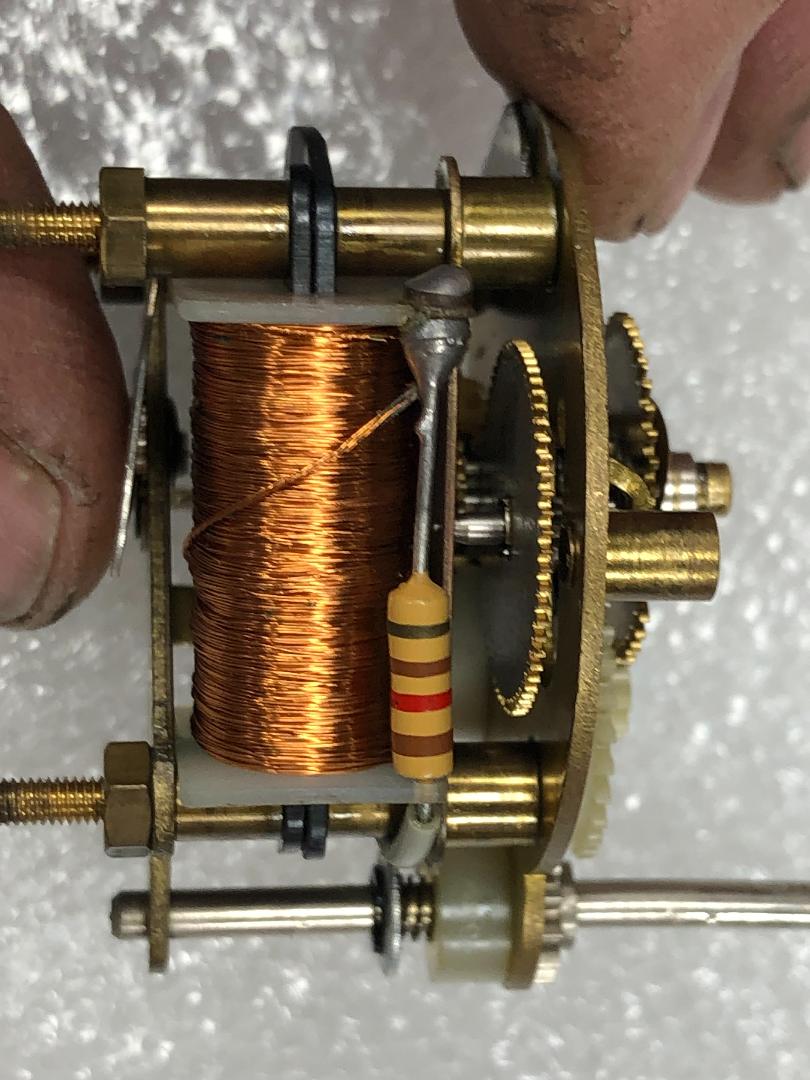

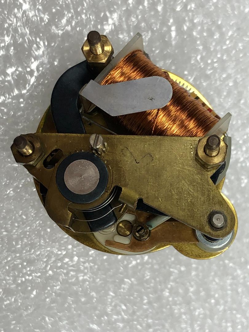

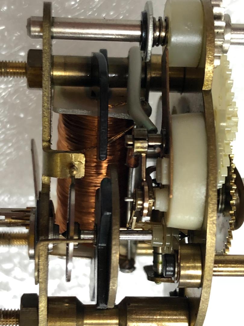

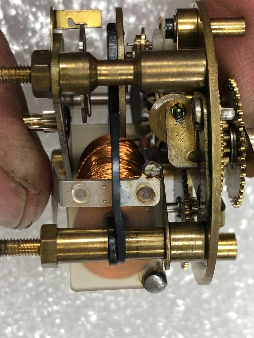

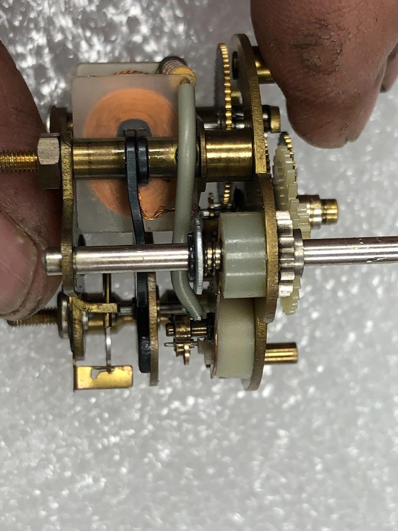

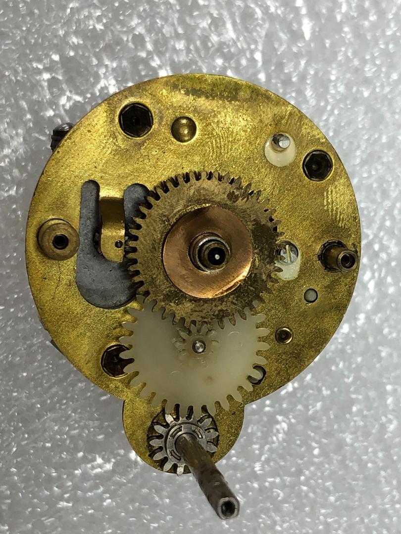

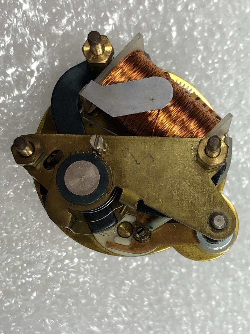

Here are some photos of the inside of the clock.
I don't see any transistors or capacitors, just the one resistor and the electromagnet.
Everything else looks mechanical.
Ben.
