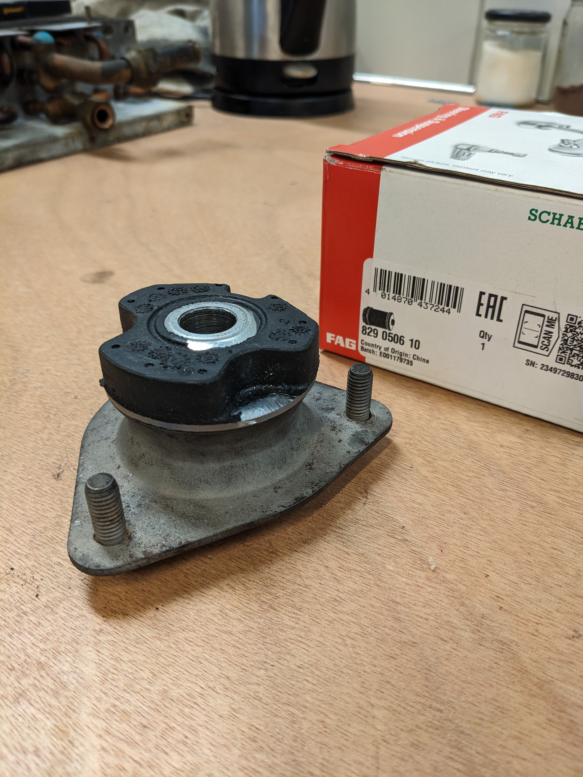

I did not know about the existence of these replacement parts in the first way, but i have a Fiat 130 with the same rear axle.
Because tracing parts for a Fiat 130 is waste of time, i tried to find a solution for these parts by using some random bushing from another cars rear axle. I just made it some 2 weeks ago so i did not had the time yet to install them.
I traces a bushing that is exactly the correct diameter, it only needs to me shortened by some 20mm. But i have a lathe so for me that was quite easy.
I haven't tested it yet, so i don't know yet if it will work as good as expected.
Might be an option for you as well...? Part number of the bushing is on the picture.

Hi Stefan,
that is a good idea and the rubber may be softer than on the repro part, thanks a lot for the suggestion.
I spoke to the dealer today and they assured me they sold a lot of these parts already and
never heard of any problems with drive train vibration/noise. I may be naive but I think
I will give the repro parts a try... Lets see if I am still happy when I drive the Dino again this summer ;)
If not, I will maybe try your solution.
