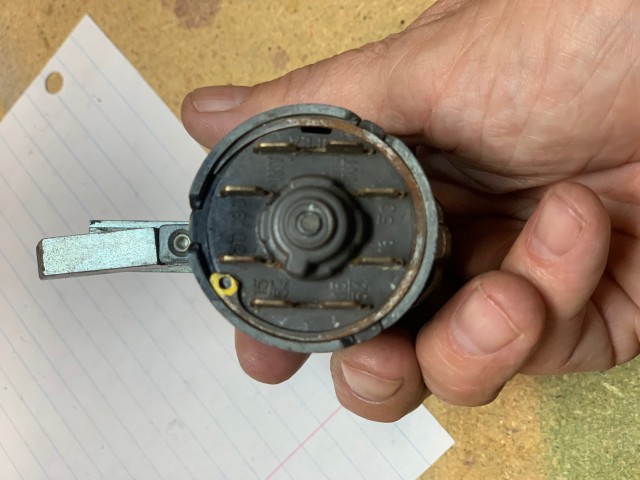

I'm looking for the retaining ring that holds the ignition switch internals into the housing. The snap ring that I found on mine (as shown in the picture) is damaged/modified on one end and does not hold the switch together securely. Anybody have this piece laying around they'd like to get rid of? I'm assuming that it's a snap ring... this is how mine is, but may/may not be original. Any help appreciated. Thanks. Photo attached.
Snap ring, one end is yellow in the picture

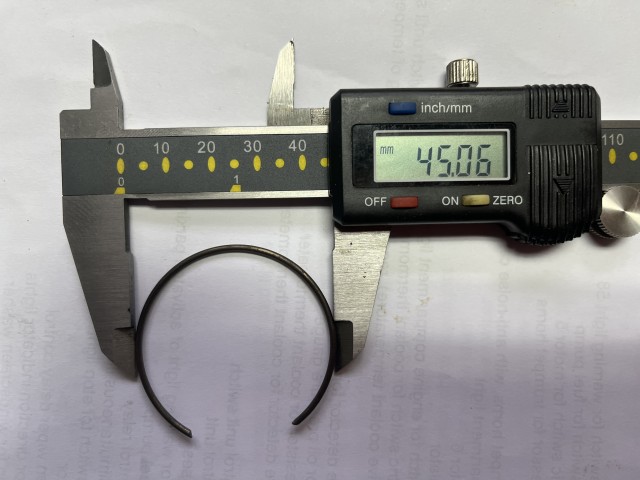

Re: Looking for ignition switch retaining ring
I just threw out an ignition switch that I had to drill out.( previous owner lost keys)
I kept the switch part and the wire circlip.
I’ll send a pic in the morning.
If you don’t get one in the near term, I’ll mail you the clip. You just pay postage from Portugal, probably €3
Posts: 275
Here’s what you are looking for
The gap in the spring is 23mm
Diameter of the wire is 1.48mm
Hope this helps
Posts: 275
FYI
I don’t know if you know this, but the switch you have is probably the Russian made switch for the Lada.
The original switches are made by Sipea, they show up for sale now and again, they were also used on the 124’s and 130’s. But some of them don’t have a long enough steering lock for the Dino. You can tell the difference on the electrical portion, on the Sipea ignition, the the terminal at radial around the switch, except for the two blades for #30 I thinkApart from that you can’t tell the difference.
