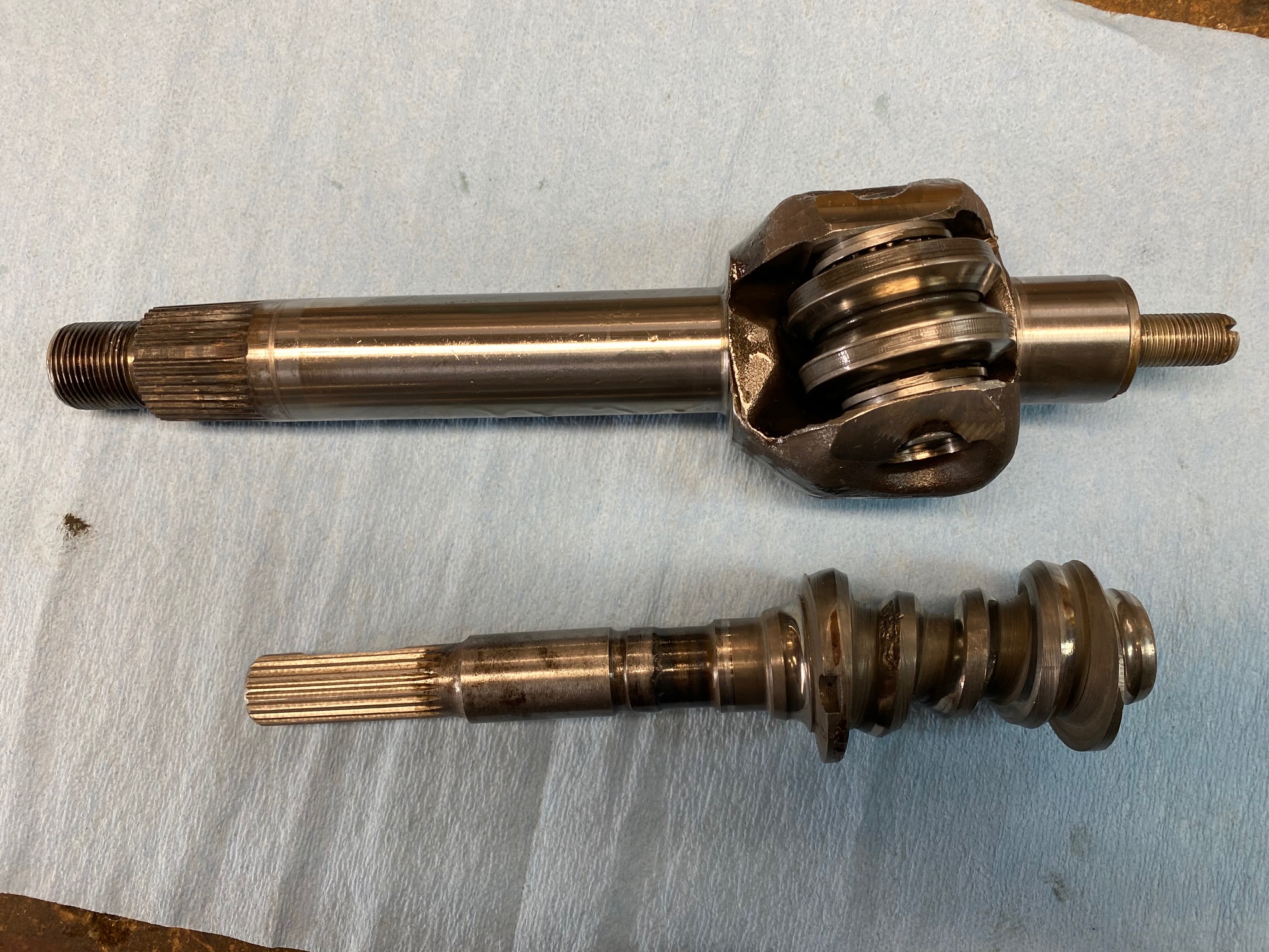

Some notes on my recent experience of trying to rebuild the steering box on my 1971 2400 Coupe.
I did finally remove the Pitman Arm - The solution was as Georg suggested: Soak with penetrant while heating with Oxy-acetylene while fixed in a press while hitting with large hammer. It came apart with an 'explosion' (I wasn't actually there at the crucial moment) and broke part of the press, but the steering box survived.

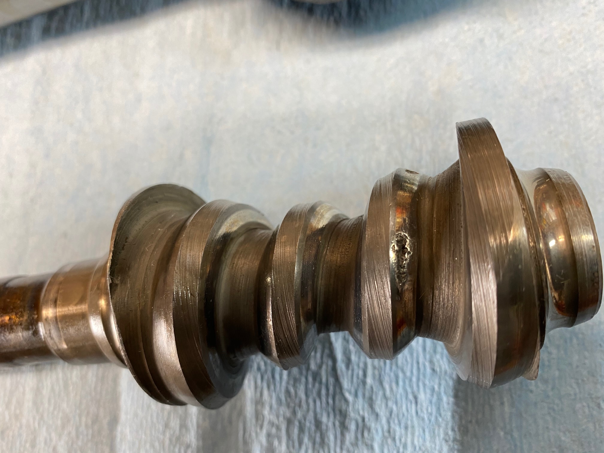

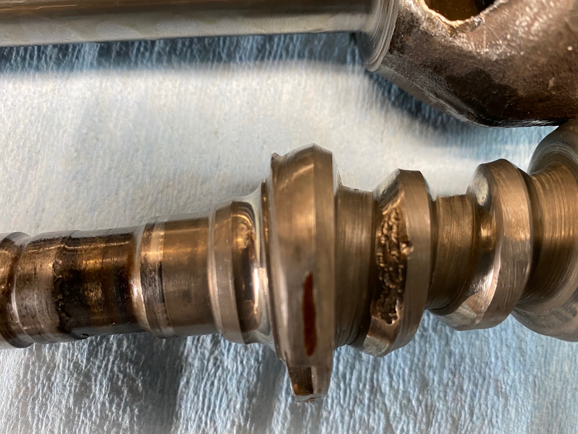

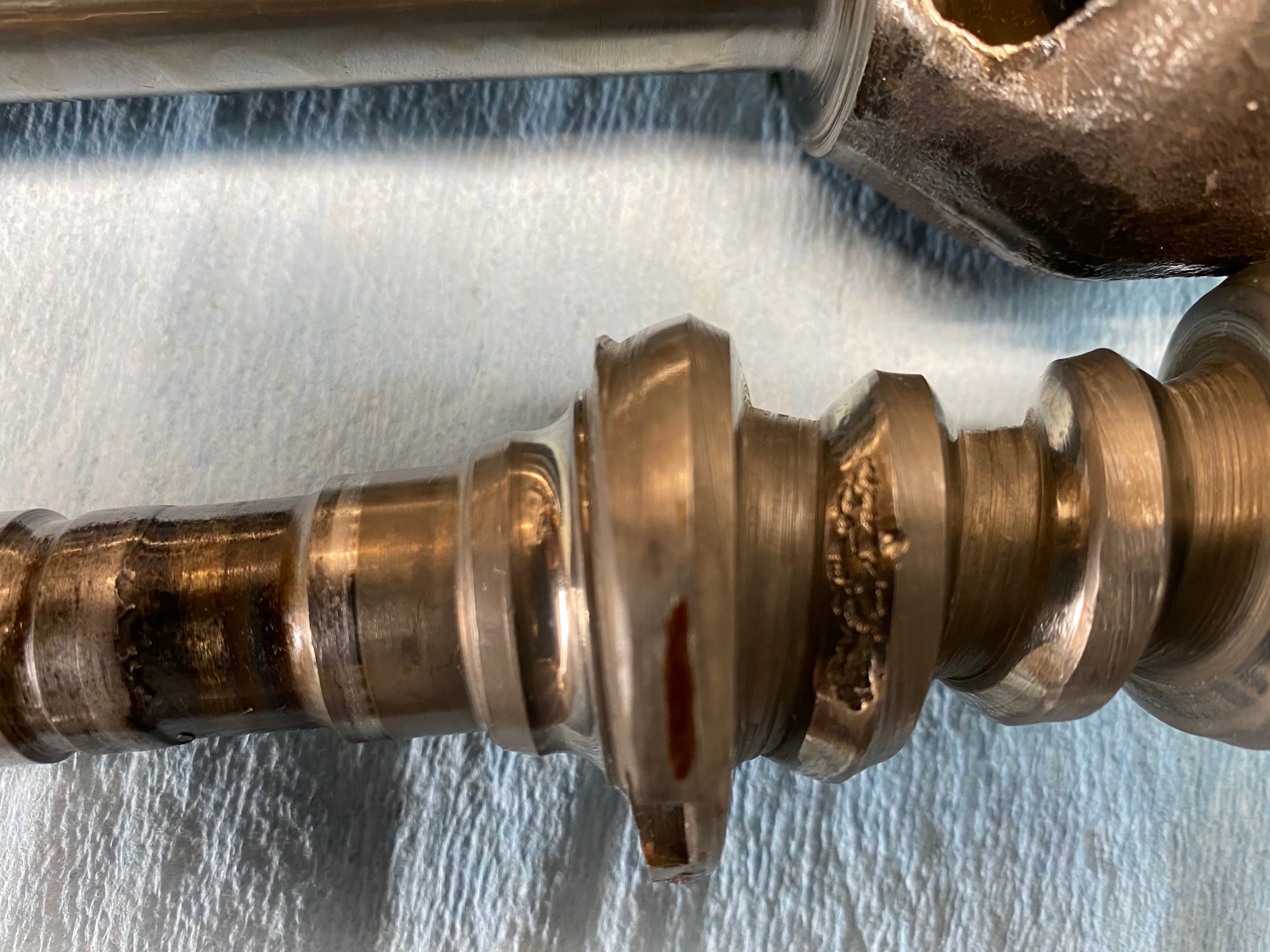

Inside, however, the news was not so good - some pictures of the worm/roller attached here.

It was clear from adjusting the box on the bench (note: virtually impossible while mounted in the Coupe chassis because of inaccessibility of the adjuster) that there was an improvement to be made from slackening the adjustment (I have no idea why it 'tightened up' by itself..) - however, also obvious from the pictures above that the real problem is a worn (pitted? corroded?) worm.

Net result - it's better than before, say a 30% improvement from a 70% degradation over years. Still some "notchiness" at right of center, but improved. I need a new worm for sure (roller is in perfect visual condition) and replacement of all other bearings/races. But the worm-pitting is the main issue.
