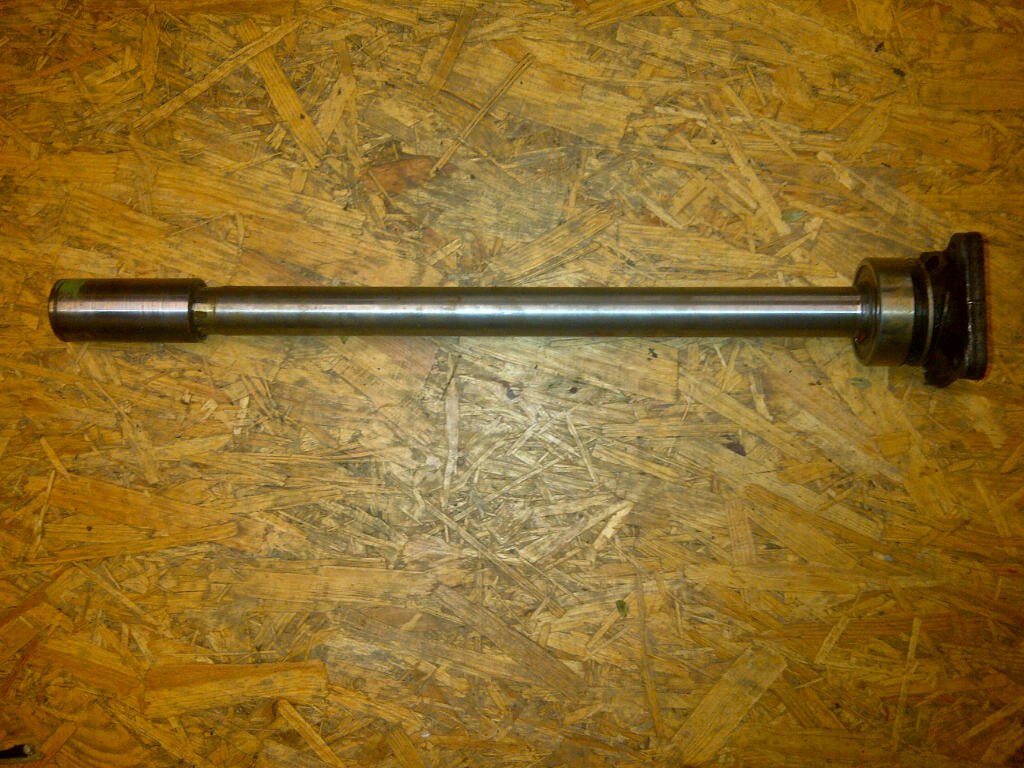

Posts: 232
Re: Fiat Dino 2400 Coupe - drivetrain vibration
I thought it may be helpful to have in adition to the drawings a photo of the driveshaft inside the torque tube. There are no balance plates on it, I also think, that this section cannot and is not made for beeing balanced.
doublegarage
Posts: 215
Location: California, USA
Post by doublegarage »
Thanks Thomas.
Yes that's the part, and the more I think about it, the crazier it seems that there is a balance weight welded on. If I remember it looked like a normal curved balancing "washer" that you would see welded to the outside of a tubular driveshaft - but not welded to a small shaft like this.
So I think I'll try the following:
1) reverse the coupling that's in front of this section (i.e. rotate two driveshaft halves 180degrees from where it is today - if that doesn't work...
2) dismantle (again) this part of the drive shaft and remove this added weight. then...
3) really don't know - I will be clean out of ideas.
